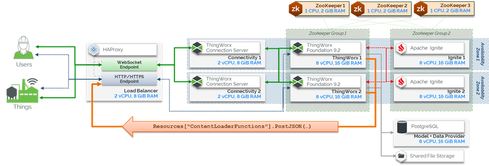

For purposes of this demonstration, a two-node ThingWorx cluster was used, similar to the deployment diagram below:

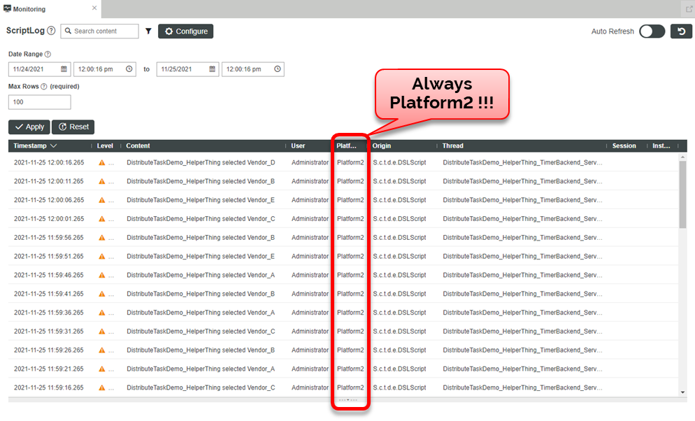

Imagine this simple scenario: You have a list of vendors, and you need to process some logic for one of them at random every few seconds.

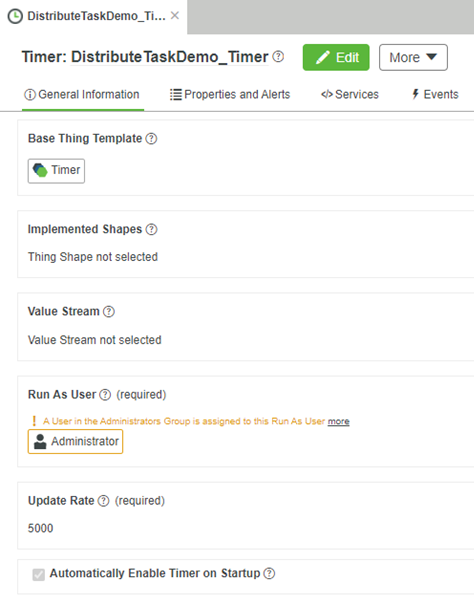

First, we will create a timer in ThingWorx to trigger an event – in this example, every 5 seconds.

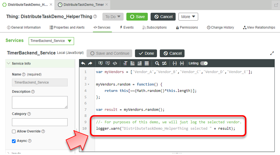

Next, we will create a helper utility that has a task that will randomly select one of the vendors and process some logic for it – in this case, we will simply log the selected vendor in the ThingWorx ScriptLog.

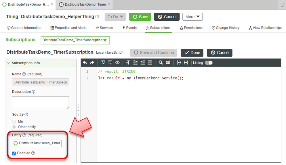

Finally, we will subscribe to the timer event, and call the helper utility:
Now with that code in place, let's check where these services are being executed in the ScriptLog.
Look at the PlatformID column in the log… notice that that the Timer and the helper utility are always running on the same node – in this case Platform2, which is the current singleton node in the cluster.
As the complexity of your helper utility increases, you can imagine how workload will become unbalanced, with the singleton node handling the bulk of this timer-driven workload in addition to the other workloads being spread across the cluster.

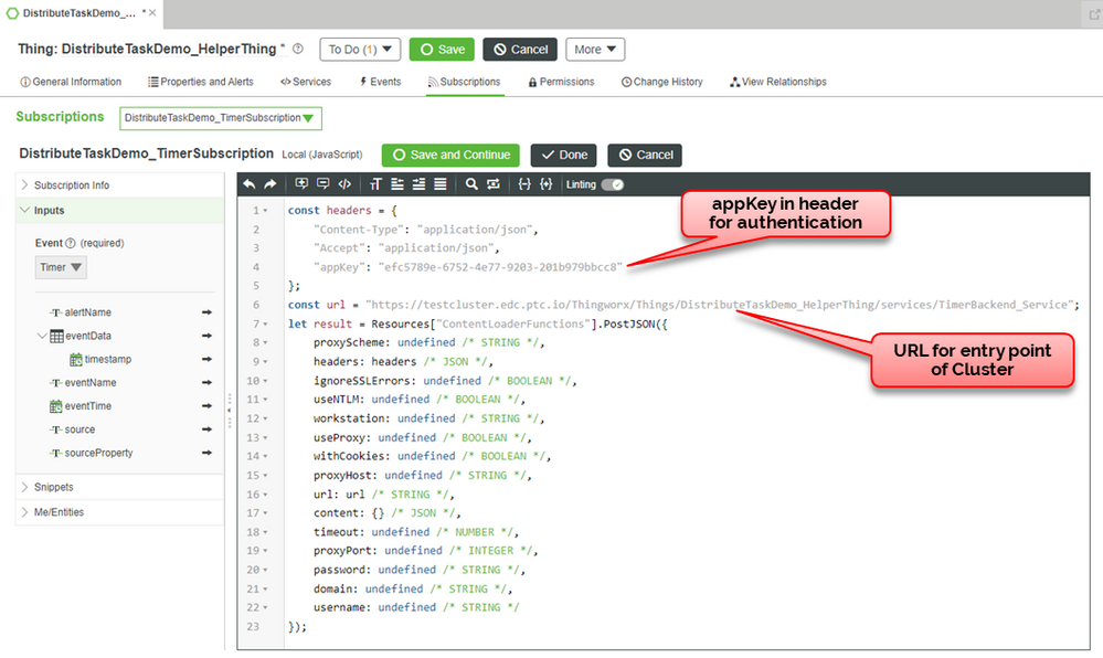

This time let’s update our subscription code – using the PostJSON service from the ContentLoader entity to send the service requests to the cluster entry point instead of running them locally.
const headers = {
 "Content-Type": "application/json",
 "Accept": "application/json",
 "appKey": "INSERT-YOUR-APPKEY-HERE"
const url = "https://testcluster.edc.ptc.io/Thingworx/Things/DistributeTaskDemo_HelperThing/services/TimerBackend_Service";
let result = Resources["ContentLoaderFunctions"].PostJSON({
 proxyScheme: undefined /* STRING */,
 headers: headers /* JSON */,
 ignoreSSLErrors: undefined /* BOOLEAN */,
 useNTLM: undefined /* BOOLEAN */,
 workstation: undefined /* STRING */,
 useProxy: undefined /* BOOLEAN */,
 withCookies: undefined /* BOOLEAN */,
 proxyHost: undefined /* STRING */,
 url: url /* STRING */,
 content: {} /* JSON */,
 timeout: undefined /* NUMBER */,
 proxyPort: undefined /* INTEGER */,
 password: undefined /* STRING */,
 domain: undefined /* STRING */,
 username: undefined /* STRING */
Note that the URL used in this example - https://testcluster.edc.ptc.io/Thingworx - is the entry point of the ThingWorx cluster.  Replace this value to match with your cluster’s entry point if you want to duplicate this in your own cluster.

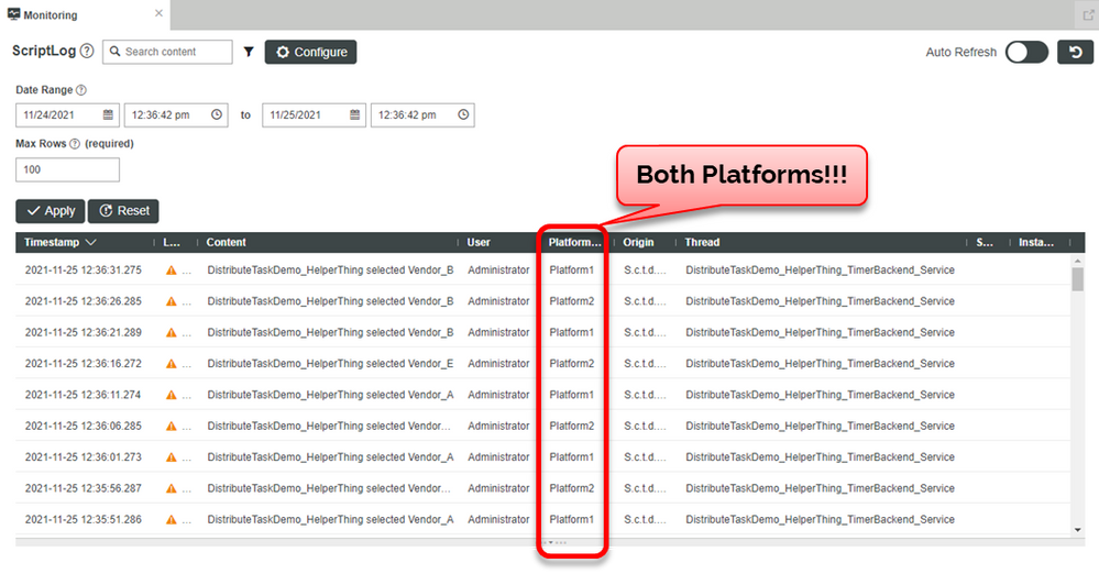

Now, let's check the result again.
Notice that the helper utility TimerBackend_Service is now running on both cluster nodes, Platform1 and Platform2.

The timer or scheduler itself is still being executed on the singleton node, but now instead of the triggering the helper utility locally, the PostJSON service call from the subscription is being routed back to the cluster entry point – the load balancer.  As a result, the request is routed (usually round-robin) to any available cluster nodes that are behind the load balancer and reporting as healthy.

Authentication: As illustrated in the demo, make sure to use an Application Key with an appropriate user assigned in the header. You could alternatively use username/password or a token to authenticate the request, but this could be less ideal from a security perspective.
