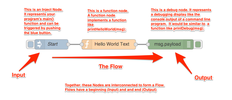

This is the problem that Node Red really solves. Node Red is a web based Integrated Development Environment (IDE) that turns the "Call Back" style Javascript programming of Node.js into a series of interconnected Nodes, each Node of which represents a Javascript function which is connected by a callback to another node/function. A simple hello world program in Node Red would look something like this ( with annotations in red) :
You can re-create this program using the Node Red IDE yourself. Here is a brief video (with no sound) which should familiarize you with how to create your own hello world flow.

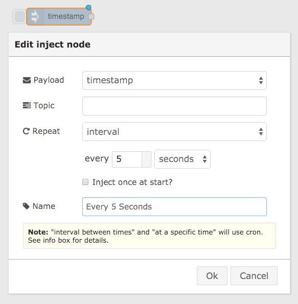

Polling versus Interrupt Driven Data Collection

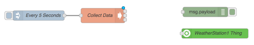

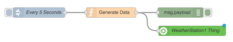

In the Java SDK version of this example, we are polling for changes in data. Every so many seconds our device will wake up and take a reading. How do we recreate the same effect in Node Red without having to push an inject button every 5 seconds. No. We need an input node that activates on its own every 5 seconds. The Inject Node will do this. Drag out an inject node and configure it as shown below.
This is an input node so it will be starting a new flow. It will fire off every 5 seconds from the minute this sheet is deployed.

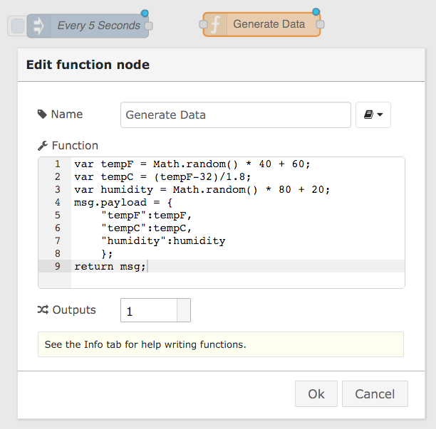

Lets generate a random humidity and temperature value before getting the actual data. For this node we will use a Function node. Drag one out and configure it as shown below.
Here is the Javascript for this node so you can cut and paste it into this dialog.
var tempF = Math.random() * 40 + 60;
var tempC = (tempF-32)/1.8;
var humidity = Math.random() * 80 + 20;
msg.payload = {
    "tempF":tempF,
    "tempC":tempC,
    "humidity":humidity
return msg;
Remember that the returned message is the message that the next node will receive. The payload property is the standard or default property of a message that most nodes use to pass data between each other. Here, our payload is an object with all of our simulated data in it.

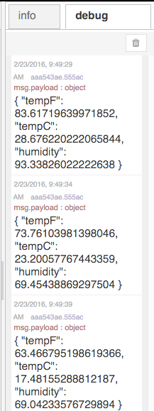

Lets Test it Out
Connect the two nodes together and add a debug output node and deploy your sheet. The completed flow will look like this.
As soon as you deploy you should see the following output in your debug tab and every five seconds another data sample will be generated.

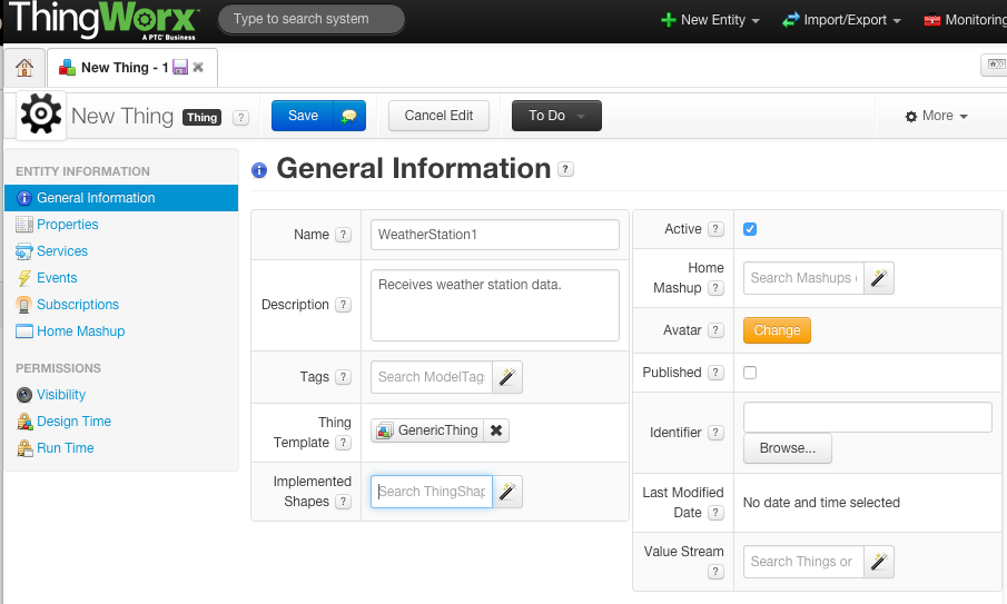

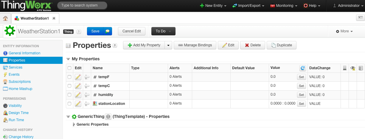

What we need to do is take this data and deliver it to ThingWorx in the form of a REST web service call. This is easier to do than it sounds. First off, lets create a Thing on your ThingWorx server that looks like this.
Now give it these properties.

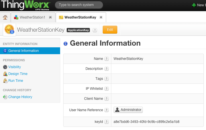

Next, create an Application Key in the application keys section of the composer. Assign it to the "Administrator" user.
Your keyId will of course be different. This key will be the credential you need to post your data.

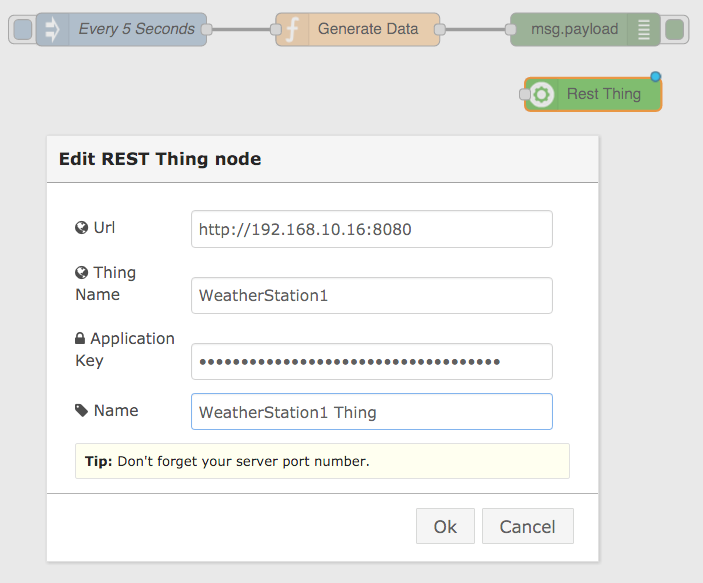

Adding a REST Thing node to your flow
Drag a REST Thing output node into your flow and configure it as shown below. Remember, your Application Key will be different than the one shown here. Also, your ThingWorx server URL may be different if your server is not on the same machine you are working on.

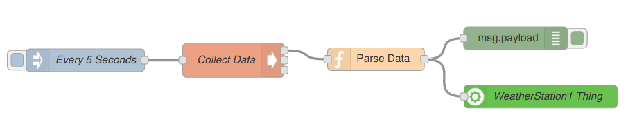

Now connect it as shown below. When you deploy this sheet, you will be posting data to ThingWorx.

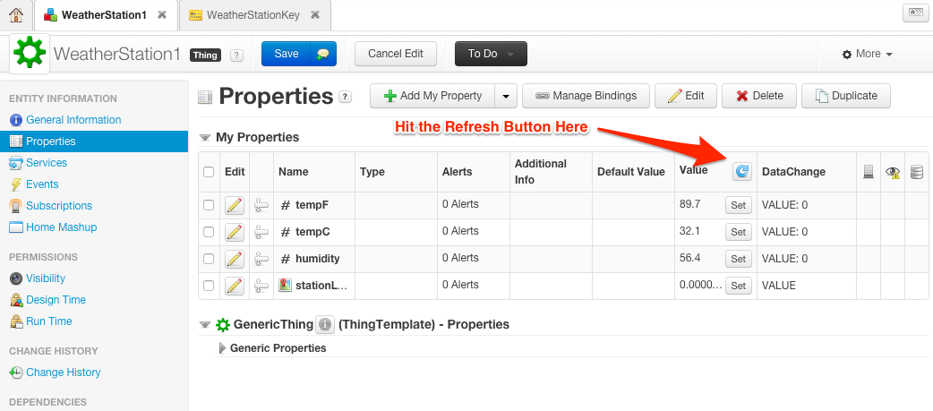

Go back to your WeatherStation1 Thing in ThingWorx and use the Refresh button shown below to see your data changing.
Wait, that is? Thats the whole data collection program? Yes. The flow above is the equivalent of the Java SDK code from the Java weather station example.

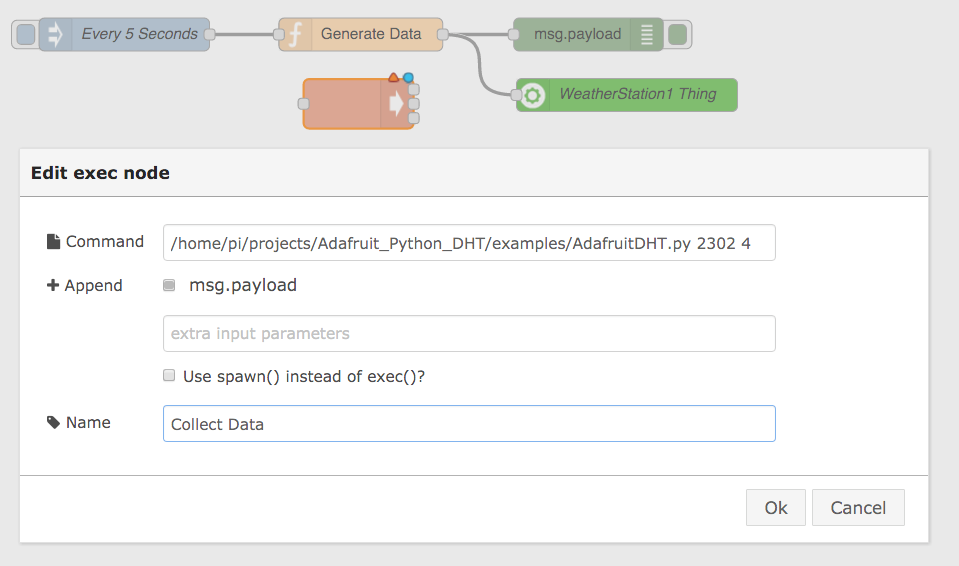

Now for Some Real Data
As promised, we will now replace the simulated data in the Generate Data node with real data obtained from the "~/projects/Adafruit_Python_DHT/examples/AdafruitDHT.py 2302 4" python command on your Raspberry PI using an Exec node. The exec node can be found at the very bottom of your node palette. It executes a command and returns the results as msg.payload to the next node in the flow. You may have noticed it has three outputs instead of one. In order these outputs are your Standard output, Standard Error and the integer return code of the process. Use the first output node to get the results of this command.
Now Connect this in place of the Generate Data Node as shown below.

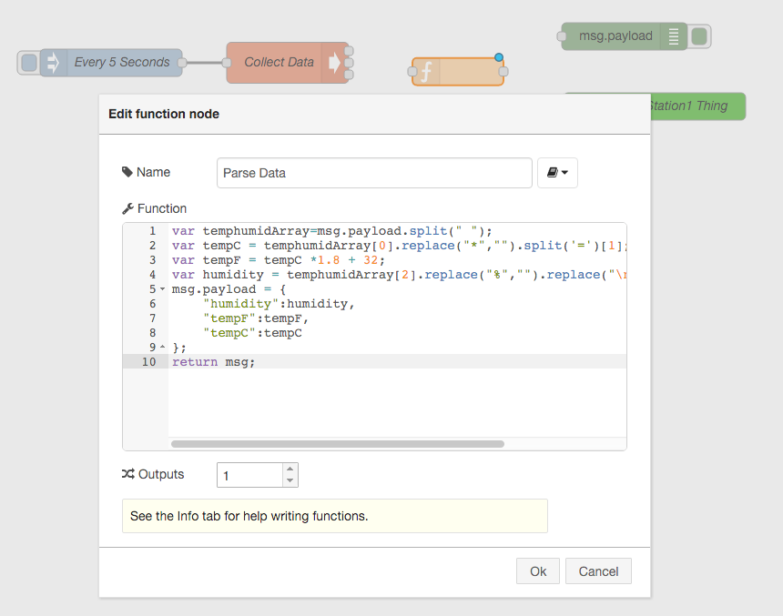

At this point, we can't connect the collected data to the WeatherStation1 Thing because it is in the wrong format. It is console output and we need it in the form of a Javascript object. We are going to need a function to parse the console output into a Javascript object. Add the function node shown below.
Here is the Javascript for cut and paste convenience.
var temphumidArray=msg.payload.split(" ");
var tempC = parseFloat(temphumidArray[0].replace("*","").split('=')[1]);
var tempF = tempC *1.8 + 32;
var humidity = parseFloat(temphumidArray[2].replace("%","").replace("\n","").split('=')[1]);
msg.payload = {
    "humidity":humidity,
    "tempF":tempF,
    "tempC":tempC
return msg;
Now msg.payload contains a javascript object identical to the one we were generating at random but now it is using real data. Connect up your nodes so they appear as shown below but when you deploy, don't expect it to work yet because there is still one problem you will have to get around. This python script expects to be run as the root user.
