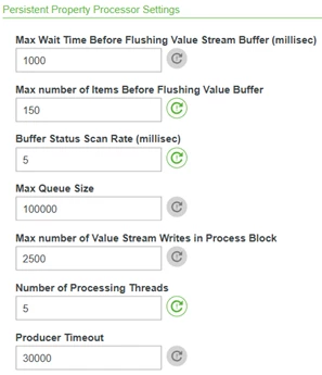

Within ThingWorx, go to the system object and edit it (may require admin permissions). Modify the Configuration to reduce the overall number of threads, which in turn reduces the distribution of the Event Hub load, allowing each to be processed more quickly. Also lower the buffer scan rate for persistent properties so they flush more often.
Especially lower the max number of items before flushing, the buffer that usually delays writes to the database so as not to overwhelm it. That is less of a factor here as Event Hub has an internal load balancer. Event Hub is better for throughput than a database would be, and these are the settings to put on all opt-in queues for optimal performance.

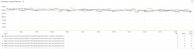

It is better to use more partitions than less, and a higher number of partitions will result in less latency and lower mean lag. There is always some lag, however, as it is calculated from the number of items queued versus completed. Both of these queues are very active, and healthy lag is usually between 60 – 80% of the total property wps, with peaks that do not increase over time. Sometimes the lag can be spikey, which must be considered in the alerting infrastructure.

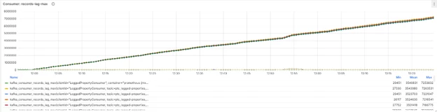

If more partitions are added while the lag is falling behind, then instead of helping to catch up, they significantly delay the recovery. Anything currently in Event Hub will not be distributed across the new partitions, only new things that are added later, but all of the partitions will still be polled for data, including the new ones, which will slow things down even more.
The right way to deal with runaway lag is to increase the TUs or PUs to a decently higher setting temporarily, let the lag catch up, and then increase the number of partitions, and then wait and see how the server responds before finally downsizing once again. It is important to consider that there is a maximum size for processing data, and a maximum number of partitions per Event Hub, creating a hard upper limit for performance and scale.
Make sure any Event Hub instance is sized small enough to allow for upsize in the case of runaway lag. Edge load is not guaranteed to remain perfectly steady, generally speaking, there can be surprise disconnections, reconnections, and spikes in utilization. There really is no other way to ensure no data loss occurs to runaway lag, especially since there usually is no way to turn off the Edge load at will in Production.

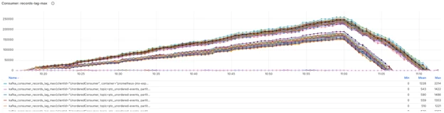

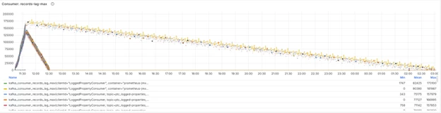

Lag grew to the hundreds of thousands quickly, was surely beyond recovery at this size. The partitions were increased at 11:45 to demonstrate the poor distribution of data processing within Event Hub. Around 15 hours to recover.Lag grew to the hundreds of thousands quickly, was surely beyond recovery at this size. The partitions were increased at 11:45 to demonstrate the poor distribution of data processing within Event Hub. Around 15 hours to recover.Here it is up close, see how every partition is doing a tiny amount of work, and it takes quite a long time?Here it is up close, see how every partition is doing a tiny amount of work, and it takes quite a long time?
Too much lag, and the data will be lost in one of two ways: not being added to an already full queue within Event Hub, or by erroring out as Event Hub tries to pass it back with a variety of errors. If Event Hub backs up too much to be recovered by upsizing, or it cannot be upsized enough, it can be deleted, and only the type of data affected will see loss, and with no downtime for ThingWorx.

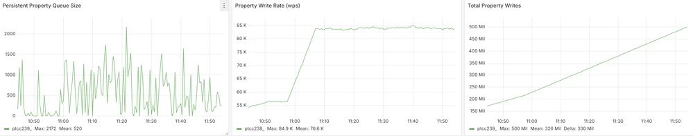

The test begins at 11 am.

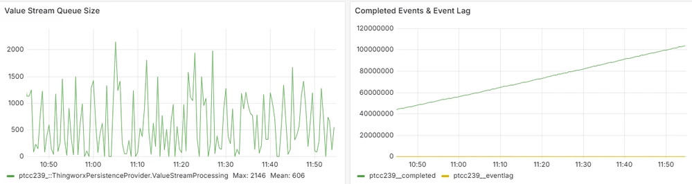

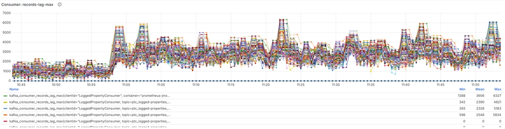

Lag is steady and the spikes are not increasing over time (though they come close).Lag is steady and the spikes are not increasing over time (though they come close).
The property write rate includes the 20 properties that go to Event Hub, plus the 10 date time properties for measuring latency, and one additional info table property for a more realistic load.The property write rate includes the 20 properties that go to Event Hub, plus the 10 date time properties for measuring latency, and one additional info table property for a more realistic load.

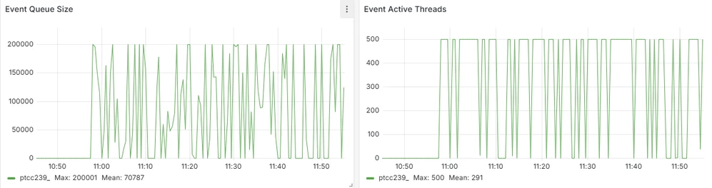

This looks the same as it usually does, there is no change to performance.This looks the same as it usually does, there is no change to performance.

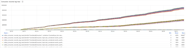

This is high because of the design of the test, all of the things update on thing template level timer subscriptions. This is much lower with opt-in for durable events.This is high because of the design of the test, all of the things update on thing template level timer subscriptions. This is much lower with opt-in for durable events.
