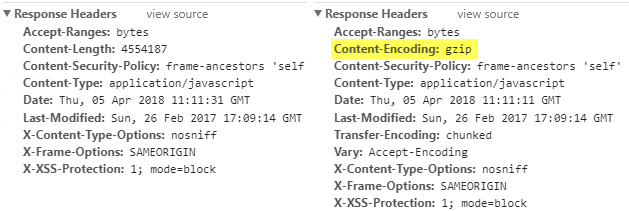

Gzip compression
Usually Tomcat is compressing content in gzip. To verify if a certain response is in fact compressed or not, the Development Tools or Fiddler can be used. The Response Headers usually mention the compression type if the content is compressed:
Left: no compression
Right: compression on Tomcat level

High potential performance improvement
Looking at the Combined.js the content size can be reduced significantly from 4.3 MB to only 886 KB.
For my simple Mashup showing a chart with Temperature and Humidity this also decreases total load time from 32 to 2 seconds - also decreasing the content size from 6.1 MB to 1.2 MB!
This decreases load time and size by a factor of 16x and 5x - the total time until finished rendering the page has been decreased by a factor of almost 22x! (for this particular use case)
