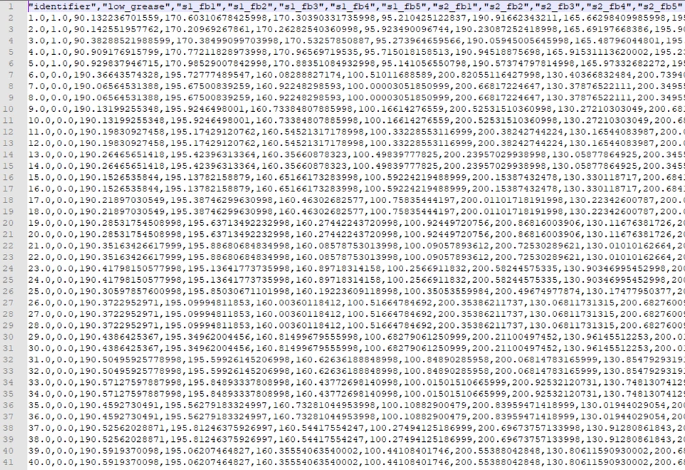

In this guide, you’ll create a Timer to generate thousands of data points, and then export the dataset as a Comma-Separated Values (.csv) file for future use in building an analytical model of the engine.

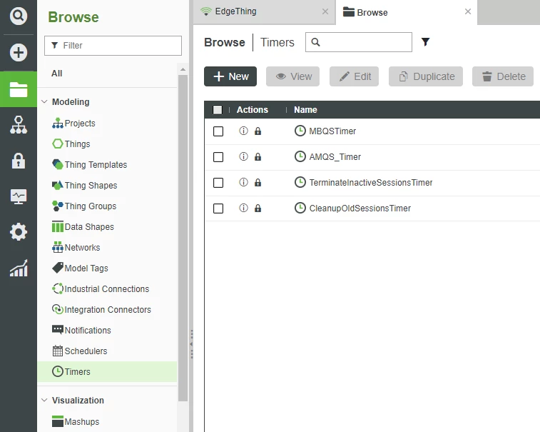

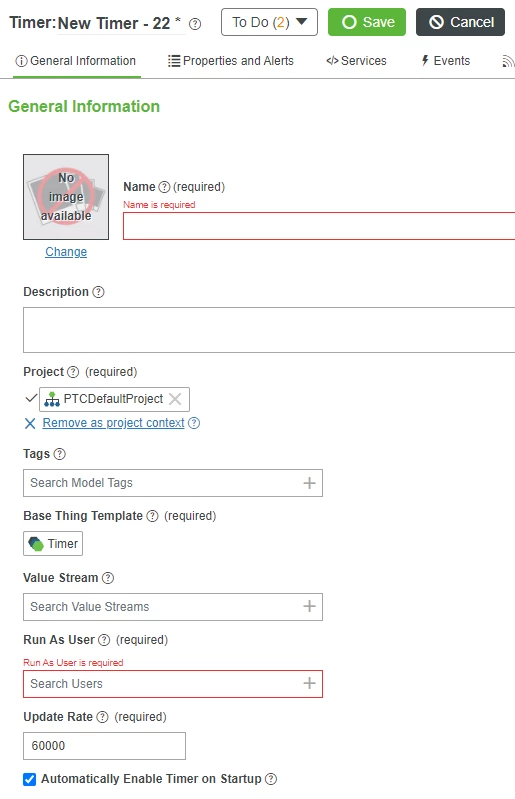

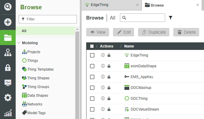

1. Return to the ThingWorx Foundation Browse > All navigation.
2. Click MODELING > Timers.
3, Click + New.

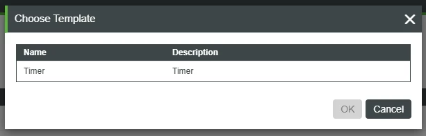

4. On the Choose Template pop-up, select Timer and click OK.

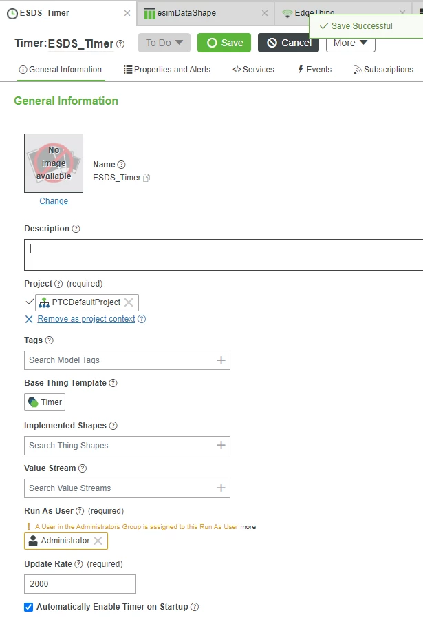

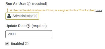

5. In the Name field, type ESDS_Timer.
6. If Project is not already set, search for and select PTCDefaultProject.

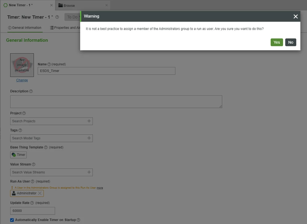

7. In the Run As User field, search for and select Administrator.
8. On the Warning pop-up, click Yes.
- Note that the Administrator user should only be utilized for testing and never in a production system.
9. Set the Update Rate to 2000.
- The EMS updates values around every second, i.e. 1000ms, so we want a time longer than that.
10. At the top, click Save.

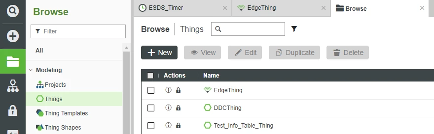

1. Click Browse > MODELING > Things.
2. Open EdgeThing and click Properties and Alerts.

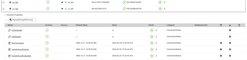

3. Scroll down past the custom Properties to the Inherited Properties.
4. Under the Value column, ensure that isConnected is checked.
If not, return to the previous guides and confirm that your EMS engine simulator is running.

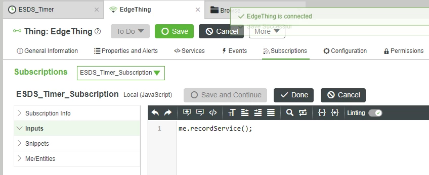

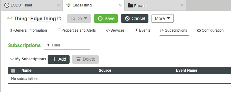

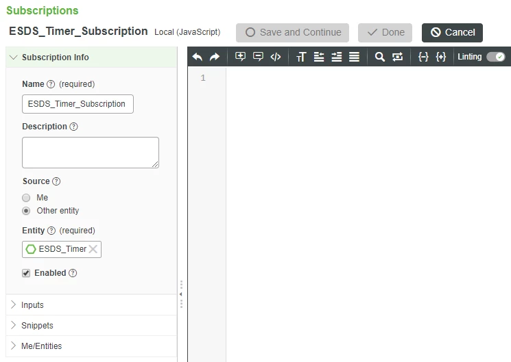

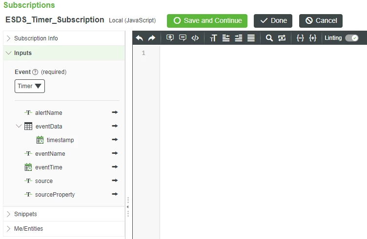

Having ensured that the EMS engine simulator is still providing values to ThingWorx Foundation, we now want to create a Subscription, which will trigger off our earlier timer.

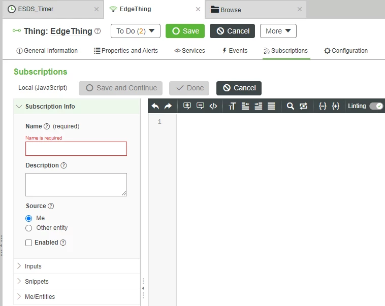

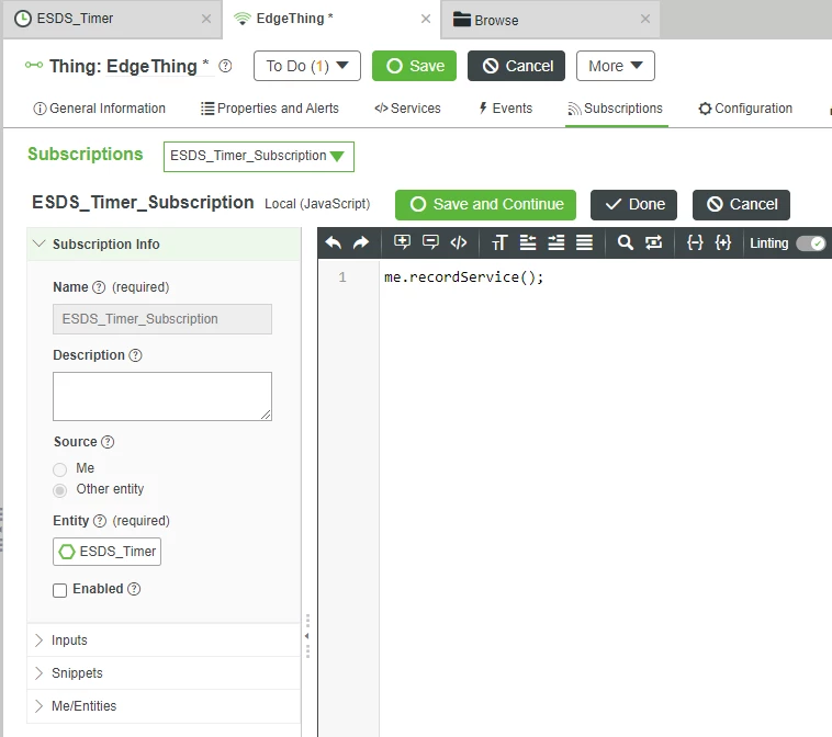

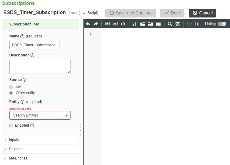

1. At the top, click Subscriptions.
2. Click + Add.
3. In the Name field, type ESDS_Timer_Subscription.
4. Under Source, select the Other entity radio-button.
5. In the Search Entities field, search for and select ESDS_Timer.
6. Check the Enabled box.

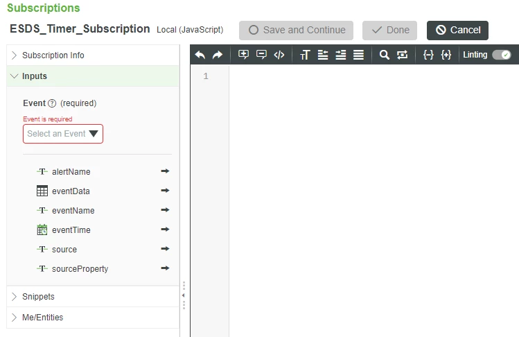

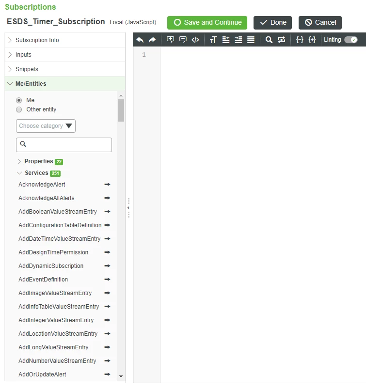

7. Expand the Inputs section.

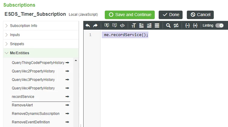

8. In the Select an Event field, search for and select Timer.

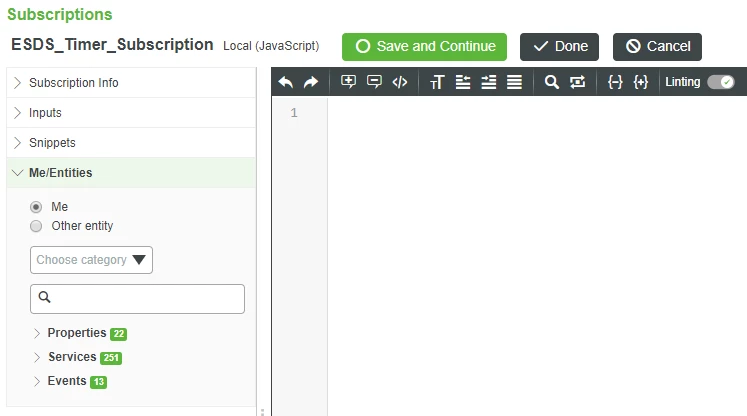

9. Expand the Me/Entities section.
10. Expand the Services sub-section.
11. Scroll down until you find the custom recordService, and click the right-arrow beside it.
12. Click Save and Continue.
Note that you should NOT click the top “Save”, as that will erase the Subscription.

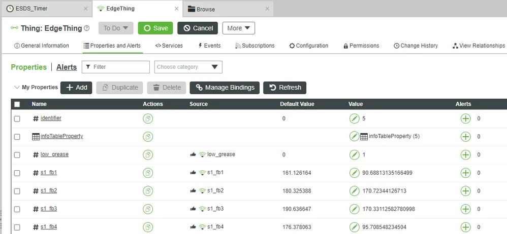

With the progress so far, another entry is captured and added to the Info Table Property ever two seconds. We'll confirm that now.
The longer that you let the Subscription run, the more entries will be automatically captured in the infoTableProperty. ThingWorx Analytics can use this information to build an analytical model.
To do so, though, it needs thousands of entries. For example, we’ve gotten good model results with 30,000 data points. In general, more is better.
As such, your Subscription would need to run until you have gathered 30,000 entries in the infoTableProperty. Unfortunately, this can take roughly 15-16 hours.
You can simply let the timer run for a short time and then continue with this guide immediately.

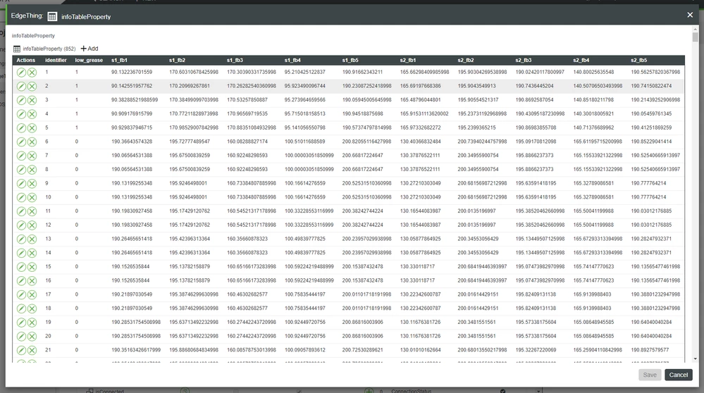

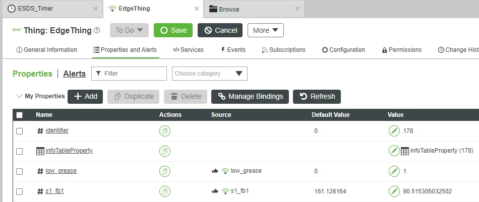

1. At the top, click Properties and Alerts.
2. Click the Refresh button several times.
- Note that both the identifier Property and the count of the number of entries in the infoTableProperty are continually increasing.
3. Under the Value column, click the “pencil icon” for infoTableProperty to select Set value of property.
- It may take a few moments for the pop-up to load.
4. Note that various values coming from the EMS engine simulator.
5. At the top-right of the pop-up, click the X button.

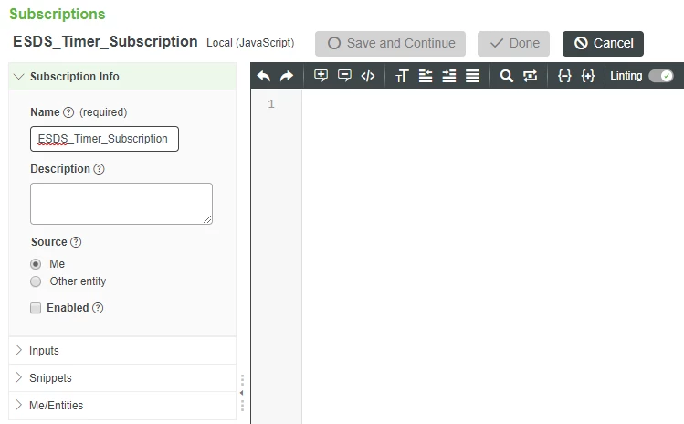

Stop Data Gathering
After achieving the dataset size you desire, you should stop gathering to prevent your dataset from growing arbitrarily large.
1. At the top of EdgeThing, click Subscriptions.
2. If it is not already expanded, click ESDS_Timer_Subscription.
3. Expand Subscription Info.
4. Uncheck the Enabled box.
5. Click Save and Continue.
