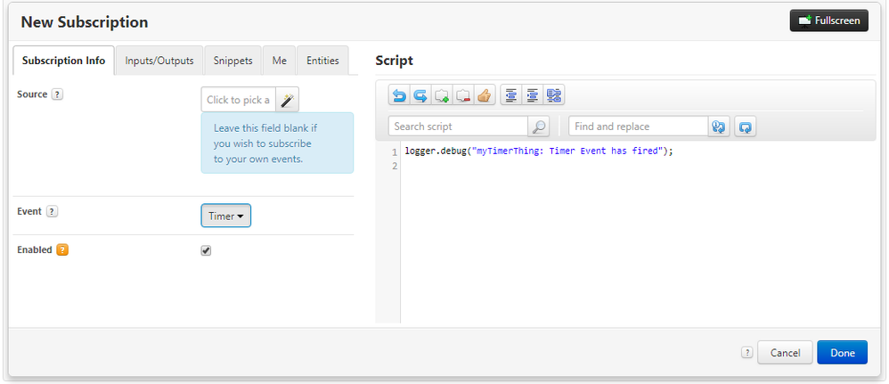

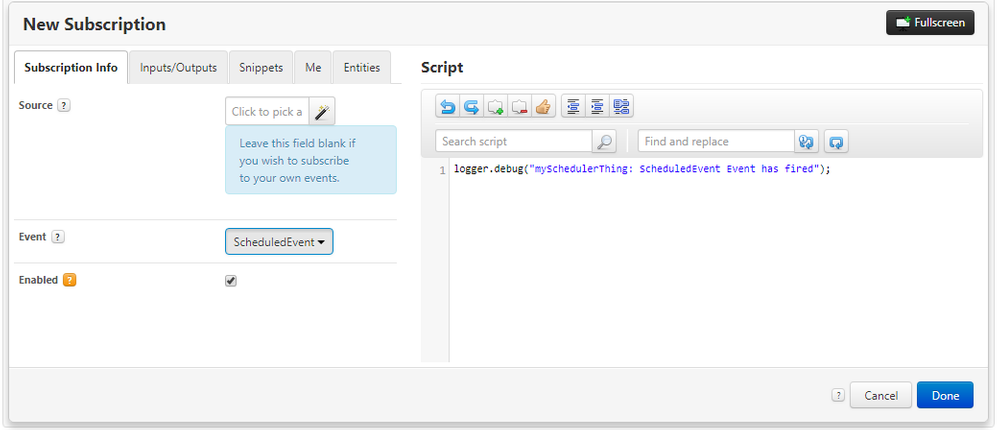

  • Subscriptions listen to Events and can be used to react to certain Events with running custom Service scripts.
  • To follow-up on Timers and Schedulers, a new Subscription must be created, listening to any related Event fired.
  • Add a new Subscription to the Thing with
  • As the Subscription is usually listening to the Thing that it is configured on, the Source has to be left empty. When listening to other Entities' Subscriptions the corresponding Entity can be picked in the Source Entity picker.
  • Ensure to check the Enabled checkbox to actually enable the Subscription and allow it for executing code in the Script area.
  • The following Script will log into the ScriptLog once the Timer Event is fired
  • The following Script will log into the ScriptLog once the ScheduledEvent Event is fired
