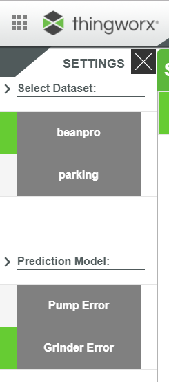

On launching the mashup, data sets and models are displayed for selection on the left hand-side.
On selecting dataset and model, signals are presented in two tabs - first an overview of all signals. The list on the left can be expanded by changing the value for 'Top <n> Contributing Features'.

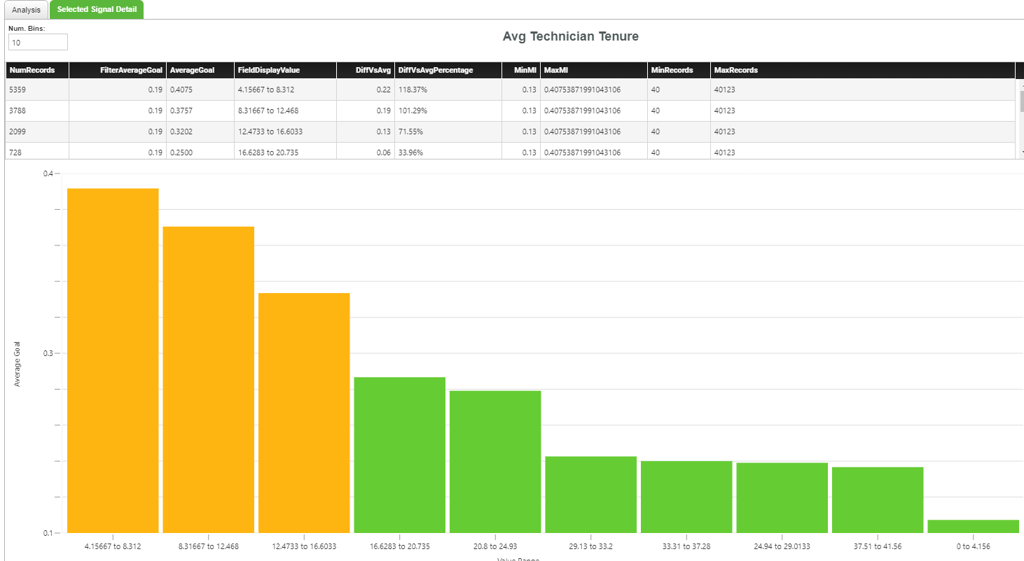

On selecting a signal from the list, the 'Selected Signal Details' tab displays additional charting for value ranges, average goal etc. The number of 'bins' to display can be edited.

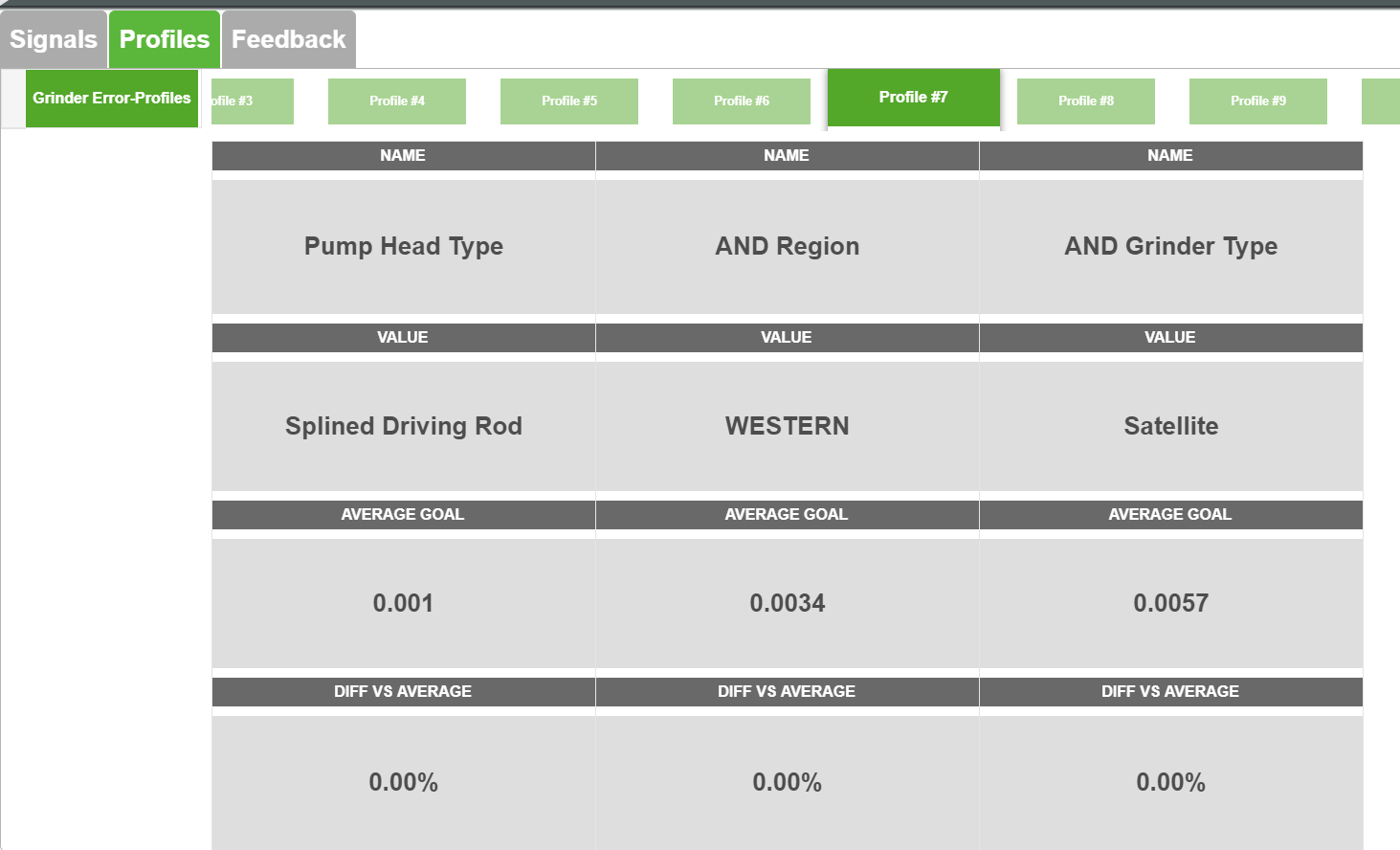

Similarly, profiles can be viewed from the 'Profiles' tab - each profile can be selected by dragging the upper carousel.

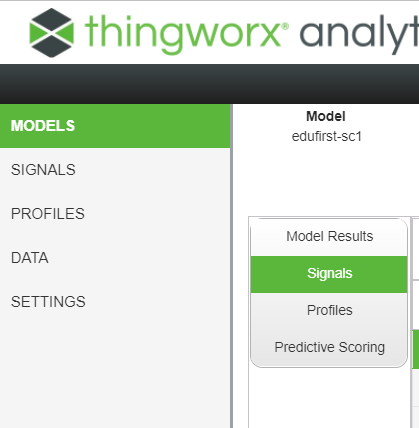

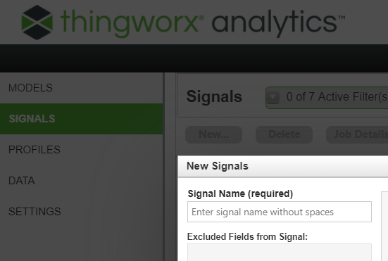

As at Analytics version 8.1, in case you're having a problem seeing Signals and Profiles using this mashup, please note that the Signals and Profiles need to be created from inside the model, not from the main Analytics Builder screen.
So you need to click Models, then select your model, then select View, now click Signals inside the model. If this has not previously been done for this model, you will see the message "No Signals exist for this Model, do you want to create them?". Click Yes and the Signals will be generated. The menu option is shown in the screenshot below:
If however you create the Signals and Profiles from the main Analytics Builder screen, then they will not be visible from EMEA.Analytics.CustomerInsightMashUp. So any Signals and Profiles created using the method shown in the screenshot below will not be visible in EMEA.Analytics.CustomerInsightMashUp:

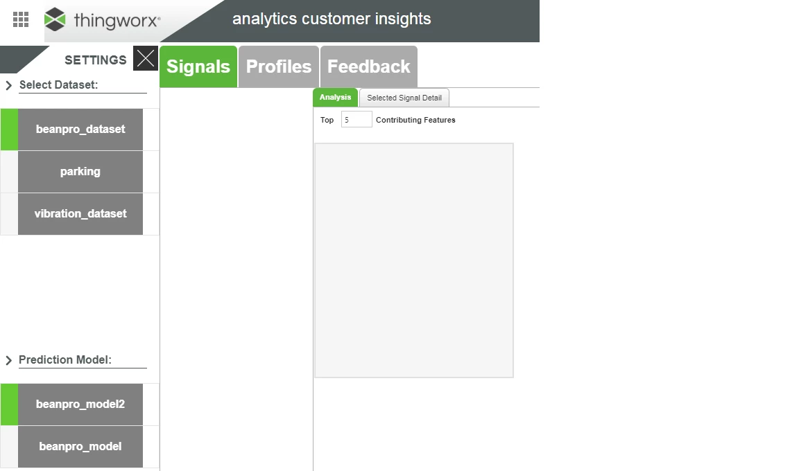

I find this example very interesting and helpfull but I can't make it work on my Thingworx 8.3 installation.
After importing the extension and mashup, and installing TWX Utilities, a can view in the mashup my datasets and models but I cannot see any data on the right side of the page, and no error is prompted (see attached)
I tried to create the signals from the analytics manager model but I don't have the option to do it, the only option I've got to create signals it is under analytics buider.
Can someone tell me which are the steps that I have to make before to make this exercise work properly on my installation?
Thanks in advance.
Olatz

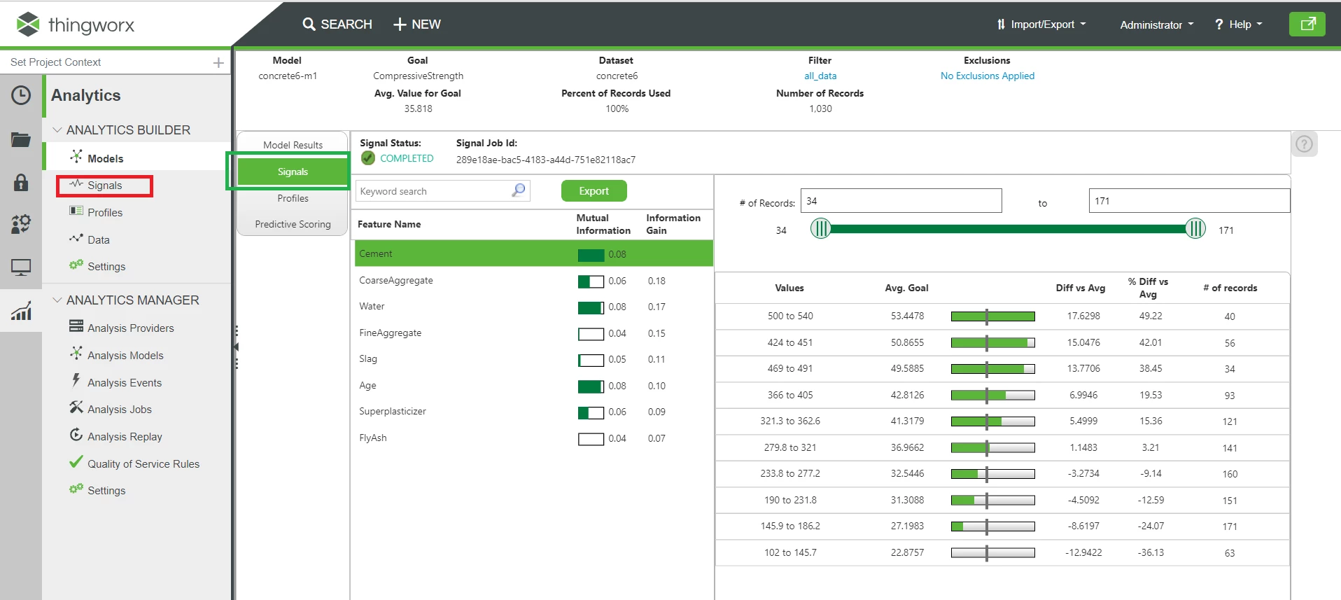

Hello Olatz, there is no option to submit Signals jobs from Analytics Manager, only from Analytics Builder.
Also since the last couple of versions there are 2 places in Builder where you can submit the Signals job, highlighted in the attached screenshot. You can submit from inside the model (highlighted green) or from the main analytics Builder (highlighted red).
I think for this Example Mashup (EMEA.Analytics.CustomerInsightMashUp) it is better to submit Signals from inside the model (highlighted green)
I hope that helps, regards Tanveer.

After creating the signals and profiles I am able to navigate in the mashup but I am getting the next error in the monitor when selecting "Selected signal detail":
[context: com.thingworx.webservices.context.HttpExecutionContext@2b6e425c][message: Execution error in service script [GetSignalDetails] :: TypeError: Cannot find function GetAverageGoalAMS in object com.thingworx.things.ConfiguredThing@7877421e. (GetSignalDetails#30)]
Editing the thing "EMEA.Analytics.Helper", in the service "GetSignalDetails" there is a call to:
            averageGoal = Things["TW_ML_Helper"].GetAverageGoalAMS({
But, editing the thing TW_ML_Helper, the service GetAverageGoalAMS doesn't exist, but there is a service called GetAverageGoalBySQLAMS. Should I change the call to the service that exist in my installation or do I miss something?
Thanks in advance.
Olatz.
