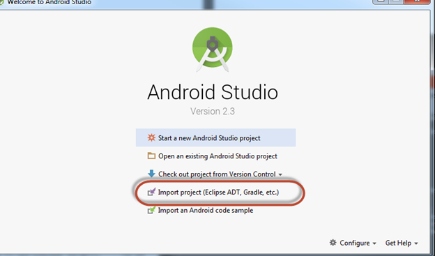

2. Start the Android Studio > Import project > navigate to the sample applications location provided with the ThingWorx Android SDK e.g. Thingworx-Android-SDK-X.x.x\samples

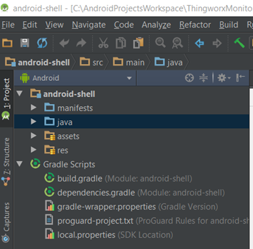

6. Once imported successfully in Android Studio you should be able to see the Android project and its file structure like so

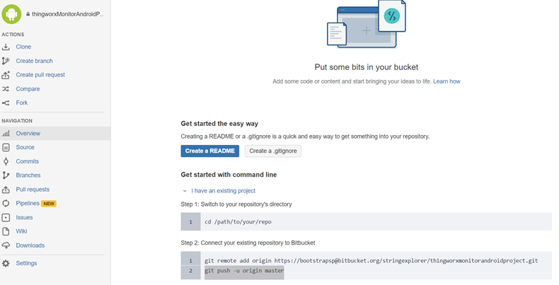

7. We'll need an account with Bitbucket, create one if you don't have already
8. Logon to Bitbucket and create a team and new repository under that team
9. Navigate to the repository created in Bitbucket

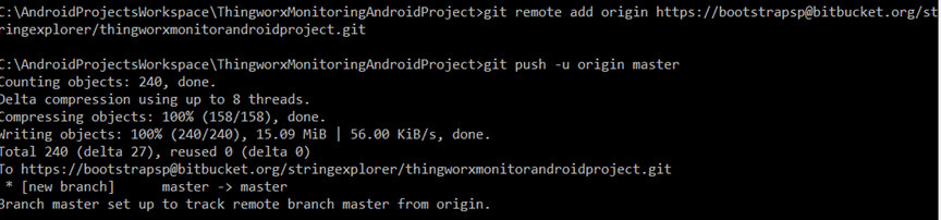

11. On your local machine open a command prompt and navigate to the drive where the local GIT's code repository resides, i.e. the folder where you unzipped the android SDK and execute the commands as mentioned:
a. git remote add origin https://<accountName@bitbucket.org>/<teamName>/<projectName>.git
b. git push -u origin master
Note: This will add the contents of your local GIT repository to the empty code repository you’ve created under the team on Bitbucket.
12. You can also use SourceTree UI application on windows for creating, GIT and Mercury based code repository and connect it to your Bitbucket account
13. On successful commit following will be logged in the command prompt

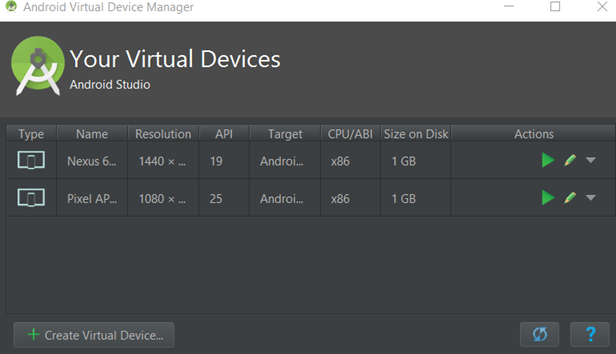

4. Go to the Android Studio's toolbar and click on AVD Manager icon
5. This will open the Android Virtual Device Manager and lets you create a virtual Android device
6. You can of course use your own actual device to connect over USB and install and test the application on actual hardware

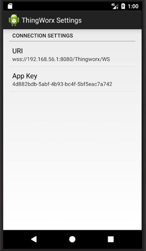

12. When initiating/running the application for the first time you will be directed to the Settings screen allowing you to enter the connection URI and the Application Key to connect to the ThingWorx server
13. You have to follow one of the following two URI schemes while attempting to connect to a ThingWorx Server
a. For HTTP connection use : ws://<machineIP/Name>:8080/Thingworx/WS
b. For HTTPS connection use : wss://<machineIP/Name>:8443/Thingworx/WS
Note: Ports may differ as these are the default ports, if you are running ThingWorx on different port enhance the URI accordingly
14. Since my ThingWorx is reachable on HTTPS connection i'll use the HTTPS connectino URI scheme and the application key that I have already created in the ThingWorx, which is bound to Administrator user
15. Once done press the back button on the screen to initiate the connection attempt
16. If all's set as it should be you will be able to see the Connected to Server option checked and the Property count for the Serial Number Property being updated every second
