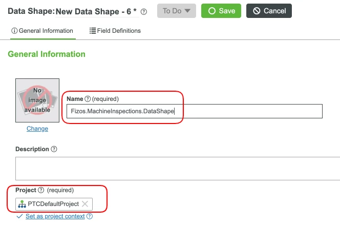

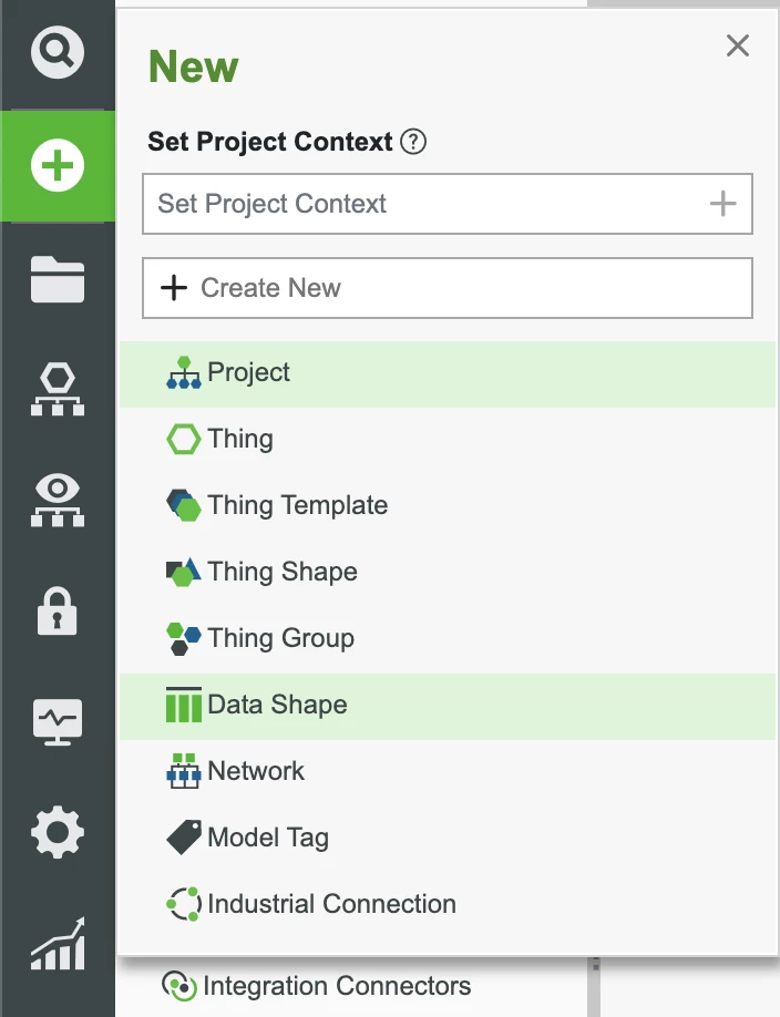

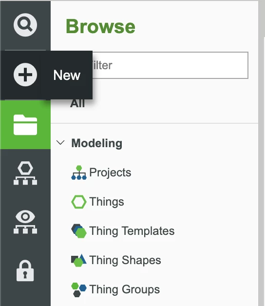

  1. In the ThingWorx Composer, click the + New in the top left of the screen.
  2. Select Data Shape in the dropdown.

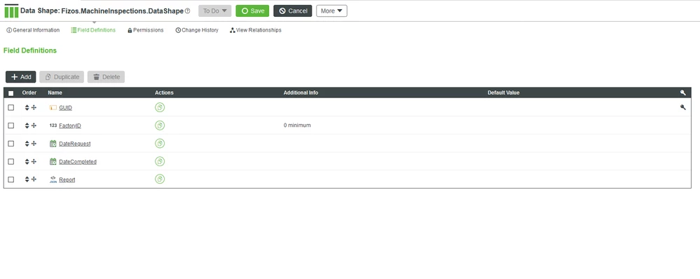

  3. In the name field, enter Fizos.MachineInspections.DataShape and set a Project (ie, PTCDefaultProject).
  4. Click Save. All of our machine inspections will be based on this Data Shape.
  5. Add the list of fields below:
Name
Base Type
Aspects
Description
GUIDGUIDPrimary keyString used as unique identifier for the inspection
FactoryIDInteger0 minimumFactory identifier at time of inspection
DateRequestDateN/ADate the inspection was requested
DateCompletedDateN/ADate the inspection was completed
ReportJSONN/AThis will hold the inspection report data
The properties for the Fizos.MachineInspections.DataShape Data Shape are as follows:

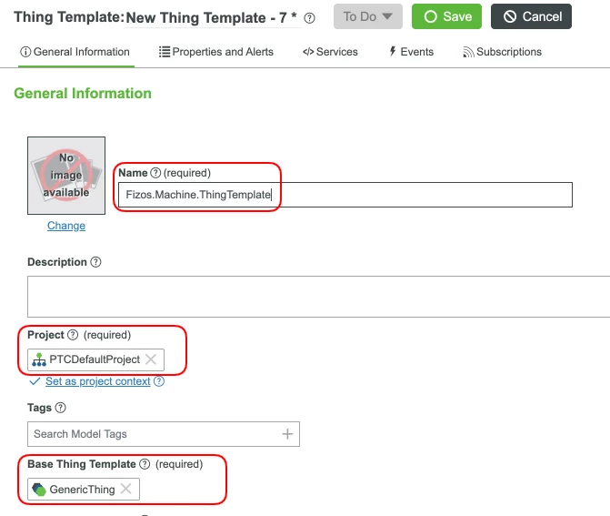

Create Machine Template
  2. Select Thing Template in the dropdown.

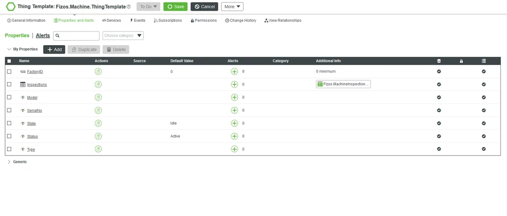

  3. In the name field, enter Fizos.Machine.ThingTemplate. All of our machines will be based off this template.
  4. In the Base Template field, enter GenericThing and set a Project (ie, PTCDefaultProject). In real world examples, you would likely use a RemoteThing.
5. Open the Properties section. Create the following list of properties.
Name
Base Type
Aspects
Description
FactoryIDInteger0 minimum, default 0The factory ID in which this machine is currently located
TypeStringN/AType of machine
SerialNoStringN/ASerial number of the machine
ModelStringN/AMachine make and model
StateStringDefault: IdleMachine state (Idle, Working, Warning, Failed)
StatusStringDefault: ActiveMachine status (Active, Inactive, etc)
InspectionsInfoTableDataShape: Fizos.MachineInspections.DataShapeList of inspection reports
These properties should match the following:

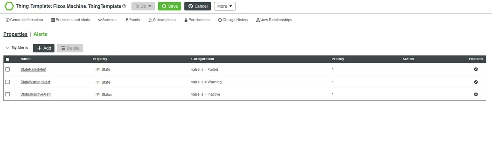

6. Open the Alerts section. Create the following list of alerts.
Name
Property
Configuration
StateFailedAlertStateEqual Failed
StateWarningAlertStateEqual Warning
StatusInactiveAlertStatusEqual Inactive
These alerts should match the following:

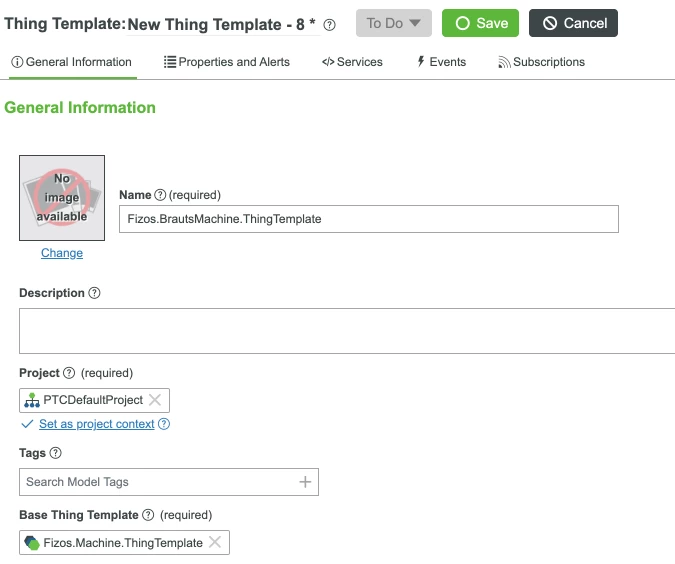

Create Machine Template By Product
Here at Fizos, we specialize in brauts and regular sausages. That being said, we will have some machines that are specific to each product. We will also have machines that are generic in nature and shared between the two systems. The template we just created will work for the machines that are common between both product lines. We'll now create two templates that will be specific to brauts and regular sausages. We are doing this to show the levels of granularity that can be done. In some cases, you might not want to create another template level based on your design.

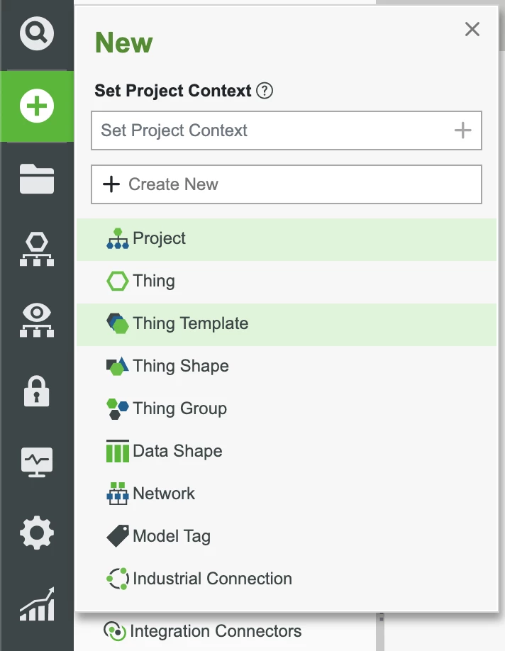

  3. In the name field, enter Fizos.BrautsMachine.ThingTemplate. All of our brauts machines will be based off this template.
  4. In the Base Template field, enter Fizos.Machine.ThingTemplate and set a Project (ie, PTCDefaultProject).

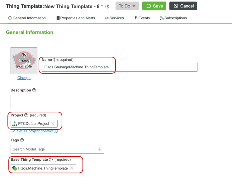

  3. In the name field, enter Fizos.SausageMachine.ThingTemplate. All of our sausage machines will be based off this template.
