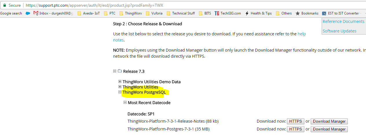

January 23, 2017
Hi Team,
Please share the links to obtain the below batch files,
1.thingworxPostgresDBSetup.bat
2.thingworxPostgresSchemaSetup.bat
Thanks in Advance.
January 23, 2017
Rdhakrishnan Kandasamy​ :
You can download these batch files from PTC eSupport portal using your Customer Name and Number. You will need valid credentials to login to eSupport portal.
On PTC Software Download page with selection as Thingworx Platform and search for Thingworx PostgreSQL under Releases. You will get a download file as MED-61111-CD-070_F000_ThingWorx-Platform-Postgres-7-x-x as per the release selected. On unzipping this you will have the required files inside Update folder.
