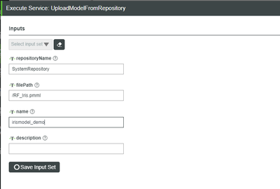

To upload and use the model for scoring, there are two steps that you need to do:
  1. First, the PMML file needs to be uploaded to a ThingWorx File Repository
  2. Then, go to your Analytics Results thing (the name should be YourAnalyticsGateway_ResultsThing) and execute the service UploadModelFromRepository. Here you will need to specify the repository name and path for your PMML file, as well as a name for your model (and optionally a description)
If everything goes well, the result of the service will be an id. You can save this id to a separate file because you will use it later on.

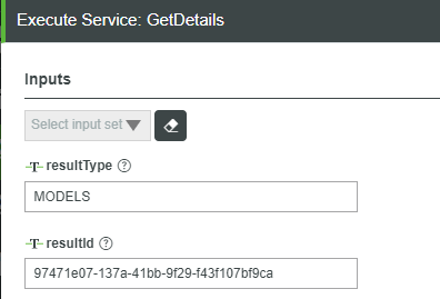

You can verify the status of this model and if it’s ready to use by executing the service GetDetails:

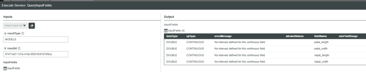

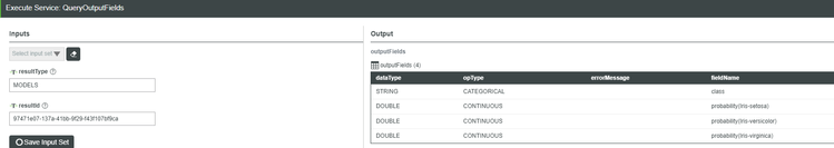

Assuming you want to use the PMML for scoring, but you were not the one to develop the model, maybe you don’t know what the expected inputs and the output of the model are. There are two services that can help you with this:
  • QueryInputFields – to verify the fields expected as input parameters for a scoring job
  • QueryOutputFields – to verify the expected output of the model
The resultType input parameter can be either MODELS or CLUSTERS, depending on the type of model,
