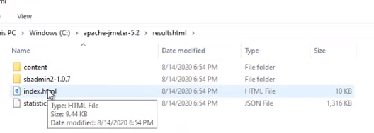

    3. Running the above commands will generate these files:

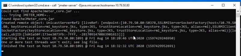

  3. When the test is complete, the many JMeter client consoles will look like this:
  4. Go ahead and close the windows to terminate once they are finished. Optionally you can run multiple tests sequentially using the same jmeter-server windows.

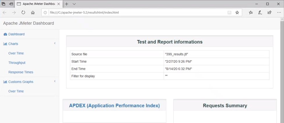

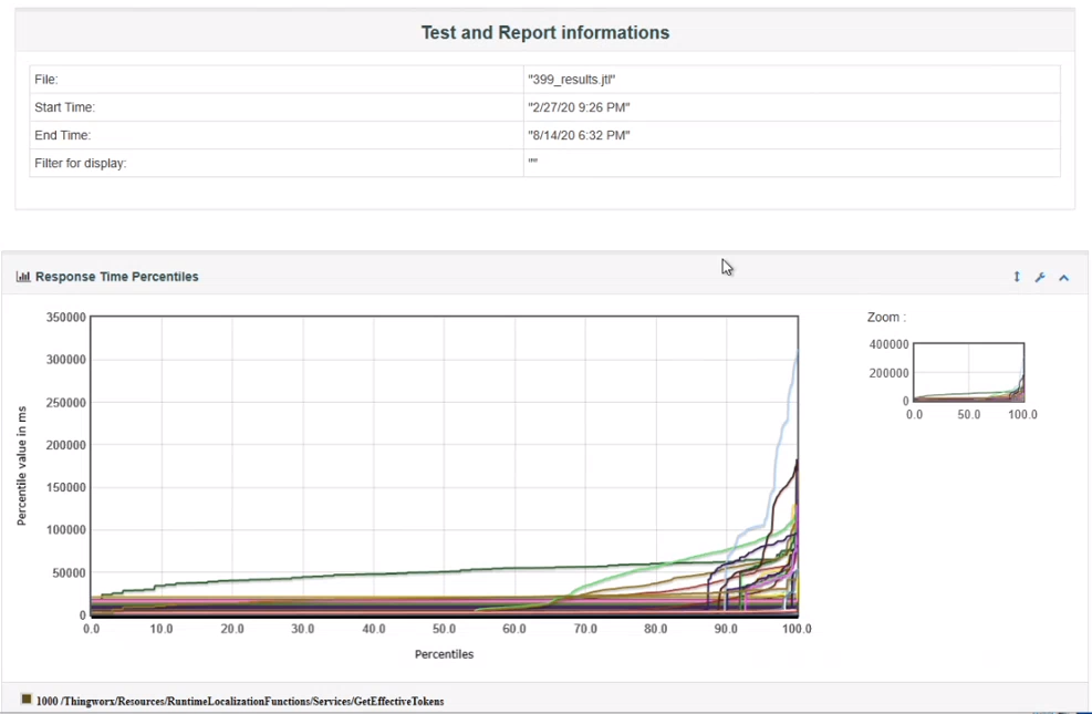

  5. Click on the “index.html” file to open the results viewing window:
  6. At any time, modify the settings of this “HTML dashboard” using the details from the JMeter user manual. This citation describes many options for these dashboards, as well as recommendations on how to group and format the results in ways which best convey the success or failure of the test, based on the custom requirements of the application and how granular the view needs to be. Most of the time, the default settings work ok, showing something similar to this:
    1. The charts aren’t labeled very well here, so click on the Response Times submenu:
    2. This page may take some time to render if there is a lot of data:

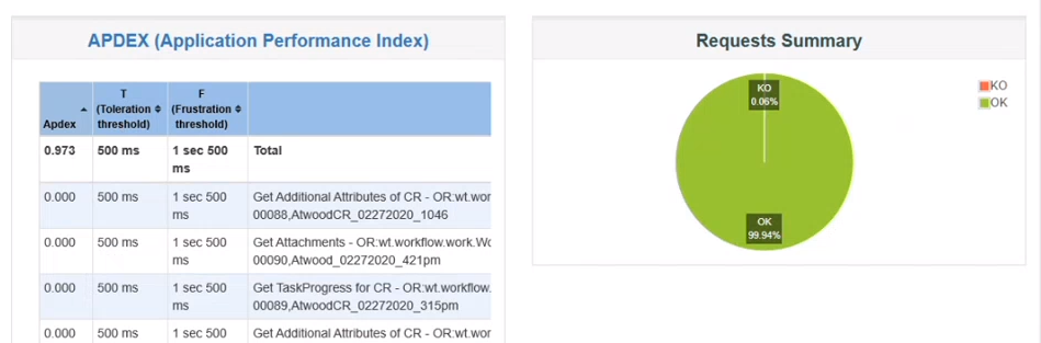

    3. Next, scroll down to see all the requests that occurred and sort them by how long they took to complete. Anything which took over 5 seconds (or more depending on what is expected) should be investigated as part of the post-test analysis. Does something need to be tuned or optimized? This is how to tell which request is holding things up for your customers.

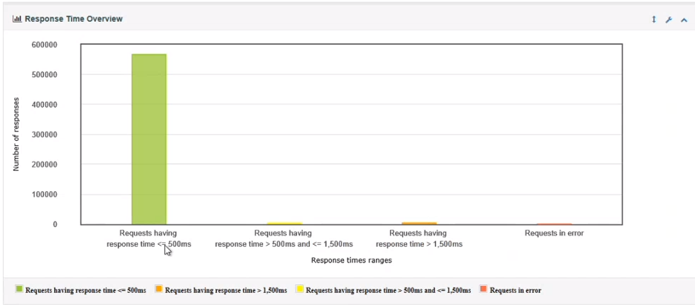

    4. There is also a chart that shows the overview, grouping the response times by how long they took to demonstrate the health of the system more concretely. Typically, the bars look something like this:
      imageThis represents expected behavior, where most of the requests are quite fast, and then there are a few that had errors or took a bit longer. This is pretty typical for web activity.

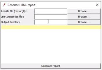

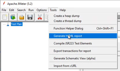

  7. You can also generate the report through the main JMeter client:
    1. Give it a results file and an output directory to generate the same index file:

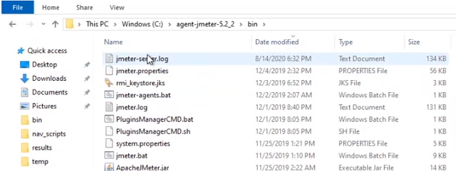

  8. There are log files in each of the JMeter client directories called “jmeter-server.log”:
    1. These files may show the wrong timezone, but the elapsed times are correct, and they will show when the JMeter clients started, how many threads they ran, which servers were which, and if there were any errors. Not all errors will mean a failed test, so review anything that appears and determine what is expected.
    2. Consider designing a batch script to gather all of these logs together, or even analyze them automatically to extract only relevant information.

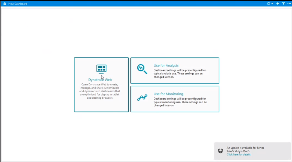

How to Create Server-Side Results in DynaTrace

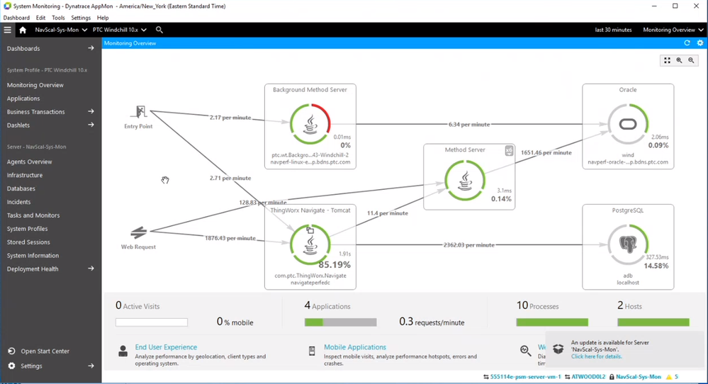

Collecting data from the environment, including CPU usage, Memory utilization (used vs. total), Garbage Collection times and other metrics of system health on the server, will require the use of an external tool. PTC’s official tool for this is called DynaTrace (PTC System Monitor), shown here. PTC offers a runtime license for DynaTrace to anyone who buys certain products, including Kepware Server, ThingWorx Foundation and Navigate, Windchill, Integrity, and more. Read more information about DevOps on the PTC Community, and stay tuned for more articles on the subject to come from the EDC.
Another option would be something like telegraf and Grafana (from the previous blog post), which facilitate the option to create dashboards around the data output specific to the needs of the application, which can still be monitored even once the application goes live. It can certainly be worth it to use such a tool for monitoring the server-side, but the set-up takes more time. Likewise, many VMs have monitoring faculties for CPU usage and memory utilization built-in, but DynaTrace also has visualization, consolidation of system elements, and other features that make it easy to use right out of the box. See the screenshots below for some examples on how to use DynaTrace, and be sure to review PTC’s full documentation here.
imageThe example shown here is a ThingWorx Navigate system, with Windchill and ThingWorx Foundation set up side-by-side. This chart shows the overall response times of the server-side of the system. JMeter collects the statistics on what the client looks like, while another tool is required to collect the server-side metrics like CPU usage and Memory utilization, things that indicate the health of the VM or computer hosting the clients. An older version of DynaTrace is depicted here, available for free for all ThingWorx customers from the PTC Downloads Site (under various product listings).

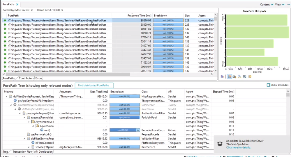

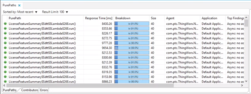

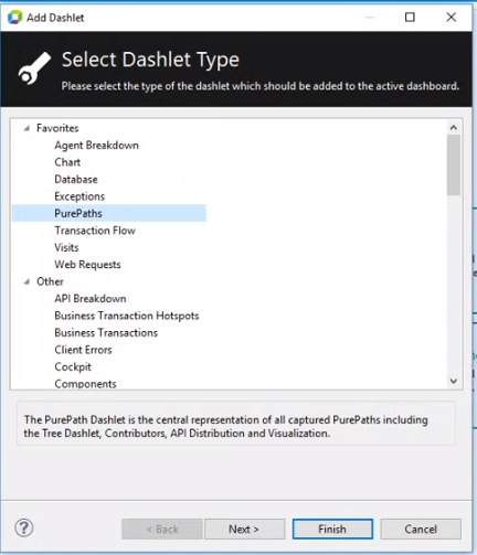

In DynaTrace, you can build new dashboards using PurePaths:
You can also look at the response times for each service, but be sure to change the response limit to a large number so that all the results are returned.
imageimageChanging the response limit to a large number to ensure all of the results show in the PurePaths dashboard.
Highlighted here in DynaTrace is the longest service that ran, which in this case took 95 seconds to fully respond:
More specific analysis of this service can now begin. Perhaps it needs to be tuned, or otherwise optimized to handle the number of threads, i.e. the number of users. Perhaps the system needs more resources or the VM isn’t large enough for the test. Perhaps more JMeter clients and system resources are required. Something will explain this long response time, and that will inform as to what work might still remain before this system can scale up to the enterprise level.

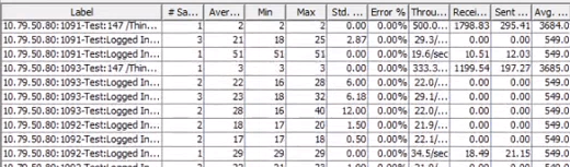

Other criteria can be used as well, say if any one thread takes more than 5 seconds to respond. Also ensure there are no unexpected errors, as gateway errors represent failed tests too. Sometimes there will be errors even when the test is successful, though, so consider monitoring the error percentage, a column in the Summary Report tab of JMeter, to see what is normal. The throughput column may also be something to monitor. Many watch for increases in throughput as the thread count increases to ensure there is no degradation in performance (which may indicate hardware or sizing constraints).
The Summary Report will look something like this, with thread group results from all of the clients appearing side by side, differentiated from each other by the unique port:
