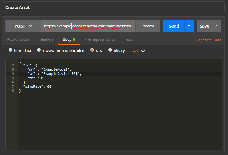

The first time a device connects to the Axeda Machine Cloud it should send a registration message.  A registration message must contain a model and serial number and can optionally include a ping rate.  The ping rate is how often the server should expect to hear from the device. The server will mark a device as off-line if it does not get a message before a configurable number ping times pass.  A device should also send a registration message whenever it powers up.
Using Postman, select POST  from the drop down next to the URL.  Enter the URL as shown below to register a new device.
https://example-connect.axeda.com/ammp/assets/1​ (Customers should use their own instances in the following examples)
Click ​Headers​ to add a header named 'Content-Type' with value of 'application/json':
Click the Body button and enter the line below.  The "mn" field below should be an already registered and configured model.
{  "id": { "mn" : "ExampleModel", "sn" : "ExampleDevice-001", "tn" : 0  },  "pingRate": 60  }
Click the Send button - an HTTP 200 OK response should be the expected result.  Logging into the platform and searching for ​'ExampleDevice-001' should show that it is registered

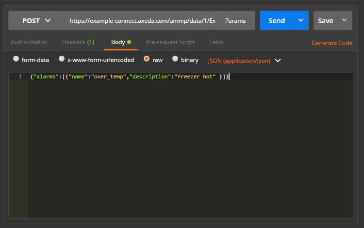

Now that a device has been registered is is now possible to send live information to the Axeda Machine Cloud.
Sending information is also done with a POST to a URL.  Instead of the asset's resource, we will be sending to the data resource.  Using Postman, the HTTP POST request will be structured like follows:
http://example-connect.axeda.com/ammp/data/1/ExampleModel!ExampleDevice-001
Change the body as follows:
{"alarms":[{"name":"over_temp","description":"freezer hot" }]}
Click on the 'Send' button and after the response returns, the alarm can be seen in the Asset Status Page in the Axeda Machine Cloud.

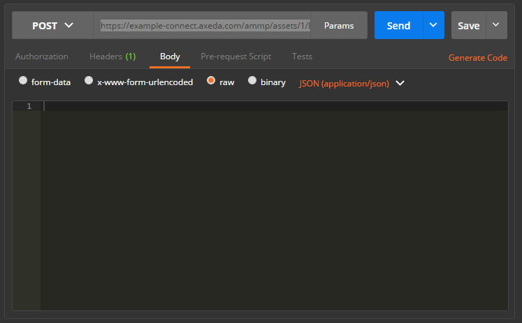

Polling
​Axeda AMMP is designed to provide a minimalist communication protocol between devices.  As such each request has egress items returned in the HTTP response body, no matter the type of data sent as the request body.  This is so that extra requests to retrieve egress do not have to be made.  But if a device has no updates to make, it is still able to make periodic polling requests to the Codec Server to get any egress items available to it.
This request is simply a REST request of HTTP POST to the example URL: https://example-connect.axeda.com/ammp/assets/1/ExampleModel!ExampleDevice-001​ ​with an empty request body.
