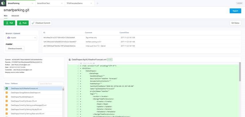

  • Major UX improvements and UI restyling.
    • The extension now includes a new page called GitBackup.Main.Mashup, which offers access to all the functionality previously available in the Home Mashup (see below). GitBackup.Main.Mashup is now the single interface for all the GitBackupThings in the system; you’ll no longer need to go to Composer to manage them individually.imageNew ThingWorx Git Backup Extension 2.0

When I imported the extension, the import was successful however the NewTab Entity is missing from the import.
Therefore making this extension unusable.
Feb 7, 2019 11:58 AM UTC
Same problem here ....
the thing "NewTab" is missing in the extension
Feb 7, 2019 2:01 PM UTC
Hey guys,
Sorry about this issue. This is a known extension bug manifesting only in ThingWorx 8.4. We're working to fix this asap. As a workaround please use the previous version, 1.3.1.
Note: the Extension was tested in 8.3.3 and 8.2.3. Anything minor in those versions should work fine.
