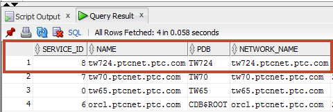

Using above guide I have bunch of pluggable databases as can be seen below. I'll be using TW724 for connecting to ThingWorx server as an external datasource for following example

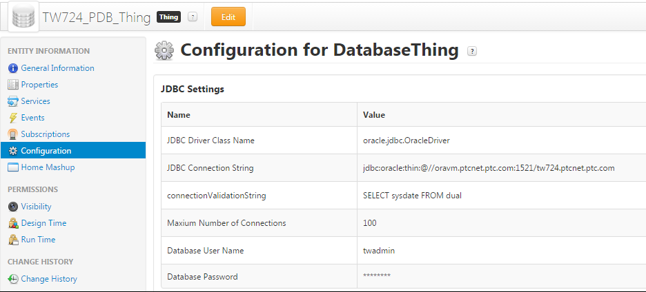

  4. Navigate to the Configurations for TW724_PDB_Thing to update the default configuration:
    1. JDBC Driver Class Name : oracle.jdbc.OracleDriver
    2. JDBC Connection String : jdbc:oracle:thin:@//oravm.ptcnet.ptc.com:1521/tw724.ptcnet.ptc.com
    3. Database Username : <UserName>
    4. Database Password : <password>
  5. Once done save the entity
Note: A PDB in a container database can be reached only as a service and not using the CDB's SID. In the above configuration TW724 is a PDB which can be connected to via it's service name i.e. TW724.PTCNET.PTC.COM

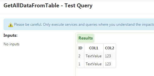

Service for getting all the data from the table
Add another service with script Select * from testTable1 for getting all the data from the table

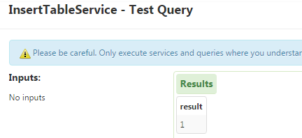

Service for inserting data into the table
Adding another service with script insert into testTable1 (col1, col2) values ('TextValue', 123)  will insert the data into the table created above

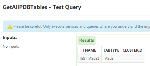

Service for getting all tables from the PDB i.e. TW724
Using Select * from tab lists all the available tables in the TW724 PDB

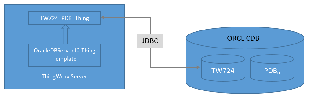

Summary
Just a quick wrap up on how this would look visually refer to the following image. Since this is a scalable setup - given the platform having enough resources it's possible to create upto 252 PDBs under a CDB therefore 252 PDBs could be created and configured to as many things extending the OracleDBServer12 Thing.
