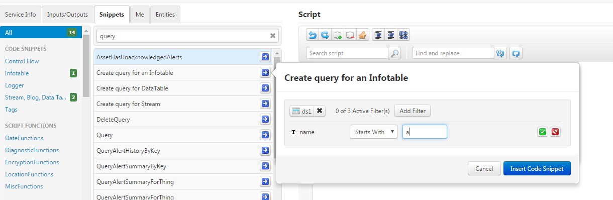

  Besides, to create a query is also a one step operation in Thingworx , you do not need to create it manually:
