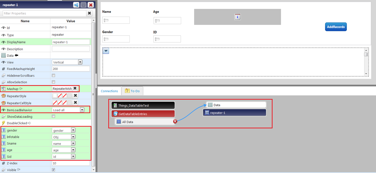

    • The second part is a repeater widget.
    • Repeater widget has an attribute named Mashup, bind the mashup Repeatermsh. Bind GetDataTableEntries all data to the repeater widget. There should be some parameters that need to bind like gender, InfoTable, Sname…

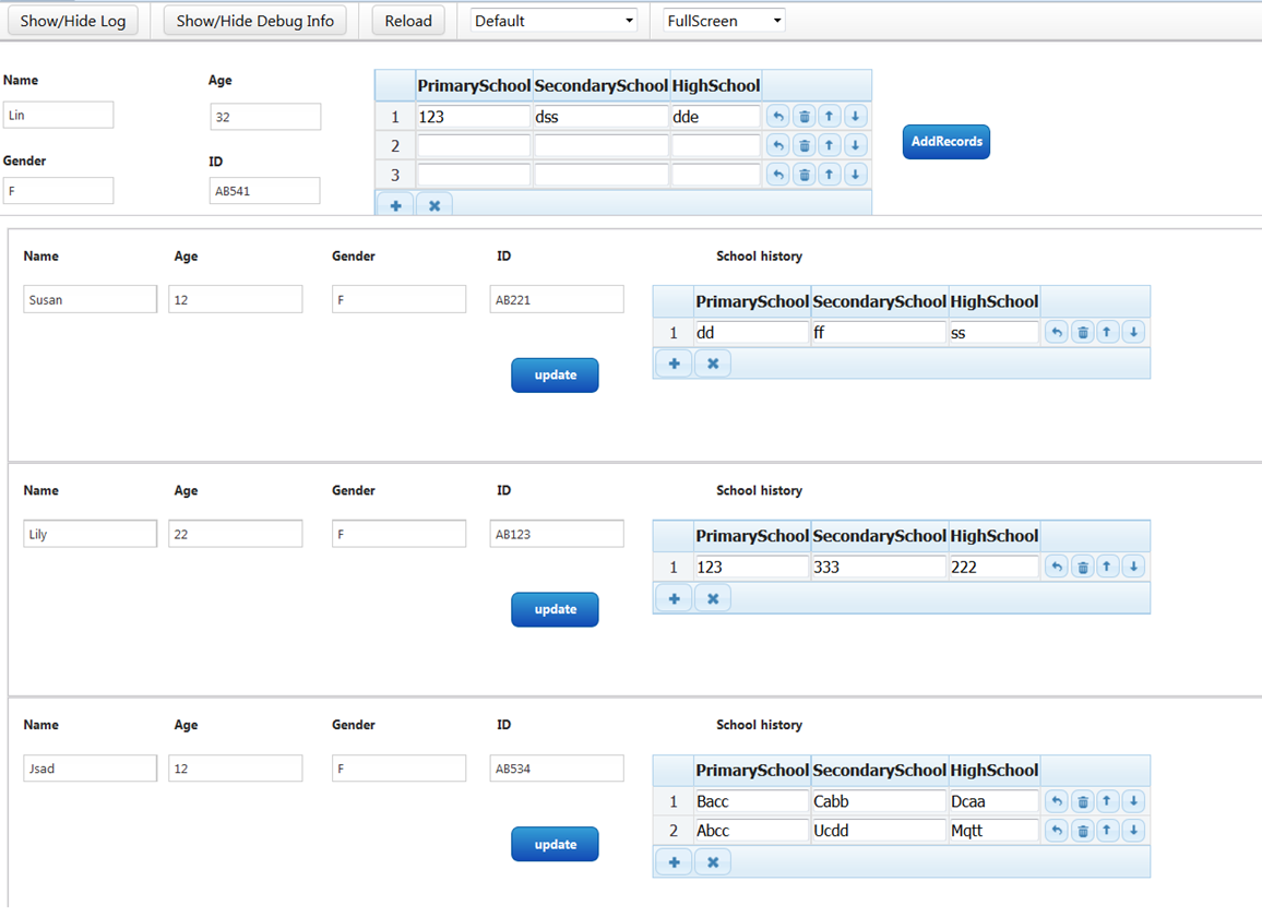

    • Testing the demo
    • Note: Smart Grid widget is not a ThingWorx OOTB functionality
