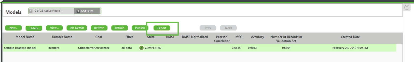

1. In Analytics Builder, click on the export button

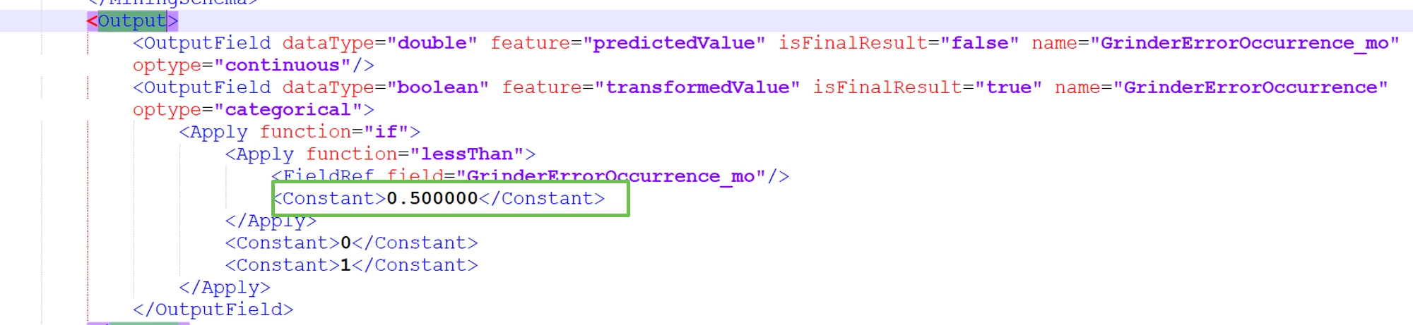

2. This will export a PMML model and download it for you
3. Open up the PMML model, in the output section, you will find a condition that explains the threshold that was selected by TWX Analytics.
In this example case, TWXA chose 0.5 as the best Threshold.
Note: The export button will only be available in Builder for TWXA 8.4+.
