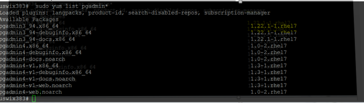

  1. Try running
yum list pgadmin*
​If you see something like this:
that means the package is available in the highlighted repository, you'd just need to add it.
rpm -Uvh http://yum.postgresql.org/9.4/redhat/rhel-7-x86_64/pgdg-redhat94-9.4-3.noarch.rpm
After that, try sudo yum install pgadmin3_94 (insert your actual version)
