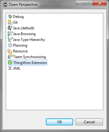

In a next step, you will want to create a new Extension Project. We added a ThingWorx Extension perspective that enables all of the custom functionality.
Once in the correct perspective, we tried to make our plugin as intuitive as possible. We did this by following as many of the Eclipse usability standards as we could, which means that if you are familiar with the Eclipse IDE you should be able to find most of the ThingWorx functionality on your own. For Example, a simple ‘File’ >> ‘New’ will show you all the options for creating a Project.
