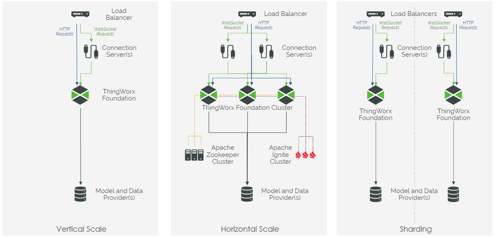

Vertical Scale - a.k.a. "one person carrying a bigger basket"
The most common scalability approach is to simply size the IOT server larger, or scale up the server. This might mean the server is given additional CPU cores, faster CPU clock speeds, more memory, faster disks, additional network bandwidth or improved network cards, and so on. This is a very good idea
when the application logic is increased in complexity, when more data is therefore needed in memory at a time, or when the processing of said data has to occur as quickly as possible. For example, adding additional devices to the fleet increases the size of the “Thing Model” in the process and will require additional heap memory be available to the Foundation server.
However, there are limitations to this approach. Only so many concurrent operations and threads can be performed at once by a single server. Operations trying to read and write to the disks at once can introduce bottlenecks and reduce server performance. Likewise, “one person, one basket” introduces a single-point-of-failure operating risk. If for some reason the server’s performance does degrade or cease altogether, then all of the “eggs” go down with it. Therefore, this approach is important, but usually not sufficient on its own for empowering an enterprise level deployment.
Horizontal Scale - a.k.a. "one person, with two or more baskets"
imageAs of ThingWorx version 9.0, Foundation servers can be deployed in clusters, meaning more baskets to carry the eggs. More baskets means that if even one of these servers is active, the application remains up in the event of an individual node failure or maintenance. So clustered deployments are those which facilitate High Availability.

Sharding - a.k.a. "more than one person carrying baskets"
image“Sharding” generally refers to breaking up a larger IOT enterprise implementation into smaller ones, each with its own configuration and resources. More server maintenance and administration may be required for each ThingWorx implementation, but the reduction in risk is worth it. If each of the use cases mentioned above has its own implementation, then any unexpected issues with the more complex, analytical logic will not affect the reaction time of operators to time-sensitive matters in the other use case. In other words, “don’t keep all your eggs in one basket”.

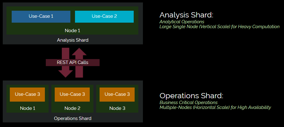

Another benefit to sharding is the focused investment of server resources in a more targeted way. For instance, if one region is larger than another, it may need more CPU and memory. Or, perhaps only part of an application requires High Availability, the time-critical use cases which are best suited to small, clustered deployments. The larger, analysis-centered use cases can then remain non-clustered (but still vertically scaled of course). Sharding can also make access control simpler, as those who need access to only one region or use case can just be given a user account on that particular shard.
However, certain use cases need data from more than one shard in order to operate, turning the data storage and access control benefits into challenges. Luckily, ThingWorx has an excellent toolkit for overcoming such issues. For one thing, REST API calls are readily available in ThingWorx, allowing each shard to exchange information with each other, as well as other enterprise data systems, like ERP or Service Ticketing. Sometimes, lower-level data replication strategies are the way to go, say if downsampling or data transfer from one store to another is necessary, and built-in database tools can more easily handle the workload. Most of the time, however, REST API calls are used to define the business logic within the application layer so that copying data actively between shards is unnecessary, using fewer resources to control what information is shared overall.
There are several design approaches for REST API communication between shards, the two most common being the “peer” model and the “layered” model. In a peer model, one shard may call upon another shard using REST whenever it needs more information. In a layered model, there are “front-line” shards which handle most (if not all) of the device communication and time-critical use cases, things which require only the information in one shard to operate. Then there are also “back-line” shards that aggregate data from the many front-line shards, performing any operations that are less time-sensitive and more complex or analytical.
