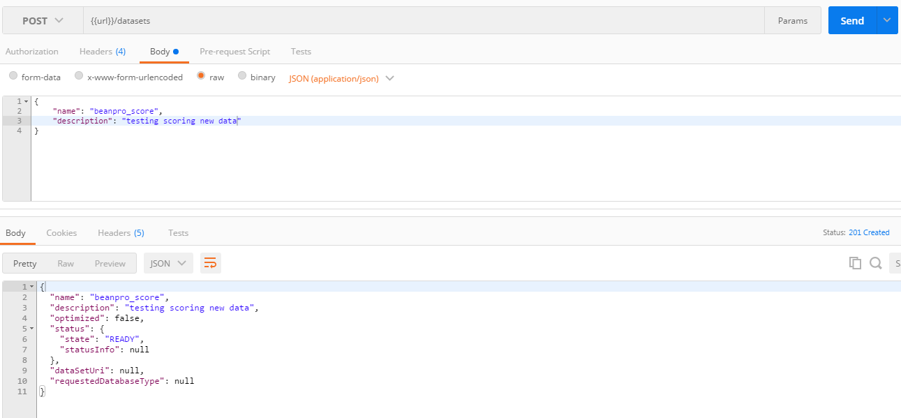

  1. Create a dataset
    • This example uses the beanpro demo dataset
    • Create dataset is done through a POST on datasets REST API as below

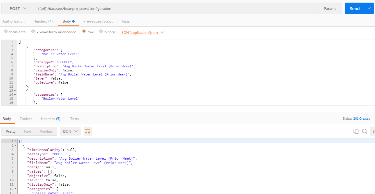

2. Configure dataset
    • This is done through a POST on <dataset>/configuration REST API

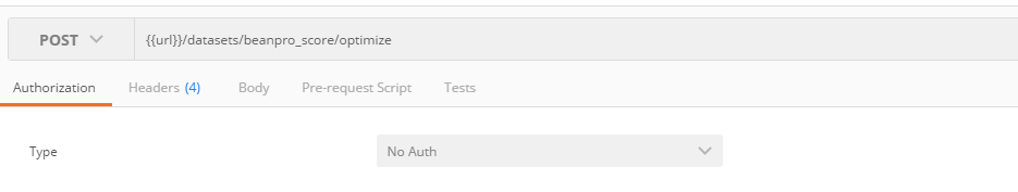

4.      Optimize the dataset

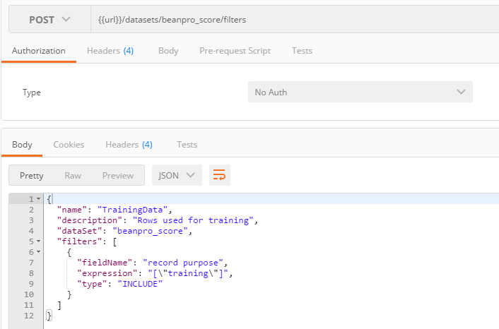

5.      Create filters
    • The dataset includes a feature named record purpose created especially to differentiate between the rows to be used for training and the rows to be used for scoring.

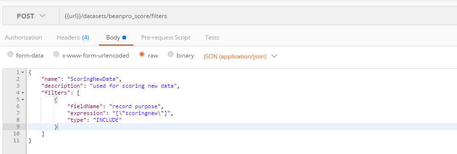

    • New data to be added will have record purpose set to scoringnew, which will allow to execute a scoring job limited to those filtered new rows
    • Filter for training data:
    • Filter for new scoring data

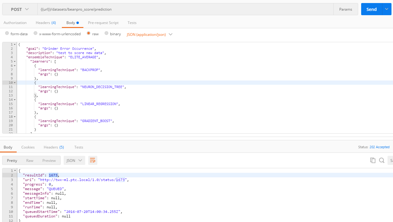

6.      Train the model
  • This is done through a POST on <dataset>/prediction API

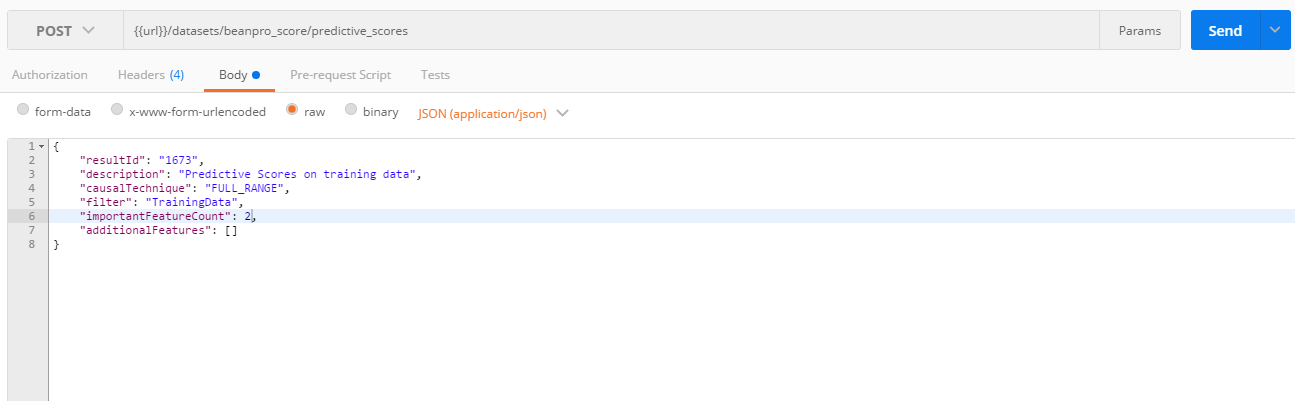

7.      Score the training data
    • This is done through a POST on <dataset>/predictive_scores API.
    • Note the use of the filter TrainingData created earlier.
    • This allow to score only the rows with training as value for record purpose feature.
    • Note: scoring could also be done without filter at this stage, in which case all the data in the dataset will be scored and not just the ones with training fore record purpose

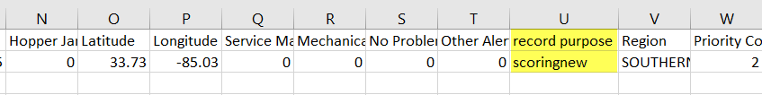

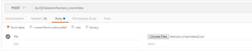

8.      Upload new data
    • The newly uploaded csv file should only contains new record.
    • This will be appended to the existing ones.
  • Note that the new record (it could be more than one) has a value scoringnew for the record purpose feature:
  • This will allow to use the previously created filter ScoringNewData so that a new scoring job will only take into account this new record.

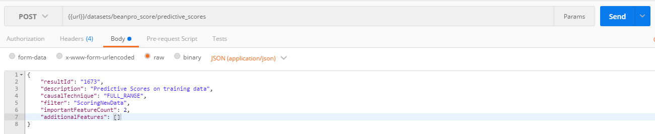

9.      Scoring new data
    • A POST on API predictive_scores is executed however using the filter ScoringNewData.
    • This results in only the newly added data to be scored and therefore a much quicker execution time too.

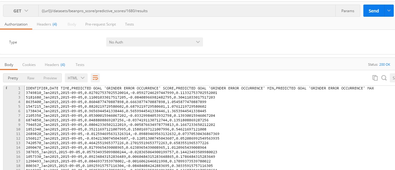

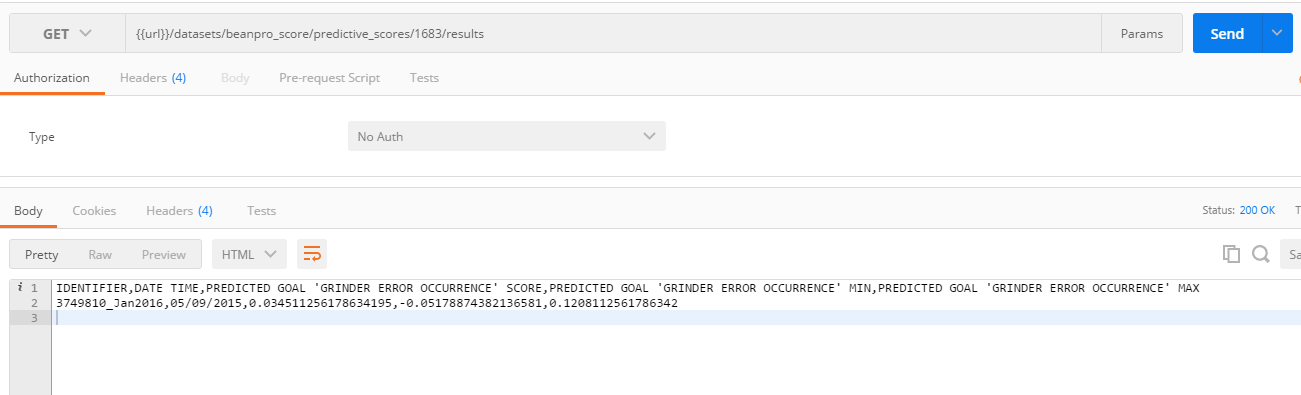

    • Retrieving the scoring result shows only the new record:

The above solution  had resolved the issue. However, as a beginner I am finding very difficulty to know the result as explained in step 9. What are these variables PREDICTED GOAL 'CONDITION' SCORE, PREDICTED GOAL 'CONDITION' MIN, PREDICTED GOAL 'CONDITION' MAX. What does they say. Can you please also share with us training and testing files. It will be really helpful for beginner to know all these parameter.
Azim
cmorfin19-TanzaniteAuthor
September 8, 2017
Hi Azim
The PREDICTED GOAL 'CONDITION' SCORE is probable the one you want to look at if you want a single value
PREDICTED GOAL 'CONDITION' MIN, PREDICTED GOAL 'CONDITION' MAX represent the range into which the predicted value can fall (remember this is using machine learning ie statistics  ).  Article Viewer | PTC might help here.
