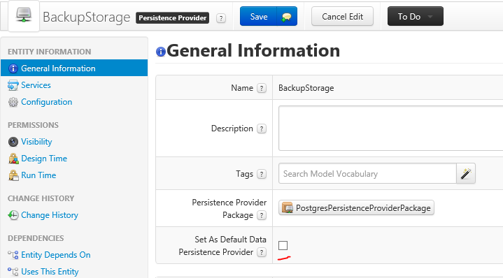

    • Go to Thingworx composer, create a new Persistence Provider in the Home list
      • Give it a new name, and select Persistence Provider Package(only one choice)

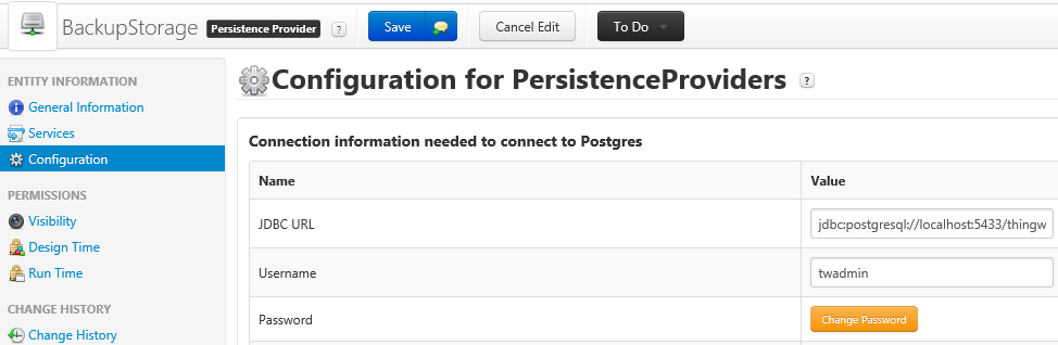

      • After selection, a Configuration field will show up in the ENTITY INFORMATION field ( such field will not appear in Neo4j based Thingworx)
      • Open Configuration and change the JDBC URL to jdbc:postgresql://localhost:5433/thingworx, update Password, click Save
    • The new Persistence Provider can be used in data storage entities nowUser-added image
    • The new Persistence Provider can also be set as default provider
