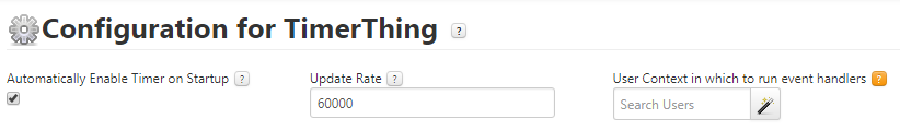

Configuration
  • The Timer Configuration is quite straightforward. It can be accessed via the Thing's Entity Configuration.
  • Configuration allows for
    • Enabling the Timer on Thing-Startup - whenever the Thing is started, e.g. when restarting ThingWorx or via the RestartThing Generic Service, also the Timer is enabled and will fire Events.
    • Changing the Update Rate - in which intervall the Events will be fired (by default every minute [60000 milliseconds]).
    • Changing the User Context - in which the Events will be handled. The user will need visibility and permission on e.g. executing Services or depending Things, which are required to run the Service triggered by the Event.
