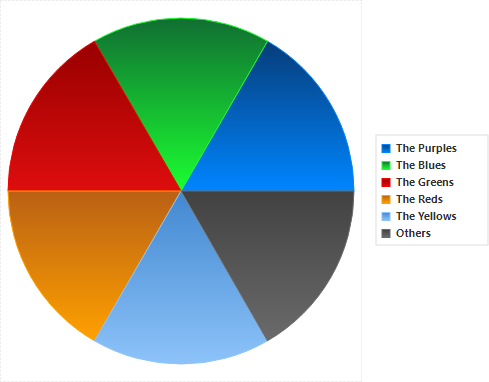

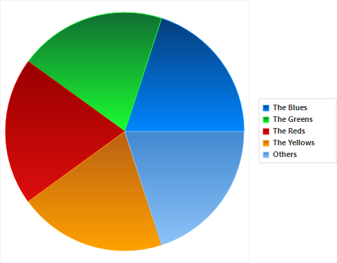

Just take a look at the following example with the default color schema. Let's just take political parties - as they are usually associated with a distinct color - to illustrate how the default color schema will fail depending on the data displayed.
In the first example, just by sheer coincidence the colors are perfectly matching the parties. When introducing a new party to the pool suddenly the blues are rendered green and the yellows rendered light-blue etc. This can be quite confusing, especially on election night 😉

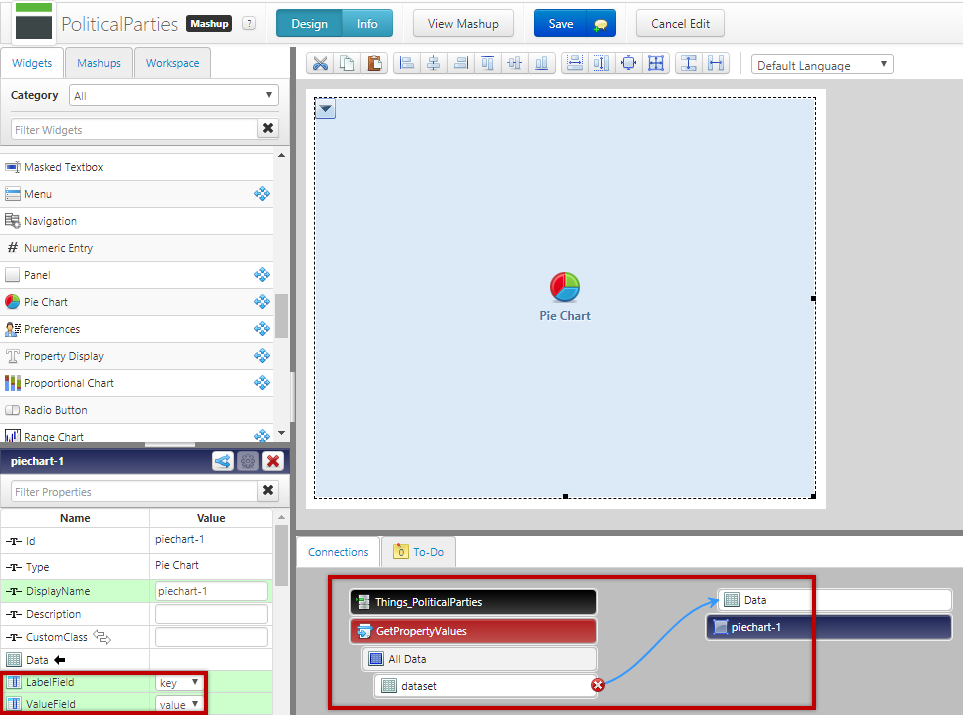

Create a new Mashup and add a PieChart to the canvas.
Bind the PoliticalParties > GetPropertyValues > dataset to the Data input of the Widget.
Ensure to set the LabelField to key and the ValueField to value for a correct mapping.
Save the Mashup and preview it.
It should show a non-matching color for each party listed in the InfoTable.

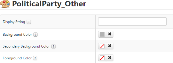

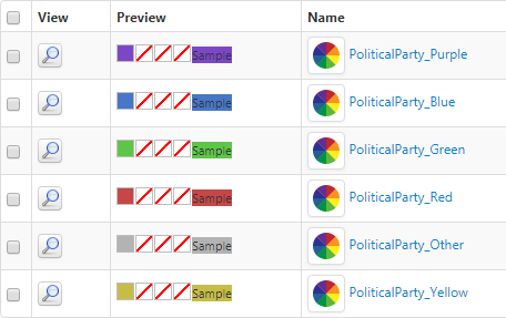

Create new custom Style Definitions for each political party.
As the Pie Chart is only using the Background Color other properties can stay on the default.
I chose to go with a more muted version of the colors to make the chart easier to look at.

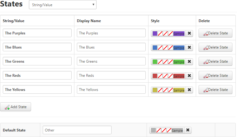

With the newly defined colors we can now generate a new State Definition as follows:
The States allow to evaluate the key-Strings in the Thing's InfoTable and assign a Style Definition depending on the actual value. In this definition we map a color schema based on the InfoTable's key-value to create a 1:1 mapping for the Strings.
This means, no matter where a certain party is positioned in the chart it will be tinted with its associated color.

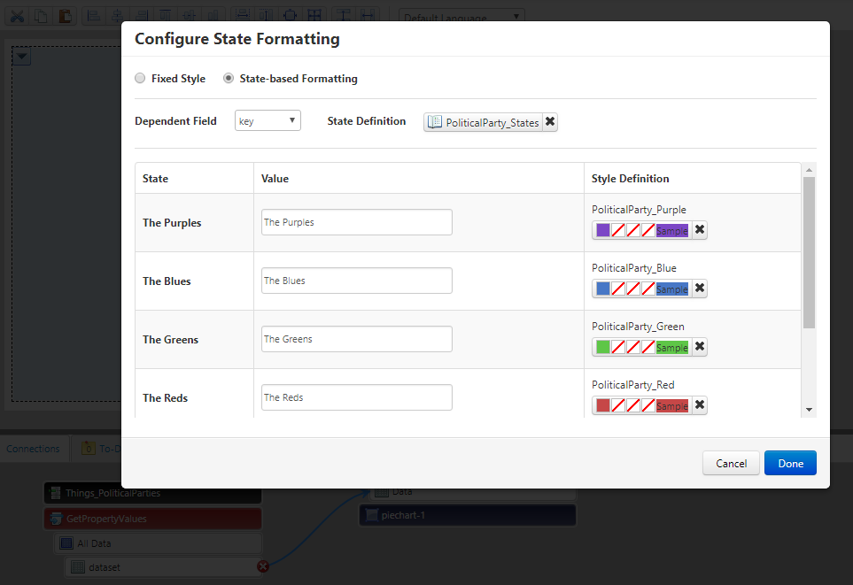

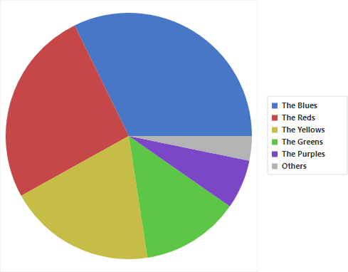

Back in the Mashup, select the PieChart.
In the ColorFormat property choose the newly created State Definition.

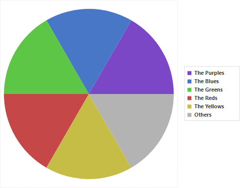

With the States and Styles applies, colors are now displayed correctly.
Even when changing positions and numbers in the original InfoTable of the PoliticalParties Thing, the chart now considers the mapping of Strings and still displays the colors correctly.
