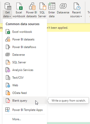

1. In Power BI, create a new blank query

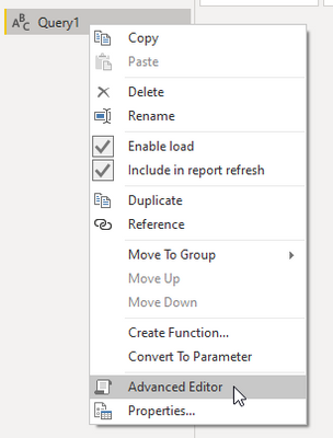

2. On the left, right click on Query1 and go to the Advanced Editor:
3. Replace all of the body content with the following, replacing your API key, appropriate end point, and base URL as needed (this is an example with NO input parameters, I'll follow with examples of other parameters):
let
 appKey = "your-application-key-here",
 endpoint = "Things/YourThingNameHere/Services/YourServiceNameHere",
 baseUrl = "https://YourServerNameHere/Thingworx/",
 url = Text.Combine({baseUrl,endpoint}),
 body = "",
 request = Web.Contents(
 url,
 Headers = [
 appKey = appKey,
 #"Content-Type" = "application/json",
 Accept = "application/json"
 Content = Text.ToBinary(body)
 Source = Json.Document(request)
in
 Source
