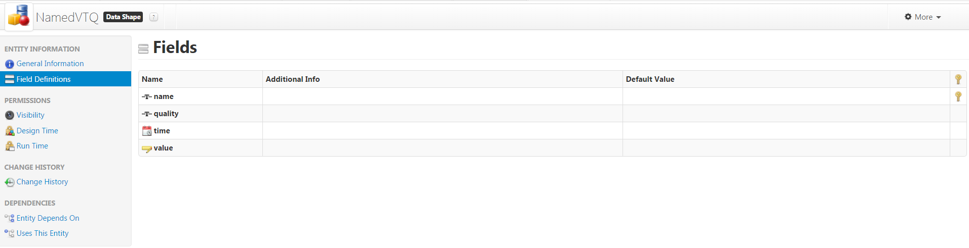

Let us consider that we have 2 properties Property1 and Property2 in Thing Thing1 which we want to update using UpdatePropertyValues service.
  1. In our service we will use a system defined DataShape NamedVTQ which has following field definitions:
  2. In Thing1 create a custom service like following:

This DataShape exists in ThingWorx as "NamedVTQ".
