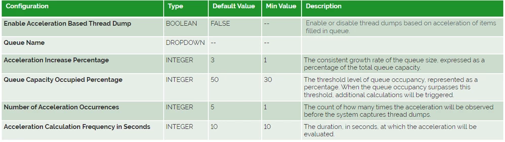

Acceleration-Based Monitoring
This is an extremely cool new feature in ThingWorx where the Platform monitors itself for runaway queues, those which indicate a system malfunction in the event or value stream queues for instance. If the acceleration is high enough for that queue, the Platform will automatically generate stack traces. This ensures the diagnostic data is already on the disc if and when the issue progresses to an outage.
No more do diagnostic SMEs have to sit and wait for a problem to occur again before they start investigating! Now they can download the stack traces that the Platform already stored on the disc.
Of course, it’s really important to get this feature configured right. If thread dumps are taken too often, those associated with the root cause may be purged before a tech can look more closely; only 10 thread dumps at a time are stored on the disc to prevent it growing out of proportion. On the other hand, if it does not take thread dumps often enough or in response to the right kinds of acceleration readings, then the root cause may altogether not be captured.
For this reason, there are several parameters to use to configure this feature, one being the acceleration increase percentage, considered very significant and a potential sign of trouble within the queue. This value is a flat percentage calculated at the time of measurement: queue count / total size of the queue. This number is checked frequently, as configured by another parameter, the acceleration calculation frequency. If the queue size exceeds the queue capacity occupied percentage at the same time the increase percentage is above the threshold, then the Platform records a stack trace on the disc. This ensures the diagnostic data will be present even after a restart, from early on when the problem began.
Another key parameter is the number of acceleration occurrences to wait before turning the thread captures on, which allows for a great specificity of when to collect the diagnostic data. Even if the acceleration is met once, well maybe that means nothing; perhaps it is normal for the queue to accelerate quickly at times. However, let’s say it does it 5 times within 30 seconds or a minute, or maybe the acceleration is elevated for some time, and we are approaching a data loss scenario. A rule based around the first scenario will capture close to the root cause, while the second might serve to collect what events didn’t make it into the queue before the restart.
Once the thread dumps are taken, there is a configurable cool off period in which no new stack traces will be recorded. This can allow the stack traces to be taken repeatedly at set intervals for persistent issues, and also reduces the overall activity of recording stack traces to ensure only the most useful ones remain on the disc.
One of five queues can be monitored in this way:
  • Persistent Property Queue
  • Event Processing Queue
  • Stream Processing Queue
  • Value Stream Processing Queue
  • Connections Pool Processing Queue
An example of setting all of these values can be found along with more information in the Help Center.
