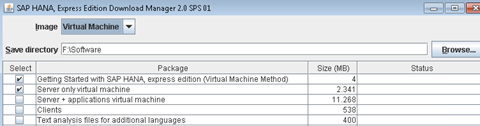

SAP Hana Express Edition 2.0 is freely available from SAP via the download with a pre-built machine with SUSE Enterprise OS. For this blog I used the SAP Hana Express Edition 2.0 Server only version while downloading the pre-built VM from SAP
  1. Download the Server only or Server + Application VM from the SAP's website
     2. Unzip and open the hxe.ova (file name will differ if you are downloading the server + application VM) file in one of the hyper-visor, in my case I'll be using VMWare Workstation, but should work just fine with others e.g. Oracle VirtualBox

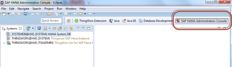

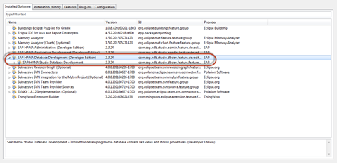

For this blog I created everything manually that is by connecting via the client which i have installed as plugin in my existing Eclipse Mars. If you are running different version of Eclipse check this link
If you are also using the Eclipse Mars you can use this link in Eclipse > Help > Install New Software > https://tools.hana.ondemand.com/mars/
Once installed make sure to restart the eclipse and open the SAP Hana Administration Console perspective, which should come up something like this:
Since I have already installed and created some connections to the DB they are visible on the left side of the Eclipse.

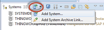

     1. Navigate to the Systems tab on the left in the SAP Hana Administration Console perspective in Eclipse
     2. Click on the Add Systems icon located right on the Systems tab, like so

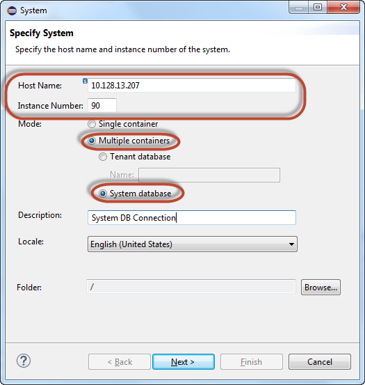

     3. Provide some basic connection details like
          a. Host Name: IP or machine name of the VM running the SAP Hana Express edition
          b. Instance Number: 90
          c. Mode: If you are using free express edition as I have used for this blog you will be required to select Multiple containers. As soon you will see that we will create ThingWorx as tenant DB alongside the System DB
          d. Select System Database since for now we have not yet created a database called ThingWorx. Click next.

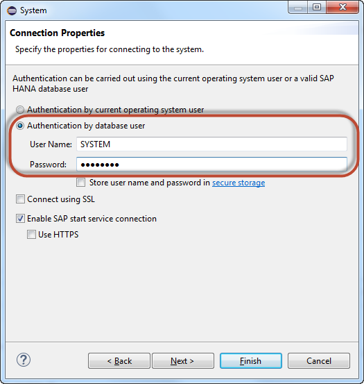

     4. On the next page provide the username/password, i will be logging in as SYSTEM user since I have not yet created any other user and I'll use the master DB password which I'd set when      configuring the VM for the first time.
     5. Click Finish to complete and test the connection

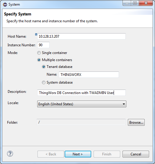

For creating a SQL connection using the newly created TWADMIN user follow the steps described in the section Creating Connection to the SAP Hana Database above. Here's how the configuration for connecting to the ThingWorx DB will look like
With this we are now connected to an empty THINGWORX database under which TWADMIN schema will be created using the SQL scripts provided in the install directory of ThingWorx-Platform-Hana-X-X-X.zip package. Note that it's important that below listed scripts are executed in following order

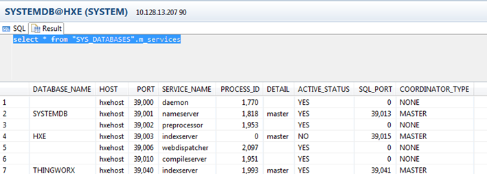

Checking the port for ThingWorx Database created in SAP Hana
This can be checked by executing the following command directly from the SQL Client in the Eclipse. You may need to execute this command using SYSTEM user account, if any permission objections are raised in the client
select * from "SYS_DATABASES".m_services
This will return the result of all the databases and services with their port, check the SQL Port for the ThingWorx database :
