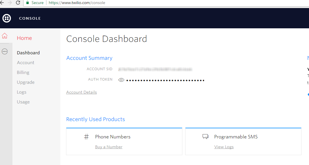

Navigate to your account details on Twilio.com to make note of the following information which will be used when configuring the Twilio Extension in ThingWorx:
a. Account SID
b. Authentication ID
c. Your Verified Phone Number (will be used for receiving the messages)
d. Twilio Phone number created with required capabilities, e.g. that number is capable of sending text message
Here's how it shows up once you are successfully registered and logged on to the twilio.com/console

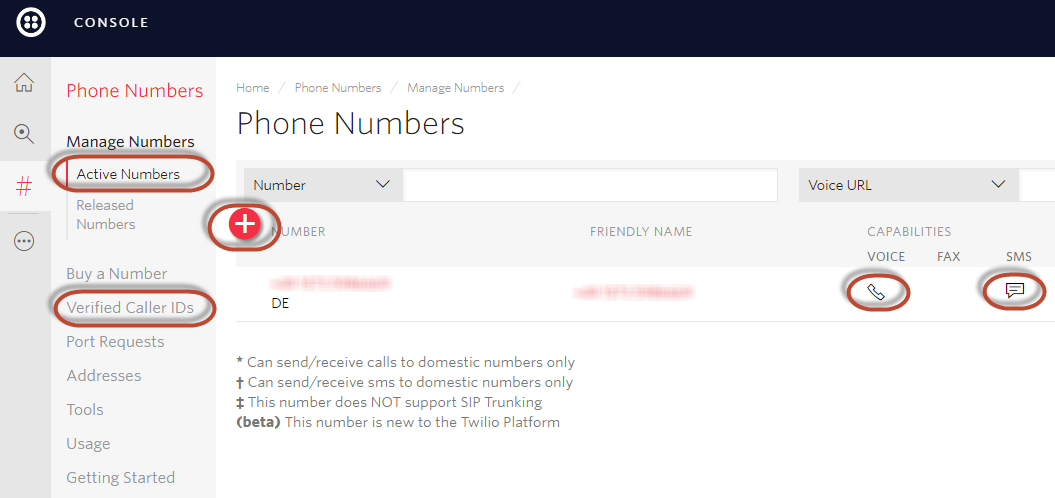

To check your Twilio Phone Number and the Verified Phone Number navigate to twilio.com/phone-numbers
As it can be seen in the above screenshot, the number I have bought from Twilio is capable of sending Voice and SMS. With this all's set  and ready to configure the Twilio Extension in ThingWorx, which is pretty straight forward.

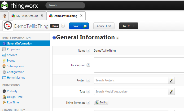

2. Once imported successfully refresh the composer and navigate to Modeling > Things , to create a new Thing implementing the Twilio Template (imported with the extension) like so, in screenshot below Thing is named DemoTwilioThing

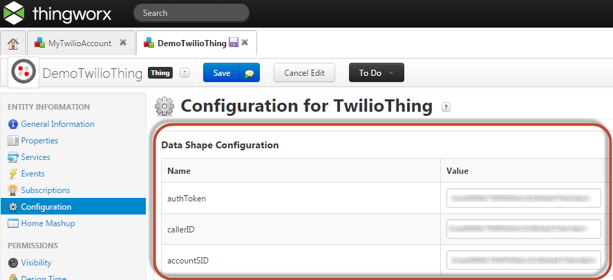

3. Navigate to the the Configuration section of that Thing, to provide the information we noted above from Twilio account
Note: this demo thing is setup to send the text SMS to my verified phone number only, therefore the CallerID in the configuration above is the Twilio number I created after signing up on Twilio with text message capability.

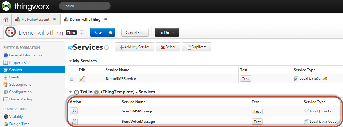

5. Finally, we can test with the 1 of the 2 default services provided with the Twilio Template i.e. SendSMSMessage service
6. While testing the SendSMSMessage service use your verified phone number in To for receiving the message

Navigate back to the Phone Number section on Twilio's website and as highlight in screenshot above check if the Twilio number is enabled with SMS capabilities.
