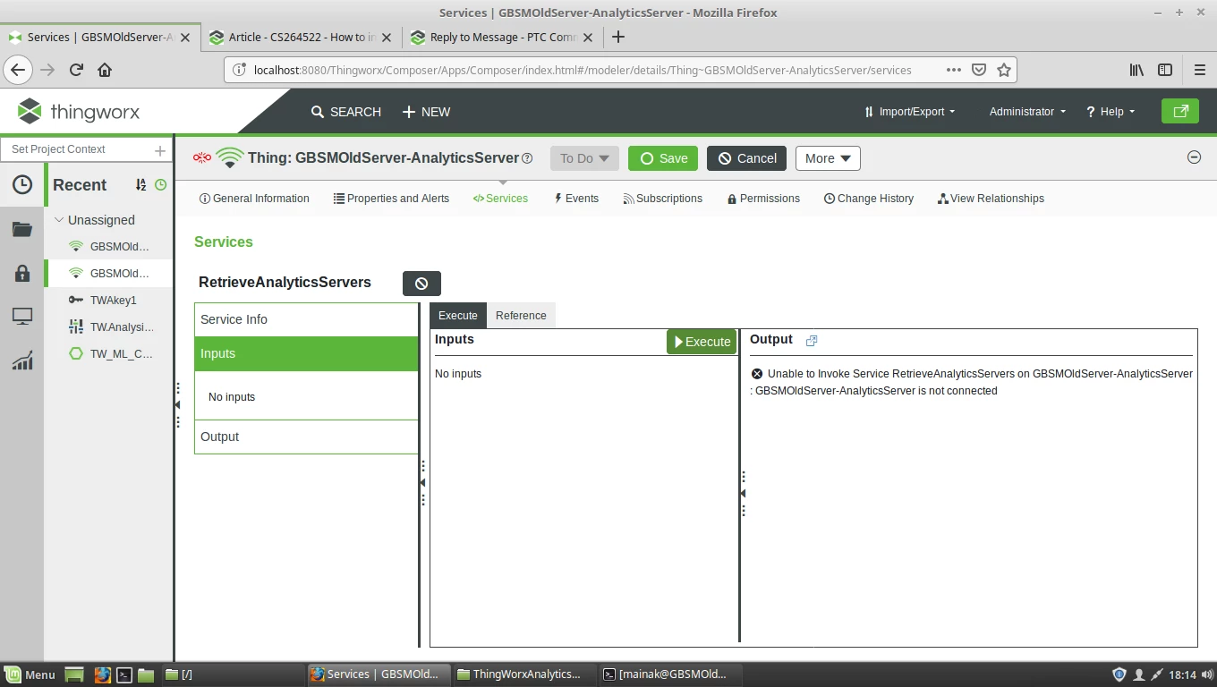

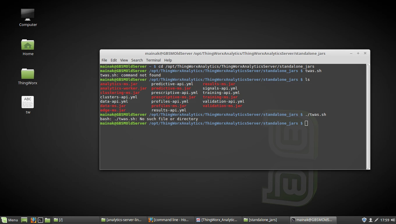

I have installed the thingworx analytics in which descriptive analytics was not installed. Then I followed the installation manual pdf and then  I am unable to proceed due to this error.imageAfter running the twas.sh commandimageRetrieveAnalyticsServers service error
please guide on how to proceed forward.
