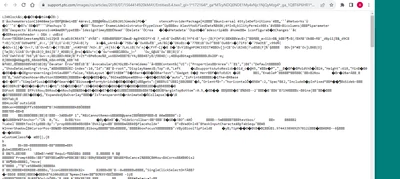

Hi @cmorfin ,
I already tried it, but this is what happened i clicked the link under the last video,
cmorfin19-TanzaniteAuthor
Oct 30, 2023 4:12 PM UTC
Hi @A_10333884  indeed it seems to be an issue with Chrome, it works ok for me in Firefox.
In Chrome, instead of clicking the link, right click on it and select Save As. Then change the extension of the file to twx instead of txt.
You should then be able to import this file in ThingWorx.
