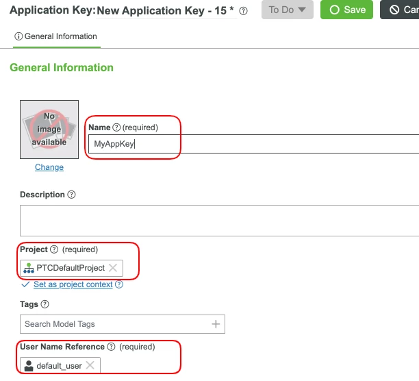

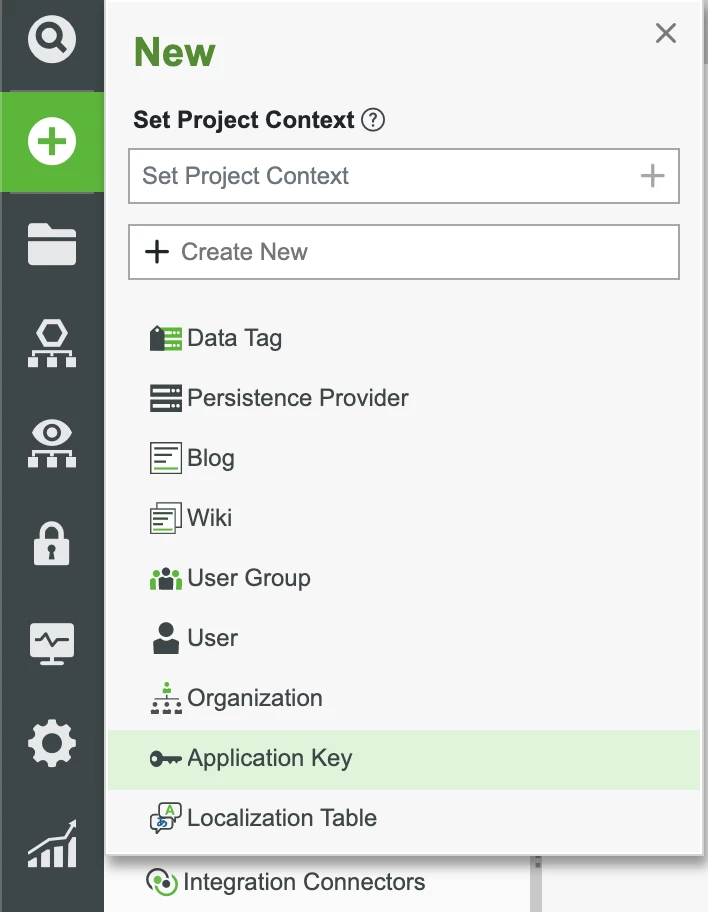

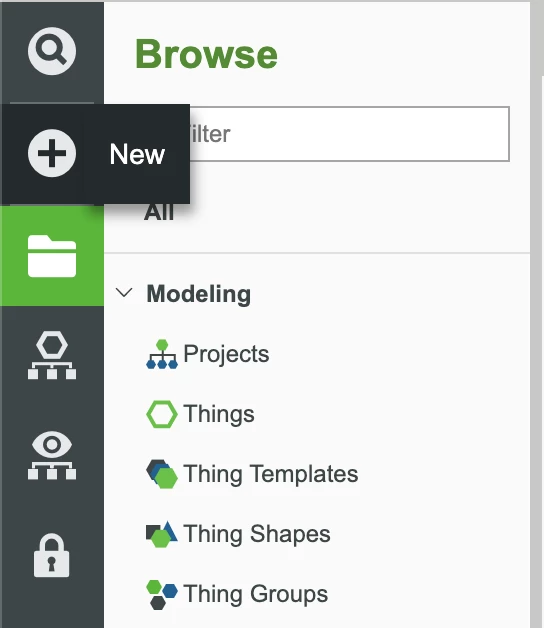

  1. On the Home screen of Composer click + New the top left.
  2. In the dropdown list, click Application Key.
  3. Give your Application Key a name (i.e., MyAppKey) and set the Project (ie, PTCDefaultProject).
  4. Assign the application key to a User.
  5. Click Save.

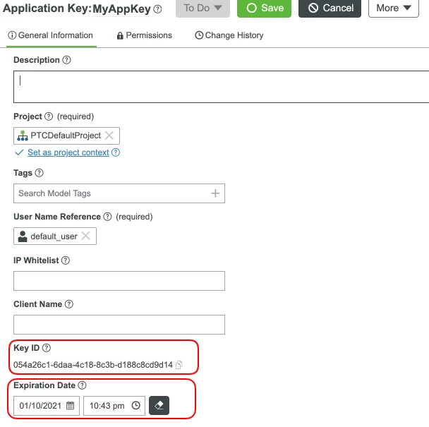

After saving, a Key ID is generated and appears above the Expiration Date. This is the secret key that you will use to make secure connections. If you have not updated the Expiration Date field, the default will be one day.
This is an example of the Application Key ID that you will use for a successfull connection.
NOTE: Using the Application Key for the default Administrator is not recommended. If administrative access is absolutely necessary, create a User and place the user as a member of Admins.

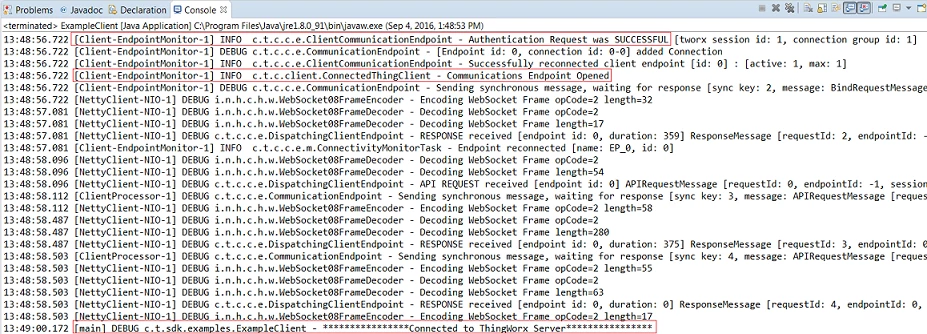

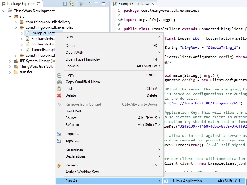

Compile and Run Code
  1. Right-click the SimpleClient.java file.
  2. Scroll to Run As then select Java Application.
    The output in the Eclipse console will confirm connection and authentication to the ThingWorx platform.

  4. Right-click ExampleClient.java, scroll to Run As, and select Java Application.
  5. You should be able to see a new Thing in your Composer called SimpleThing_2.

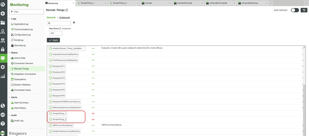

To check the connected Entities, go to the Monitoring screen.
  1. Click Monitoring.
  2. Click Remote Things from the list to see the connection status.
  3. You will now be able to see and select the Entity within the list.
    NOTE: SimpleThing_1 and SimpleThing_2 will also have an update to the lastConnection property. While SimpleThing_1 is unbound, SimpleThing_2 is bound for the duration of the application run time.
