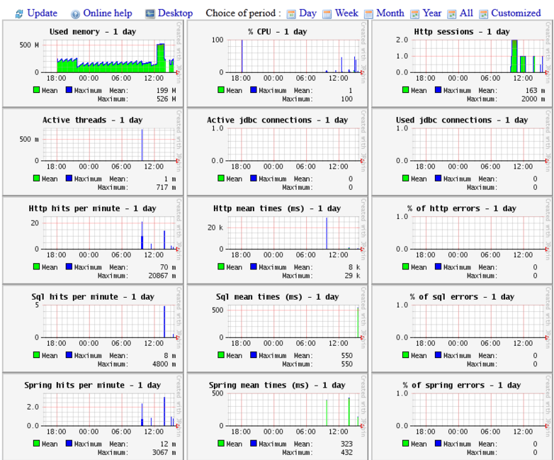

JavaMelody is an open source (LGPL) application that measures and calculates statistical information based on application usage. The resulting data can be viewed in a variety of formats including evolution charts, which track various operations and server attributes over time. There are also robust reporting options that allow data to be exported in either HTML of PDF formats.

The url can be customized in the configuration file. Reports can be viewed in weekly, daily, or monthly formats. They can also be downloaded or can be sent over email in pdf format. iText library for WebApps and Java’s Mail and Activation libraries are required on the server in order to use the mail session. The report provides the same information that can be found in monitoring web page with both high-level and detailed information.

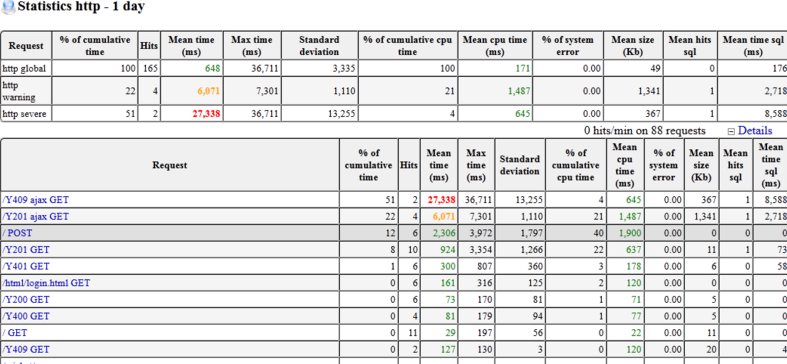

CPU&Memory usage:

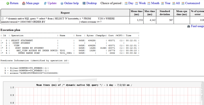

Detailed SQL Information:

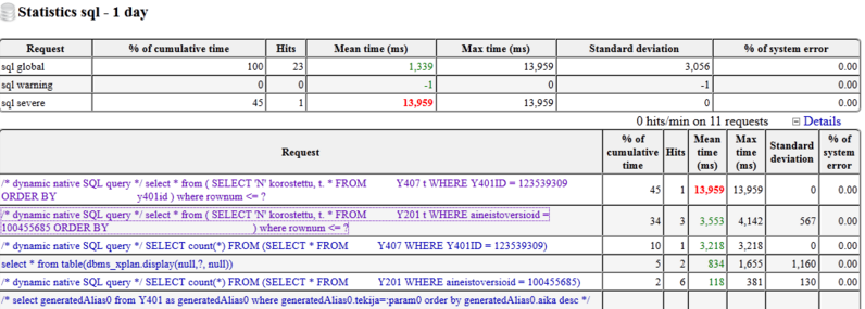

SQL Statistics:

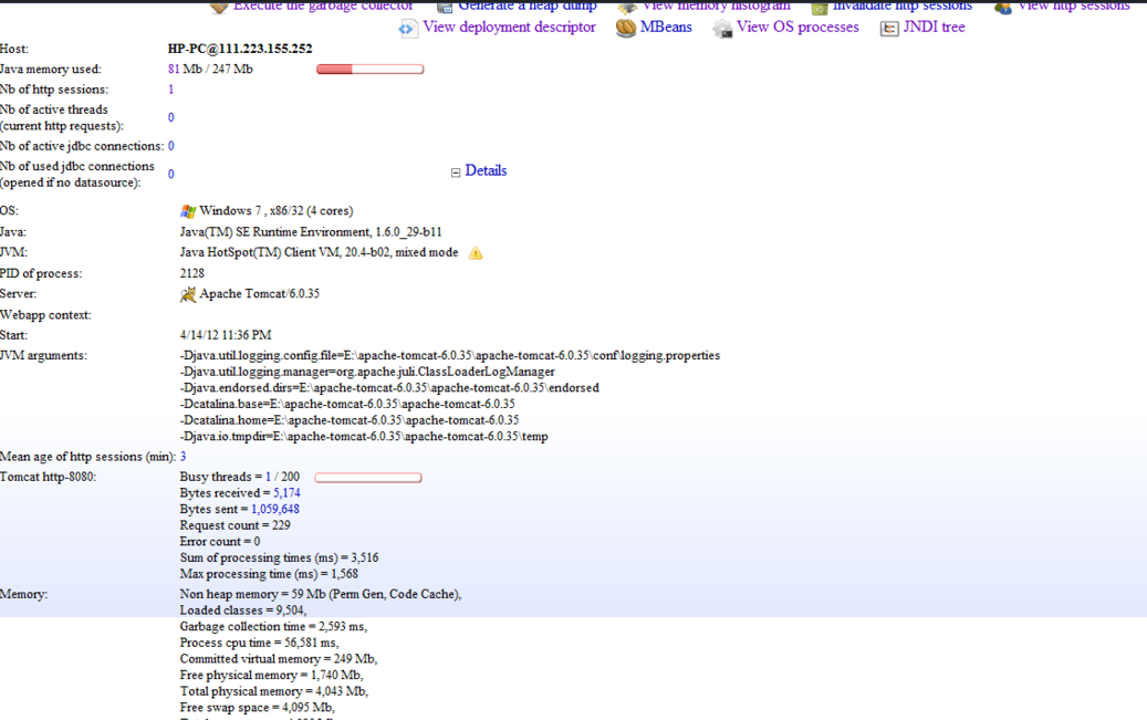

Server Requests:

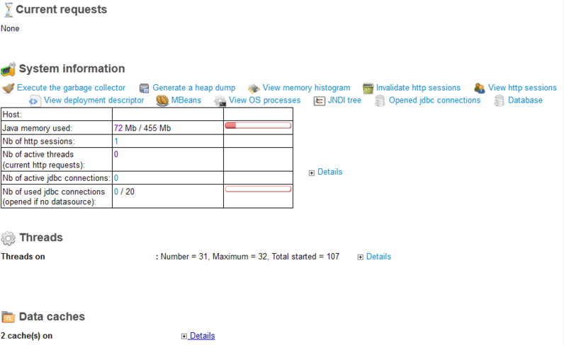

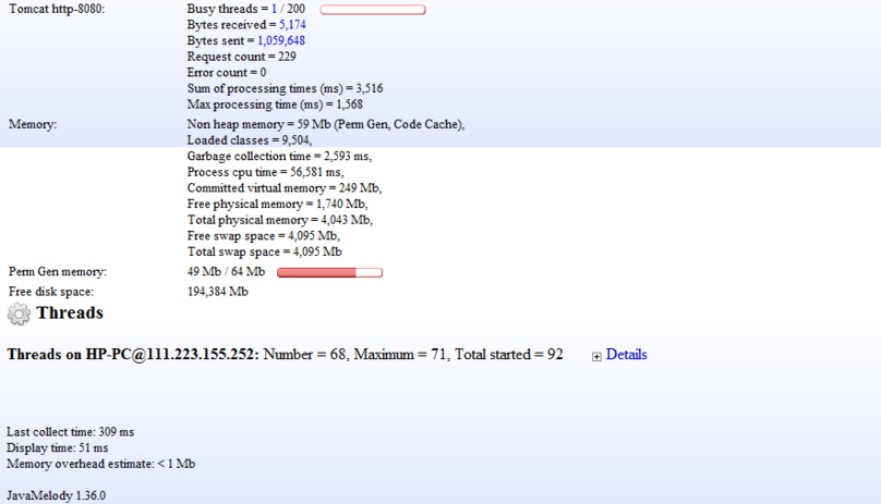

System threads, caches:

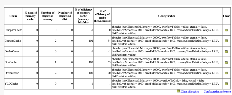

Data Caches:
System Overhead
