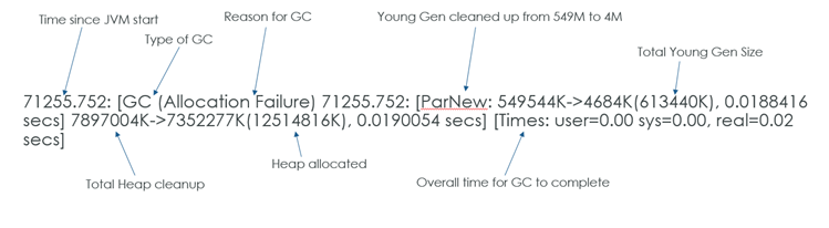

Generally each memory cleanup operation is printed like this:
Additional information on specific GC operations you might see are available from Oracle.

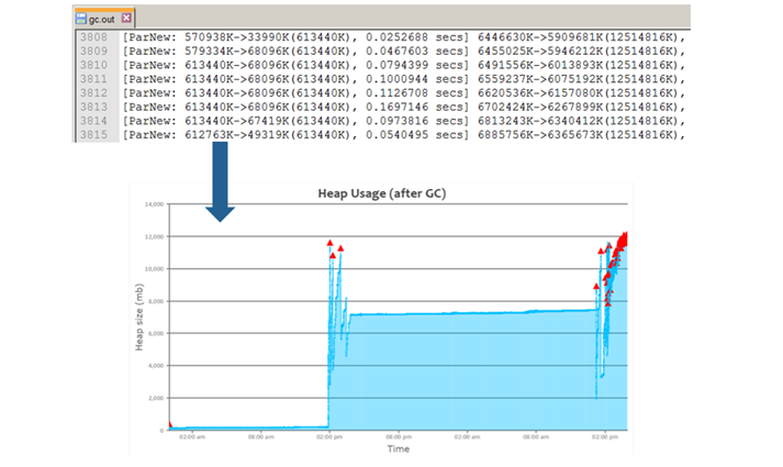

A GC analysis tool will convert the text representation of the cleanups into a more easily readable graph:

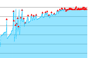

Full GC Loop: Full GCs occurring in quick succession are referred to as a Full GC loop
  • If the JVM is unable to clean up any additional memory, the loop will potentially go on indefinitely
  • ThingWorx will be unavailable to users while the loop continues
  • Example – four consecutive garbage collections take nearly two minutes to resolve:
16121.092: [Full GC: 7341688K->4367406K(8482304K), 38.774491 secs]
16160.11: [Full GC: 4399944K->4350426K(8482304K), 24.273553 secs]
16184.461: [Full GC: 4350427K->4350426K(8482304K), 23.465647 secs]
16207.996: [Full GC: 4350431K->4350427K(8482304K), 21.933158 secs]
     Example – the red triangles occurring at the end of the graph are a visual indication that we're in a full GC loop:

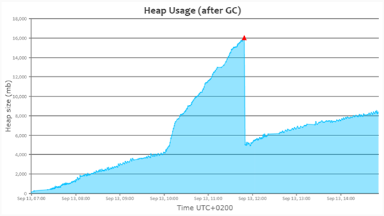

Memory Leaks: Memory leaks occur in the application when an increasing number of objects are retained in memory and cannot be cleaned up, regardless of the type of garbage collection the JVM performs.
  • When mapping the memory consumption over time, a memory leaks appears as ever-increasing memory usage that’s never reclaimed
  • The server eventually runs out of memory, regardless of the upper bounds set
          Example(memory is increasing steadily despite GCs until we'll eventually max out):
