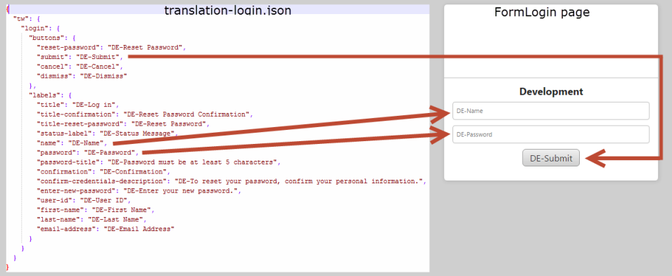

The FormLogin.jsp holds e.g. the token [placeholder]tw.login.labels.name
This is a placeholder (which means text to be overwritten in a textfield in case the textfield is empty).
The actual localization can be found in the translation-login.json going down the json object structure to "tw" > "login" > "labels" > "name" which results as Name in the English translation.
tw.login.labels.password-title would result in the following String: Password must be at least 5 characters

To create a custom language besides English, copy the en folder and rename it to the correct language short name, from Afar (aa) to Zulu (zu). A list of Language Code References can be found at https://www.w3schools.com/tags/ref_language_codes.asp
After copying the folder, open the translation-login.json and alter the resulting Strings into the correct language variant.
As soon as the correct translation-login.json is created, it will be considered for localization. No need to restart Tomcat.
