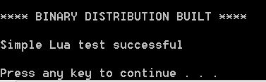

  7. Double click the "build.cmd" file
    • A console window will appear with installation details
    • If you see the following, then it worked successfully:
  8. The "lua\" directory will be created in the same folder as the "build.cmd" file

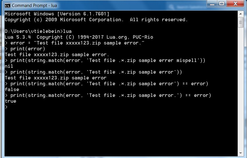

  15. Click "Ok" Open a new command prompt (has to be new to load the new path) and type "lua" to see if it works
  16. Example syntax test from Lua command line:
I hope this is helpful to people! Let me know if you have any questions!
