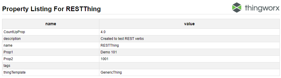

And I can now verify that the property has been updated for the Thing called RESTThing

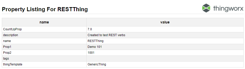

Verifying property update after the service invoke
