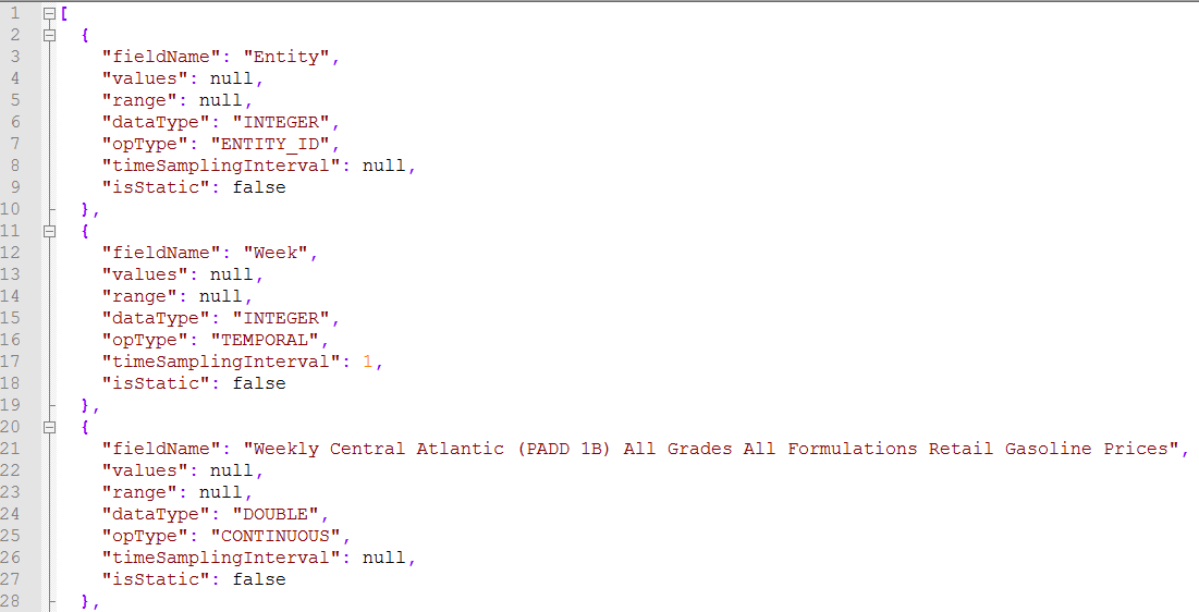

The image below provides an excerpt of what the metadata file itself will look like in practice.BP-1.PNG
The table below provides a definition for what each field in the metadata is and how it should be populated in your metadata file.
