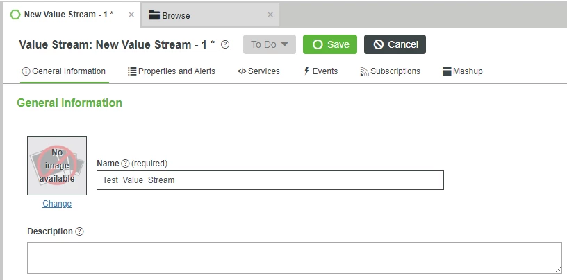

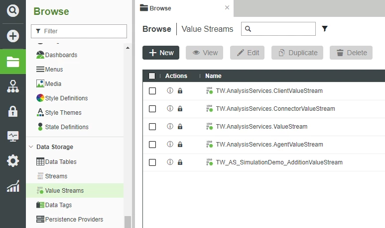

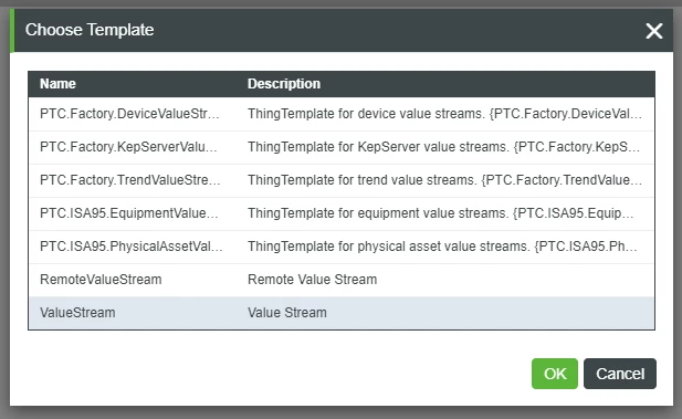

Create Value Stream
  1. On the ThingWorx Composer Browse tab, click Data Storage > Value Streams, + New.
  2. In the Choose Template pop-up, select ValueSteam and click OK.
  3. In the Name field, enter Test_Value_Stream
    Data3.png.
  4. If Project is not already set, search for and select PTCDefaultProject.
  5. At the top, click Save.

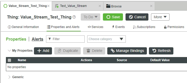

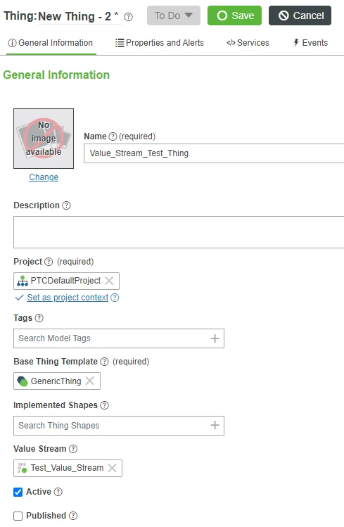

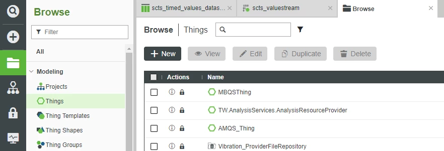

Create Thing
Since Value Streams must be tied to a Thing, we'll create one now and then attach the previously-created Value Stream.
  1. On the ThingWorx Composer Browse tab, click MODELING > Things, + New
  2. In the Name field, enter Value_Stream_Test_Thing.
  3. If Project is not already set, search for and select PTCDefaultProject.
  4. In the Thing Template field, search for and select GenericThing.
  5. In the Value Stream field, search for and select Test_Value_Stream.
  6. At the top, click Save.

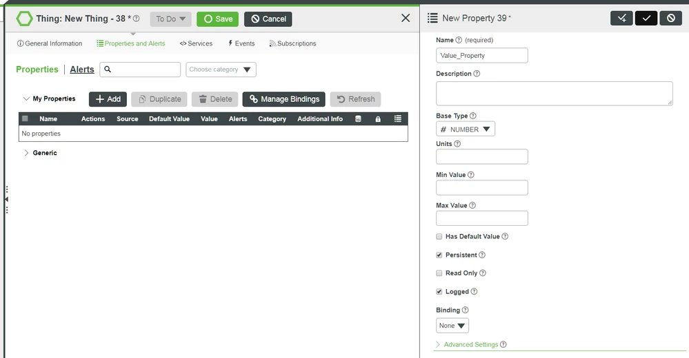

Create Property
Now that we have a Thing with an attached Value Stream, we'll create a Property of that Thing and set it to be Logged.
If a Value Stream is attached to a Thing, value-changes of all Logged Properties will get automatically recorded along with a timestamp.
  1. At the top, click Properties and Alerts.
  2. Click + Add.
  3. In the Name field, enter Value_Property.
  4. Change the Base Type to Number.
  5. Check the Persistent checkbox.
    • This causes the value of the Property to persist through system reboots.
  6. Check the Logged checkbox.
    • This causes all value changes to be logged to the attached Value Stream.
  7. At the top-right, click the "Check" button for Done.
  8. At the top, click Save.

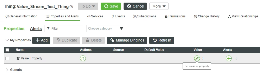

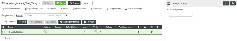

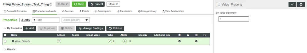

Set Property Values
In a real-world application, Property value changes would likely occur through a connection to a remote IoT device.
For simplicity, we'll instead manually change the values.
Because the Property is Logged and there is a connected Value Stream, each change will be recorded and timestamped.
  1. Under the Value column for Value_Property, click the "pencil icon" for Set value of property.
  2. At the top-right in the Set value of property field, enter 1.
  3. At the top-right, click the "Check" button for Done.

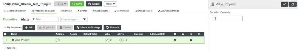

  4. Again, click the "pencil icon" for Set value of property.
  5. At the top-right in the Set value of property field, enter 2.
  6. At the top-right, click the "Check" button for Done.
  7. Again, click the "pencil icon" for Set value of property.
  8. At the top-right in the Set value of property field, enter 3.
  9. At the top-right, click the "Check" button for Done.
  10. At the top, click Save.

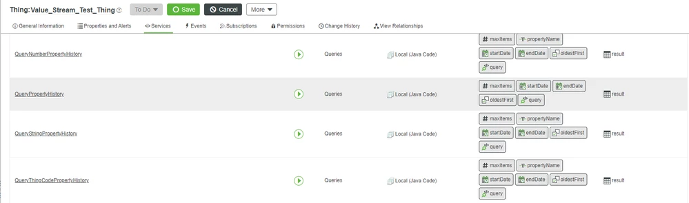

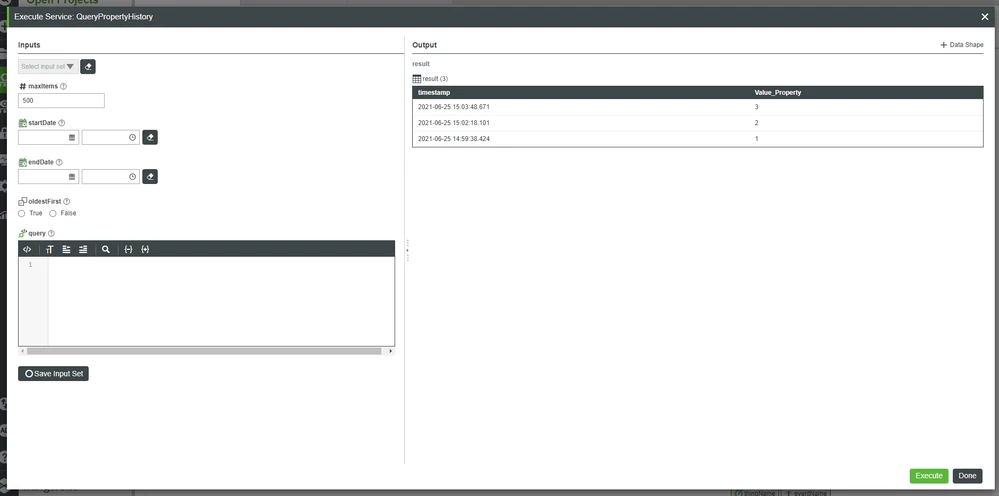

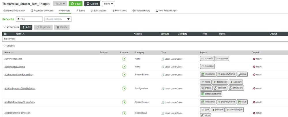

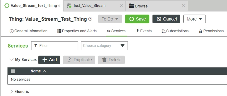

Retrieve Logged Values
One of the most common ways to retrieve time-series information is with the built-in QueryPropertyHistory Service.
QueryPropertyHistory may be used to retrieve logged value-changes for usage in a different, custom Service which could manipulate the data, as well as in Mashups for Widgets like a Grid or Line Chart.
  1. At the top, click Services.
  2. Expand the Generic section.
  3. Scroll down and find the QueryPropertyHistory Service.
  4. Click the "Play" button for Execute service.
  5. In the bottom-right of the Execute Service: QueryPropertyHistory pop-up, click Execute.
    • Note the previously entered values of 1, 2, and 3, as well as their associated timestamps.
  6. At the bottom-right, click Done.
A Value Stream is a simple and easy way to record all time-series changes of a particular Thing Property's values.
The QueryPropertyHistory built-in Service may be used both in a custom Service to extract the value changes and Timestamps from a Value Stream, as well as in a Mashup to display how values change over time (in a Line Chart, for instance).
