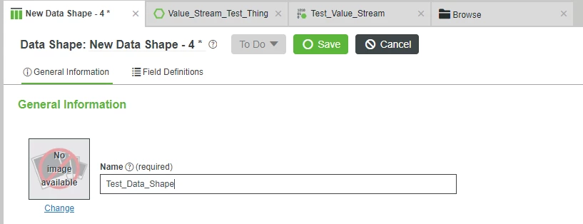

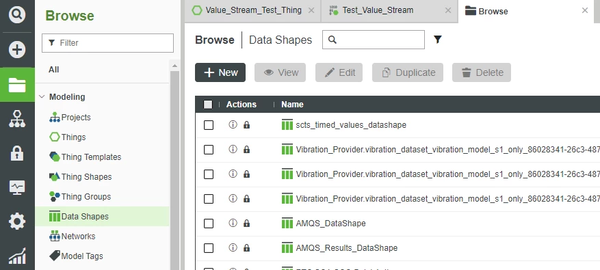

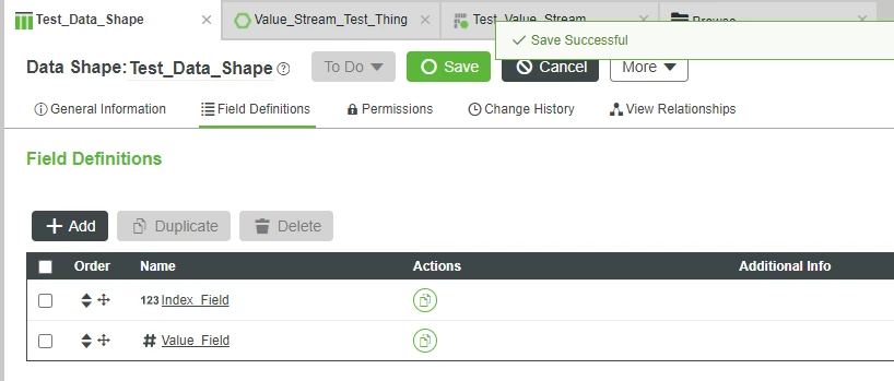

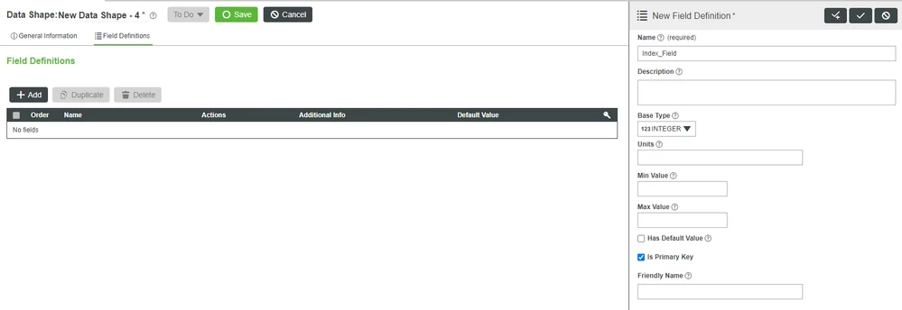

Create Data Shape
  1. On the ThingWorx Composer Browse tab, click Modeling -> Data Shapes, + New.
  2. In the Name field, enter Test_Data_Shape.
  3. If Project is not already set, search for and select PTCDefaultProject

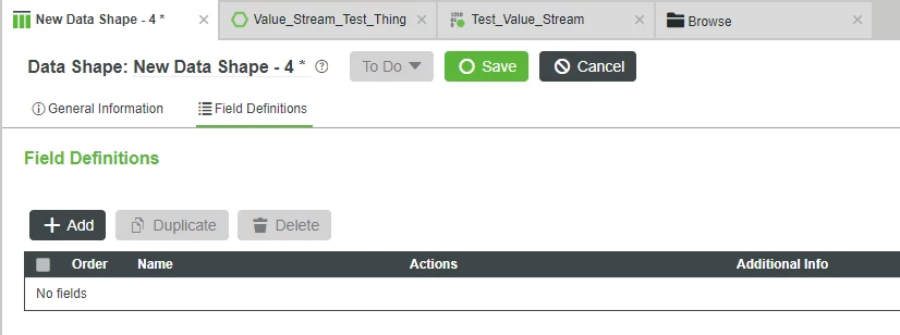

  4. At the top, click Field Definitions.

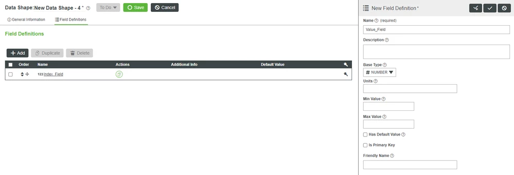

  5. Click + Add.
  6. On the right in the Name field, enter Index_Field
  7. Change the Base Type to INTEGER.
  8. Check the Is Primary Key checkbox.
    • All Data Shapes must have a Primary Key, and Index_Field is an appropriate choice, as it will keep track of the number of entries.
  9. At the top-right, click the "Check with a +" button for Done and Add.
  10. In the Name field, enter Value_Field.
  11. Change the Base Type to NUMBER.
  12. At the top-right, click the "Check" button for Done.
  13. At the top, click Save.

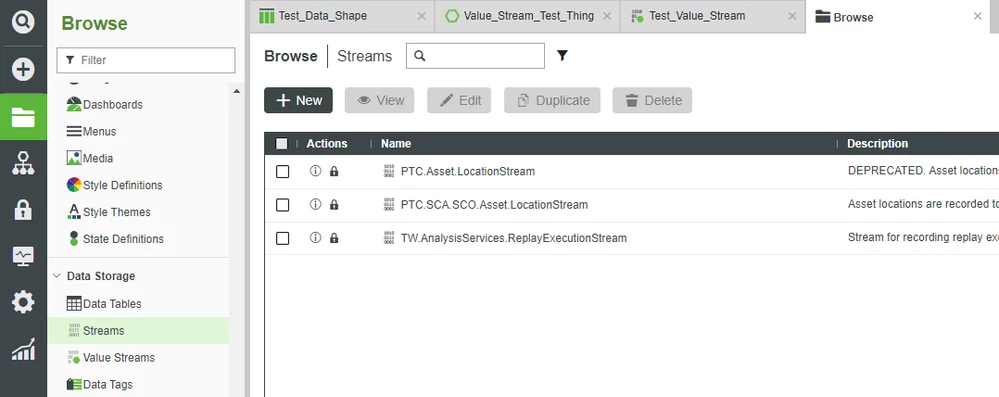

Create Stream
Streams are a mass data storage option optimized for Time-Series data.
They are utilized in much the same way as Value Streams, but possess additional functionality.
For one, Streams do not have to be tied to Things in the way that Value Streams are. They can be entirely independent, or even accept inputs from multiple different Things.
This can be useful when you want to have a master list of what every similar Thing was doing at particular points throughout some timeframe.

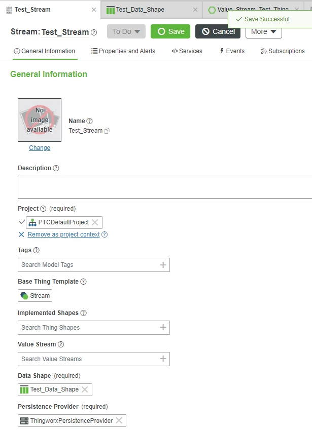

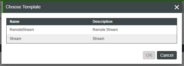

  1. On the ThingWorx Composer Browse tab, click DATA STORAGE -> Streams, + New.
  2. On the Choose Template pop-up, select Stream and click OK.

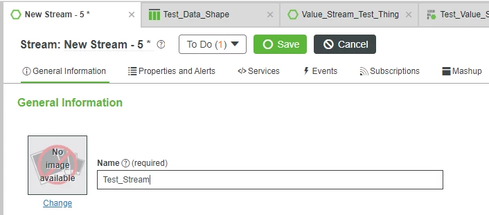

  3. In the Name field, enter Test_Stream.
  4. If Project is not already set, search for and select PTCDefaultProject.
  5. In the Data Shape field, search for and select Test_Data_Shape.
  6. At the top, click Save.

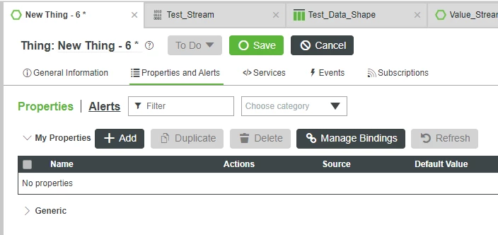

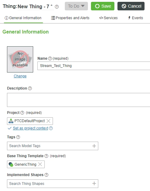

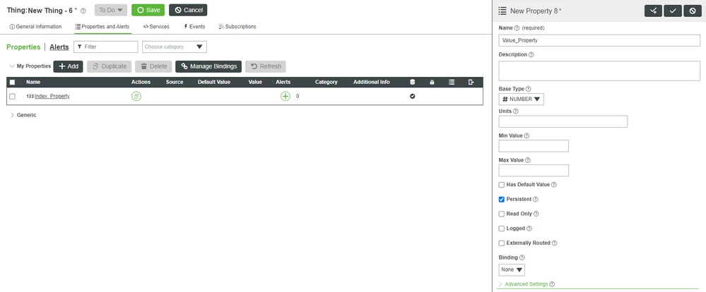

Create Thing
Now that the Stream is created, you'll create a Thing from which you can log some Properties.

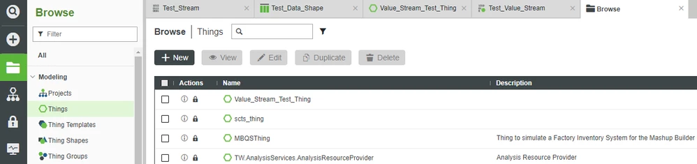

  1. On the ThingWorx Composer Browse tab, click MODELING -> Things, + New.
  2. In the Name field, enter Stream_Test_Thing.
  3. If Project is not already set, search for and select PTCDefaultProject.
  4. In the Thing Template field, search for and select GenericThing.

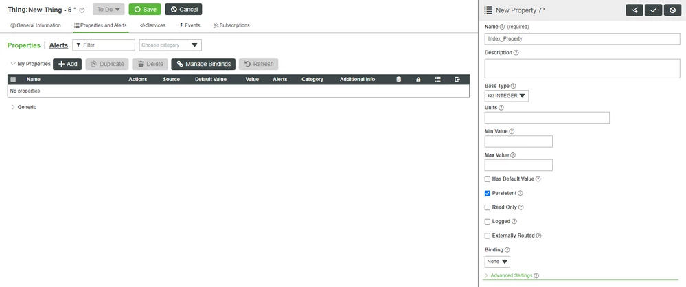

  5. At the top, click Properties and Alerts.
  6. Click + Add.
  7. In the Name field, enter Index_Property.
  8. Change the Base Type to Integer.
  9. Check the Persistent checkbox.
  10. At the top-right, click the "Check with a +" button for Done and Add.
  11. In the Name field, enter Value_Property.
  12. Change the Base Type to Number.
  13. Check the Persistent checkbox.
  14. At the top-right, click the "Check" button for Done.

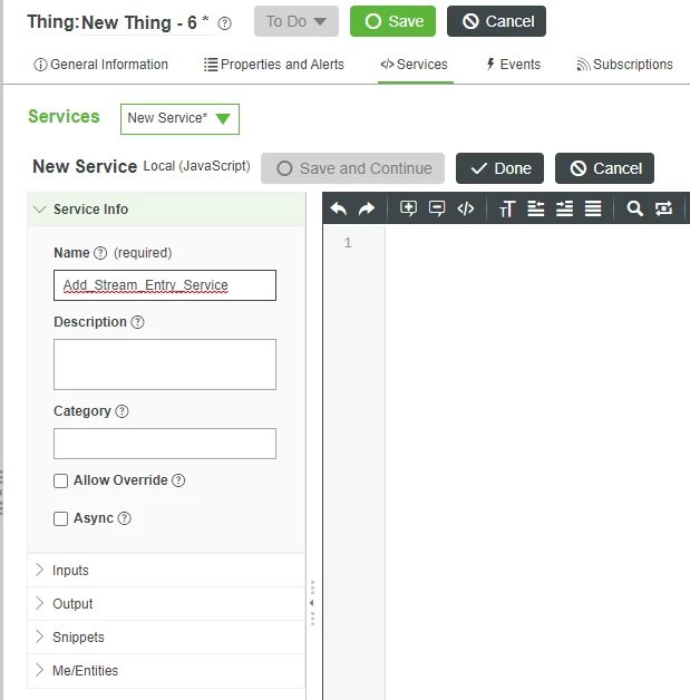

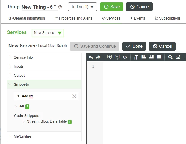

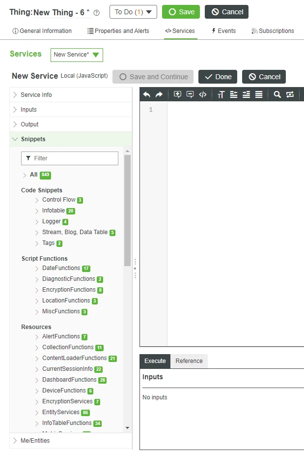

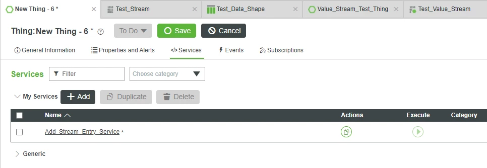

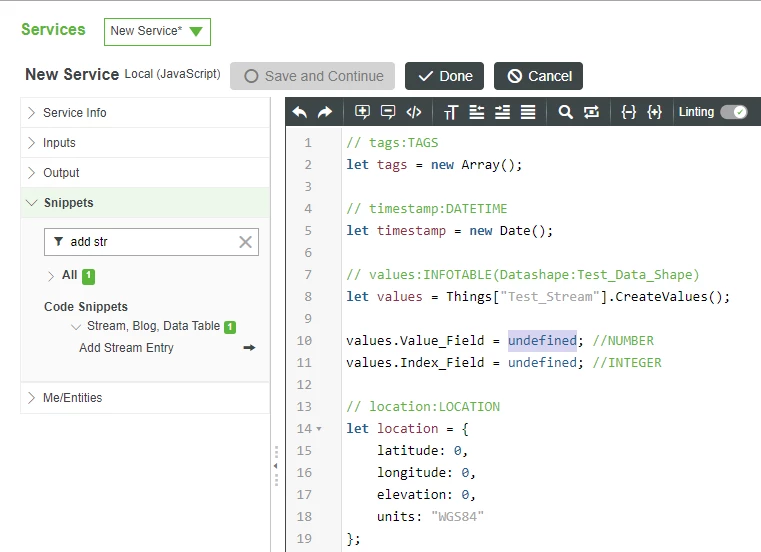

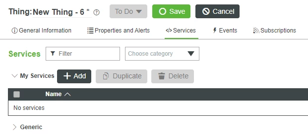

Add Service
Since you now have both a Thing and a Stream, we can write a Service which logs the Properties' values when the Service is executed.
  1. At the top, click Services.
  2. At the top, click + Add.
  3. In the Name field, enter Add_Stream_Entry_Service.

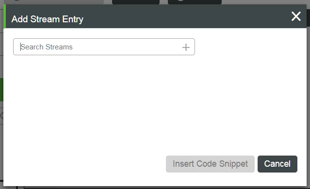

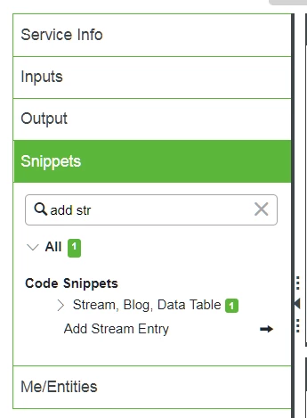

  4. On the left under New Service, click the Snippets tab.
  5. In the Filter field, type add str.

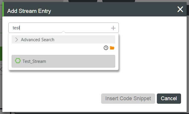

  6. Expand the Stream, Blog, Data Table section to reveal the Add Stream Entry Snippet.
  7. Click the right arrow beside Add Stream Entry.

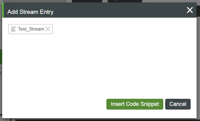

    • An Add Stream Entry pop-up will open.
  8. In the Search Streams field, enter test.
  9. Select Test_Stream.
  10. Click the Insert Code Snippet button.

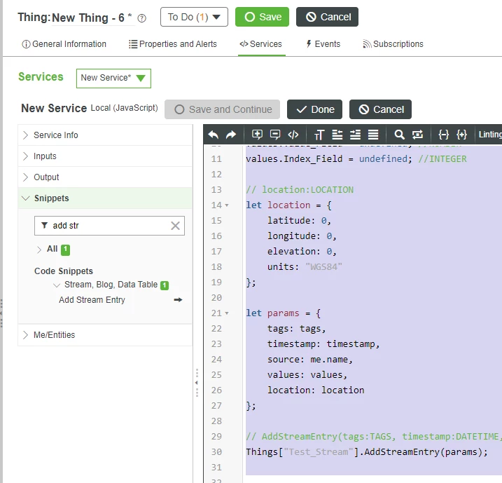

    • Note that a section of Javascript code has now been added to the Script window.

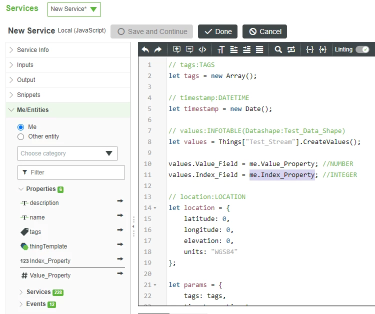

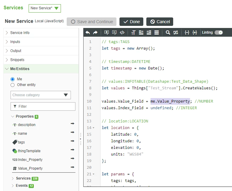

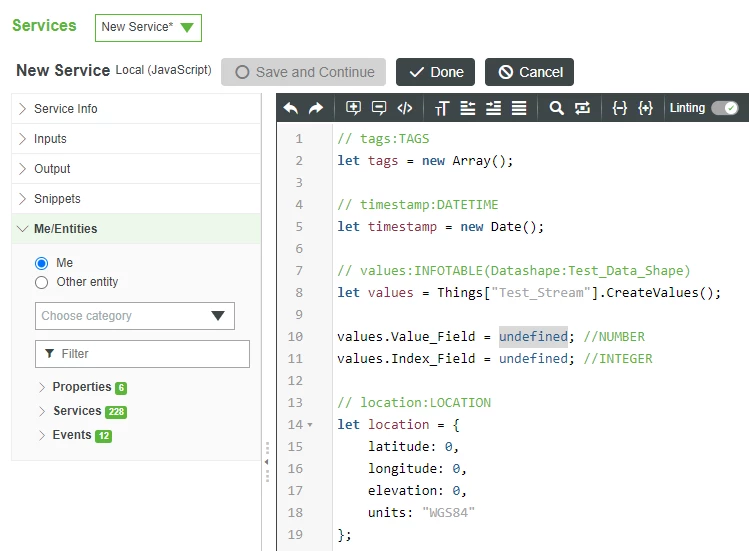

Modify Snippet
The inserted Javascript Snippet has already done most of the work of creating a custom Service for us.
All which you need to do now is modify the code Snippet to store the particular Property values from your Thing.
  1. On the 10th line of code, double-click undefined to select it.
  2. On the left, click the Me/Entities tab.
  3. Under the Me/Entities tab, expand Properties.
    • Note that this is not the Properties and Alerts at the top of Composer.
  4. Click the right arrow beside Value_Property.
    • Note that undefined has been replaced by me.Value_Property.
  5. On the 11th line of code, double-click the remaining undefined to select it.
  6. Click the right arrow beside Index_Property.
    • Note that the second “undefined” has been replaced by “me.Index_Property”.
  7. At the top, click Done to close the Add_Stream_Entry_Service editing window.
  8. At the top, click Save.
