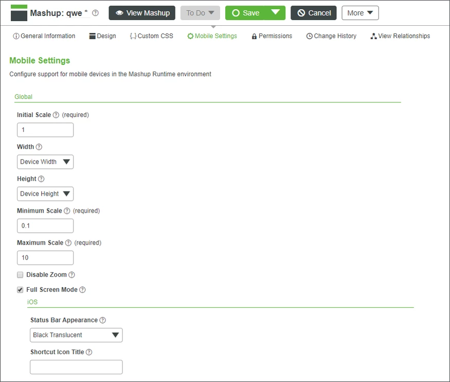

Starting ThingWorx 9.0 mobile headers configuration is natively supported through Mobile Settings tab (see attached screenshot for guidance)
The MobileHeader Extension is no longer required !!
