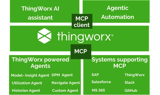

ThingWorx 10.1 takes a major step toward intelligent interoperability by introducing the Model Context Protocol (MCP) in Public Preview. As industries accelerate their use of AI-assisted operations, MCP provides a standardized way for AI agents to securely connect with real-world industrial data and perform actions across systems.
Our key goal is enabling agent-driven automation along with intelligent interoperability. MCP allows AI models and agents to interact with external systems such as ERP, MES, CRM, and analytics platforms in a structured and secure way. It removes the need for custom connectors and integrations, enabling developers to use a single, open standard to bridge AI and operational data. In essence, MCP allows AI to work natively with ThingWorx services and data models.
ThingWorx and MCP
Low-Code Enablement for Agentic Automation

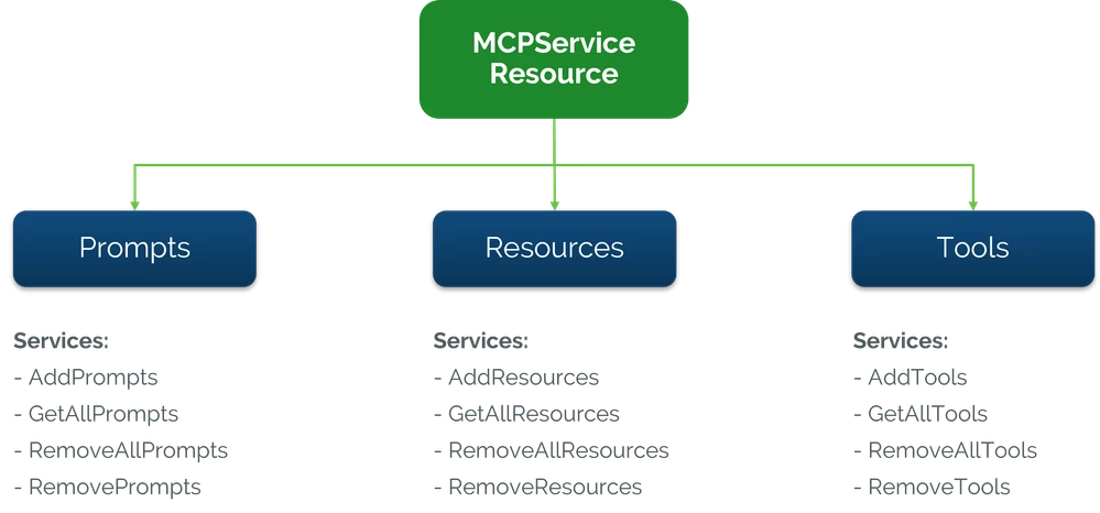

ThingWorx now embeds an MCP Server directly into the platform. This means that your existing ThingWorx services can be instantly made “AI-ready” without the need for external deployments. Through a simple low-code interface called MCPServices, users can define, manage, and expose three core MCP entities — Tools, Resources, and Prompts — that form the building blocks of contextual AI workflows.
MCP Services
Tools represent actions or functions AI can call (such as retrieving machine KPIs), Resources represent contextual data the AI can reference, and Prompts are reusable templates that guide AI on how to interact with them. This model creates a foundation for secure, context-aware automation that can be reused across multiple agents and applications.
Secure by Design, Open by Standard
MCP in ThingWorx follows industry-standard security protocols by introducing OAuth-protected metadata endpoints, compliant with RFC 9728. These endpoints let clients authenticate and discover the resources they’re authorized to use — ensuring data access remains secure while supporting open interoperability.
This aligns with ThingWorx’s broader goal: creating an ecosystem where AI agents can safely access contextualized industrial data across systems. Whether connecting to SAP, Salesforce, or another MCP-compatible server, your ThingWorx instance can now participate in a larger agentic ecosystem.

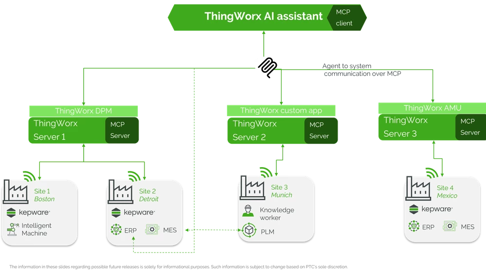

For instance, you may have ThingWorx Server 1 supporting factory sites in the USA, another in Germany, and a third in Mexico. These local ThingWorx deployments, powered by MCP capabilities, can expose rich contextualized data for agentic automation.
MCP clients could then be used to perform enterprise-wide KPI calculations to benchmark performance across factory sites over standard metrics such as OEE.
As local systems (ERP, MES, or factory systems) adopt MCP, ThingWorx MCP clients can directly access their data, enabling seamless integration without building custom REST connectors — saving significant development effort in API integration and data mapping.
