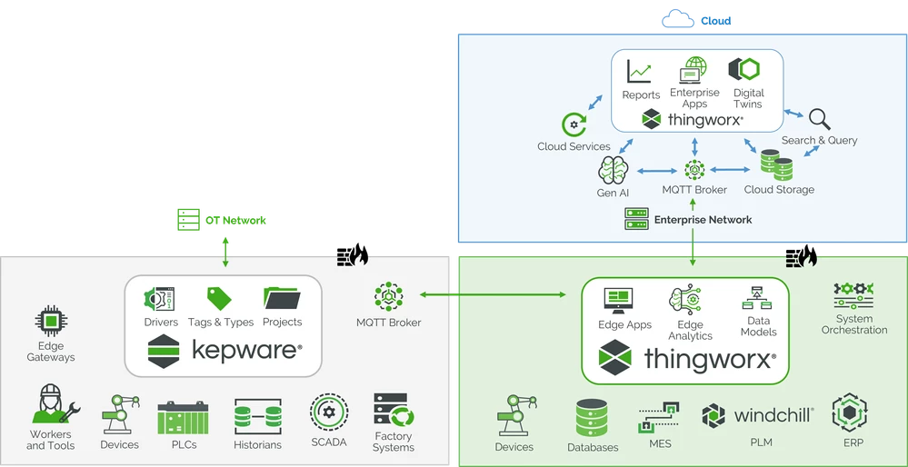

Introduction
With ThingWorx 10.1, we're excited to announce MQTT support for IoT streams for data egress as Private Preview. This is a significant value add that allows ThingWorx to continue to be used as a DataOps layer for end-to-end industrial data management. With its ability to ingest data from disparate sources, contextualize and transform it, and send data in a custom-defined format over Kafka, and now MQTT, ThingWorx enables real-time consumption of data by end applications, allowing necessary interoperability without the worry of data lock-in.
Especially in the age of AI, customers can use ThingWorx not only to ingest data from connected machines, systems, and people but also to push processed, contextualized, AI-ready data outward. This enables external systems, data lakes, cloud systems, or UNS layers to consume the data in real time, making IT/OT convergence seamless.
With this capability, having a Sparkplug B connector built in, users can use ThingWorx to directly load contextualized data onto MQTT brokers that is transformed into Sparkplug B format, helping them achieve their goals for establishing a decoupled, modular, and modern manufacturing architecture allowing complete access and traceability of their own data.
Modern Manufacturing ArchitectureModern Manufacturing Architecture
