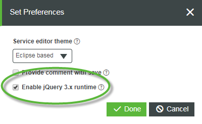

We are releasing this functionality in 8.2 as an early preview and to enable regression testing of your ThingWorx applications.  In the Next Gen Composer, simply click on User Preferences and look for this setting:
Enabling jQuery3 runtime

March 22, 2019
Where is this functionality in Thingworx 8.4???
March 22, 2019
Jquery 3 is the only library included now.  You no longer have a choice to toggle between Jquery versions.
