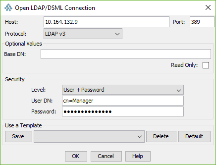

Load the .ldif
- Use e.g. JXplorer and connect
- Select the opendj node
- LDIF > Import File (my demo breakingbad.ldif is attached to this post)
- Skip any warnings and messages and continue to import the file

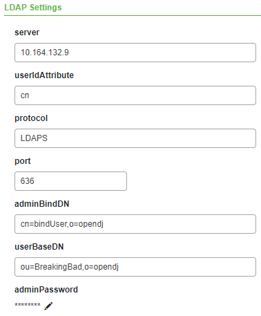

ThingWorx Composer
- As the IP address is used (the hostname is not mapped in Docker container) the certificate must have a SAN containing the IP address
- Only works with the TWLDAPExample Directory Service not the ADDS1, because ADDS1 uses hard coded Active Directory queries and structures and therefore does not work with OpenDJ.
- User ID (cn) must be pre-created in ThingWorx, so the user can login. There is no automatic user creation by the Directory Service.
- Make sure the Thing is Enabled under General Information
