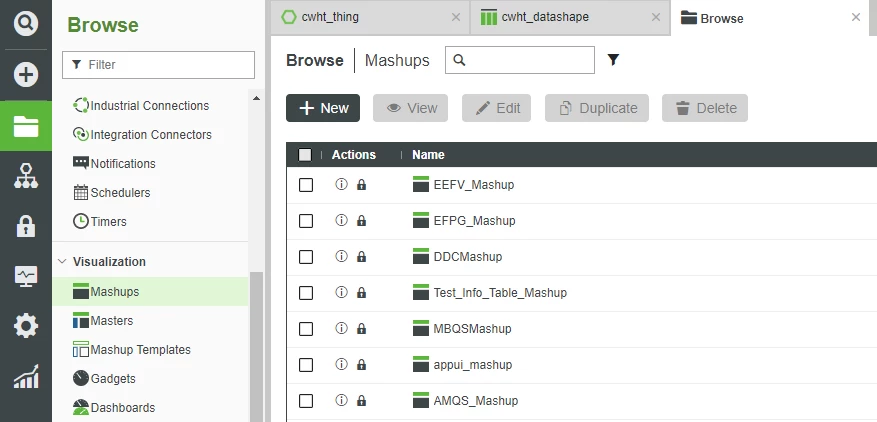

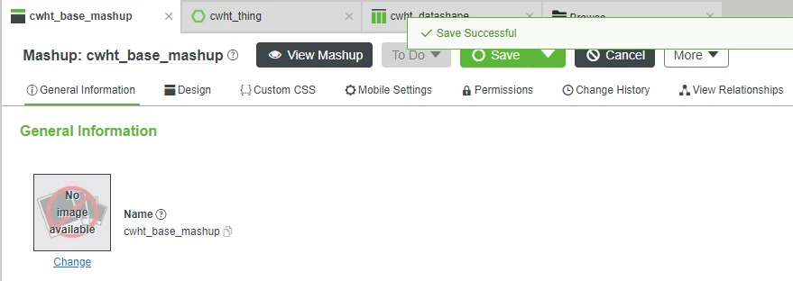

  1. On the ThingWorx Composer Browse tab, click Visualization > Mashups, + New

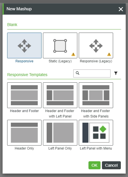

   2. Keep the default ofResponsive(without selecting any Templates), and click OK
   3. In the Name field, enter cwht_base_mashup.
   4. If Project is not already set, search for and select PTCDefaultProject.
   5. Click Save.

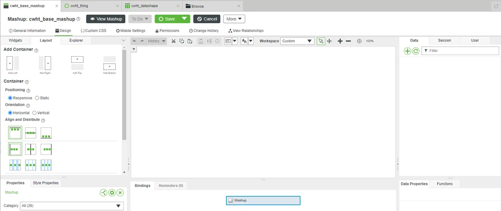

  1. At the top, click Design.
TIP: You can click the left arrow on the divider between the Browse left-navigation and the Mashup Builder to minimize the navigation and provide more room for the Mashup Builder itself.

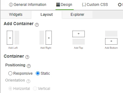

     2.  On the Layout tab at the top-left, select Positioning > Static.
You generally want the base Mashup to be "Static" so that you know the size of the cells which  the Collection Widget will replicate.

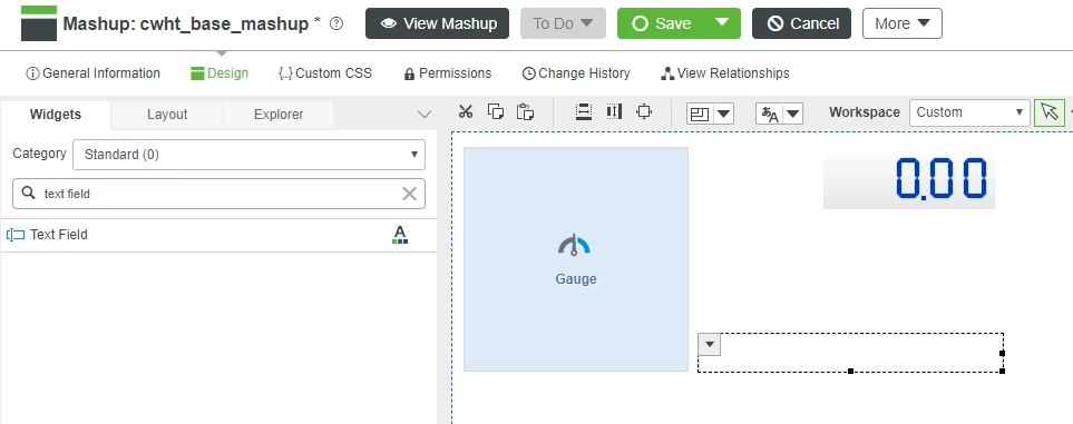

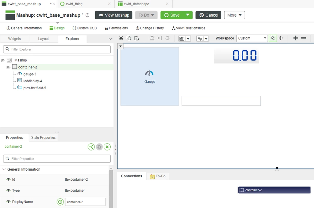

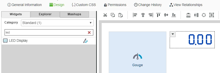

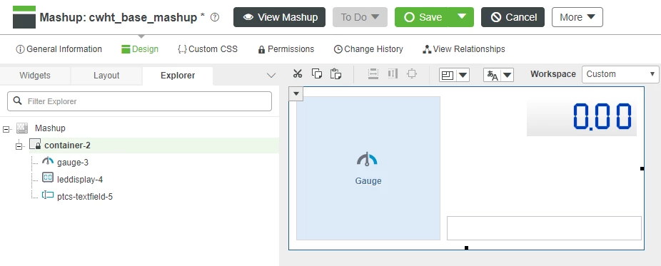

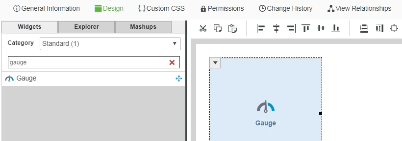

     3. From the top-left Widgets tab, drag-and-drop a Gauge Widget onto the central Canvas area.
     4. Drag-and-drop an LED Display Widget onto the central Canvas area.
    5. Drag-and-drop a Text Field Widget onto the central Canvas area
Reduce the Mashup Size

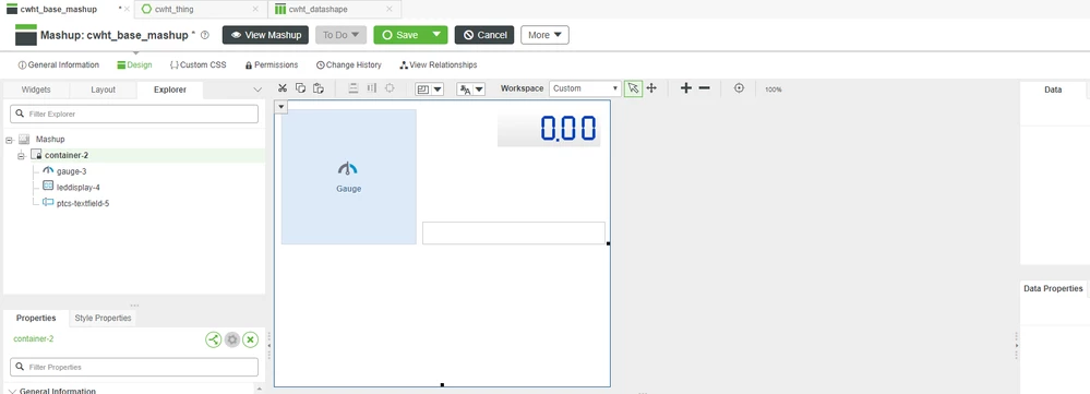

  1. At the top-left on the Explorer tab, select the Container.
      2. In the central Canvas area, click-and-drag the far-right side of the container to reduce its horizontal size
     3. Click-and-drag the bottom of the container to reduce its vertical size

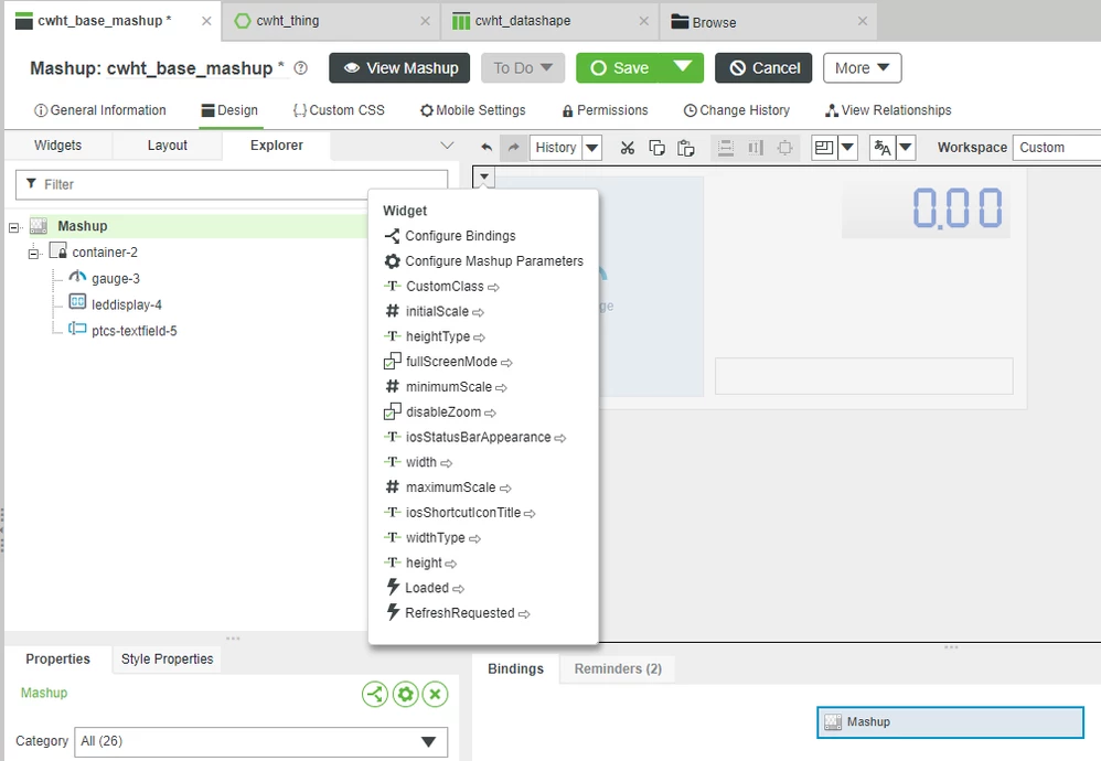

  1. On the top-left Explorer tab, select the Mashup itself.
    • A drop-down menu indicator will appear in the top-left of the Mashup.

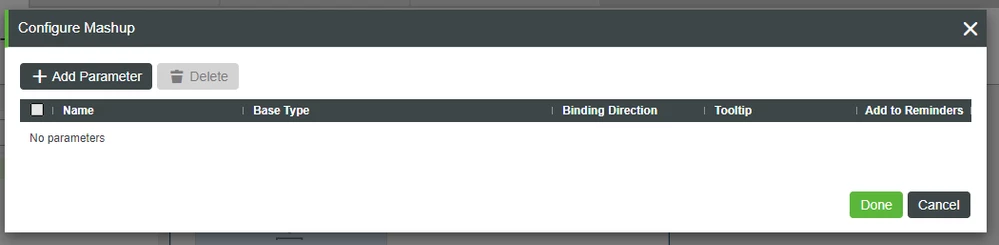

      2. Click the top-left drop-down menu to reveal the Mashup options

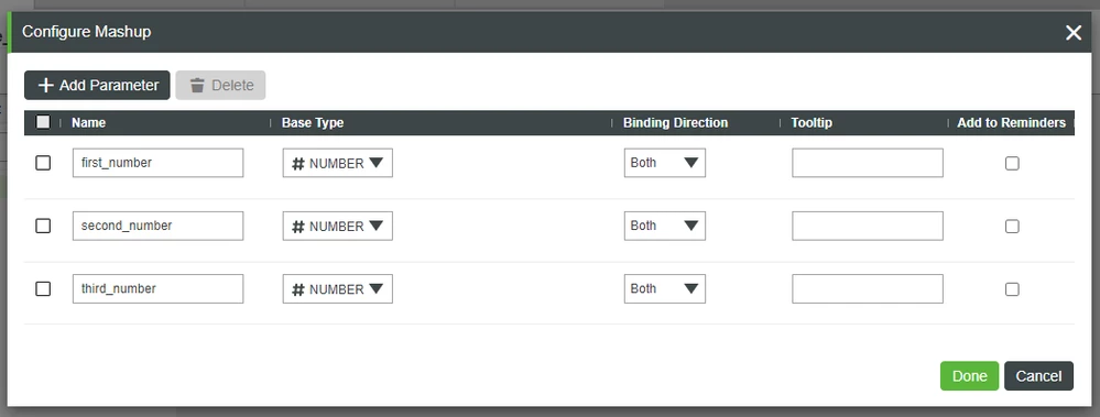

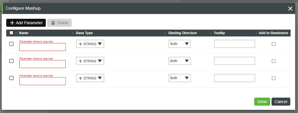

     3. Select Configure Mashup Parameters to open the Configure Mashup pop-up menu
    4. Click Add Parameter three times
      5. For the Name fields, enter first_number, second_number, and third_number.
      6. Change the Base Type to NUMBER for all three Parameters
    7. Click Done to close the Configure Mashup pop-up menu

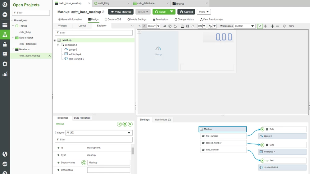

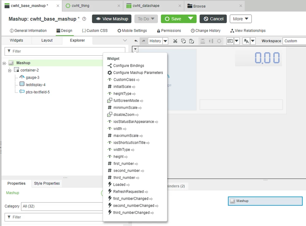

  1. Click the Mashup's drop-down menu in the top-left to expose the options again.
    • There are now additional options for first_number, second_number, and third_number.

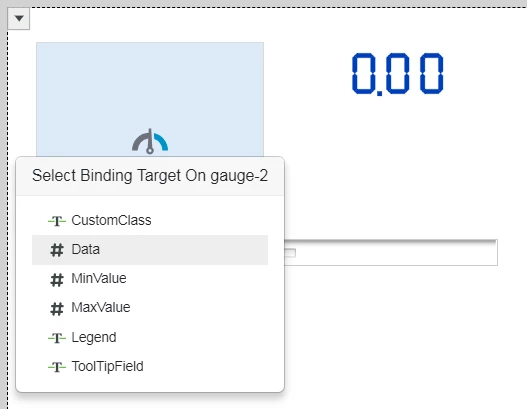

     2. Drag-and-drop first_number onto the Gauge Widget
      3. Select Data on the Select Binding Target pop-up menu of the Gauge Widget.
      4. Drag-and-drop second_number onto the LED Display Widget.
  • You may have to first reselect the Mashup itself to reveal the Mashup's drop-down menu to access the second_number Mashup Parameter.
  • Remember that you can easily select the Mashup itself through the Explorer tab.
      5. Select Data on the Select Binding Target pop-up menu of the LED Display Widget.
      6. Drag-and-drop third_number onto the Text Field Widget.
      7. Select Text on the Select Binding Target pop-up menu of the Text Field Widget.

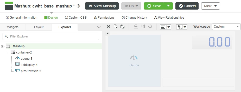

      8. At the top, click Save.
  • You can expand the Connections window at the bottom and select the Mashup itself to confirm that all three Mashup Parameters have been correctly bound to each Widget.
