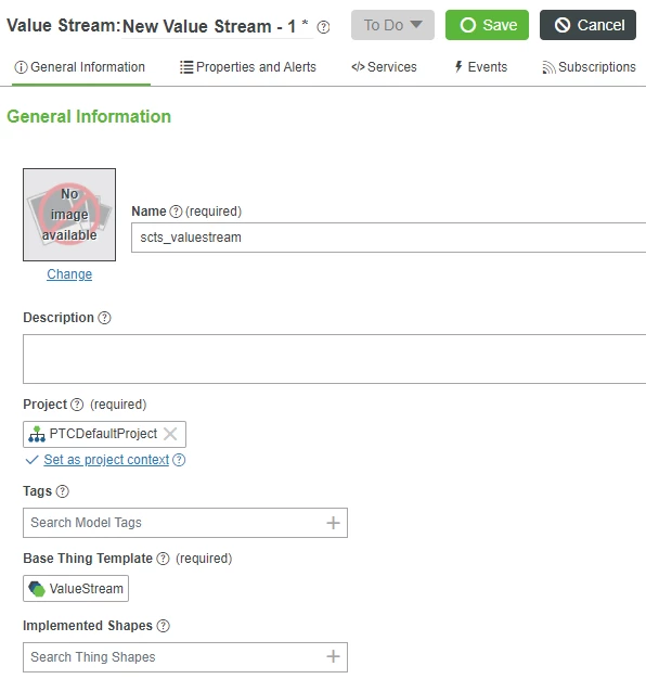

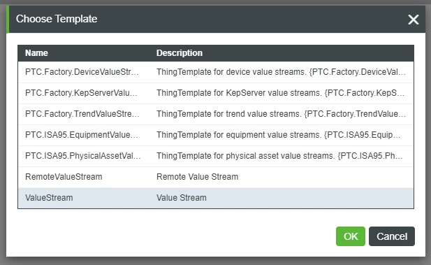

Create Value Stream
Follow the steps below to create a Value Stream that you will later tie to a Thing.

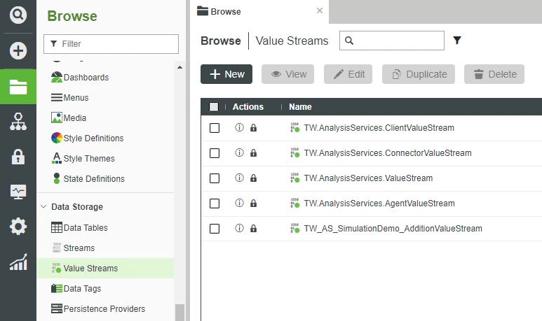

  1. On the ThingWorx Composer Browse tab, click DATA STORAGE > Value Streams, + New.
  2. Select ValueStream and click OK.

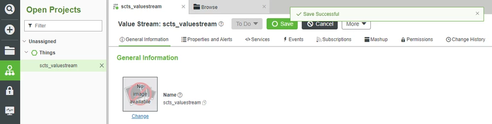

  3. In the Name field, enter scts_valuestream.
  4. If Project is not already set, search for and select PTCDefaultProject.
  5. At the top, click Save.

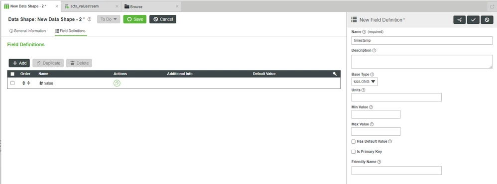

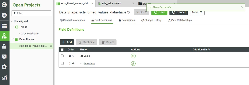

Create Data Shape
You will need a Data Shape to format the timed_values Property we will create in the next step.

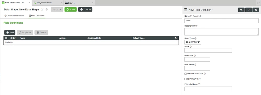

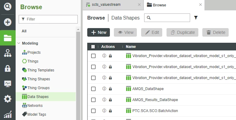

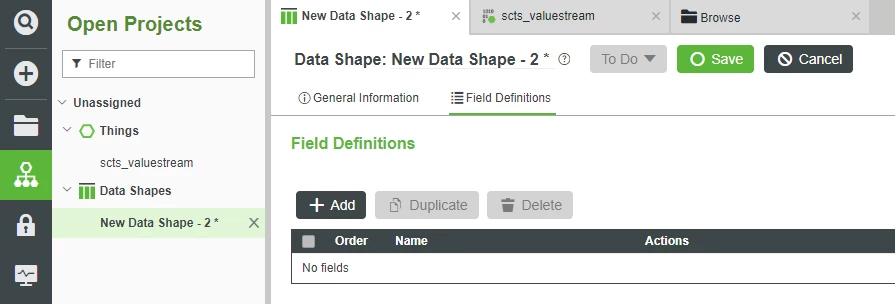

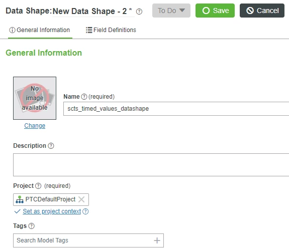

  1. On the ThingWorx Composer Browse tab, click MODELING > Data Shapes, + New.
  2. In the Name field, enter scts_timed_values_datashape.
  3. If Project is not already set, search for and select PTCDefaultProject.
  4. At the top, click Field Definitions.
  5. Click + Add.
  6. On the right slide-out, in the Name field, enter value.
  7. Change the Base Type to NUMBER.
  8. At the top-right, click the "check with a +" icon for Done and Add.
  9. In the Name field, enter timestamp.
  10. Change the Base Type to LONG.
  11. At the top-right, click the "check" icon for Done.
  12. At the top, click Save.

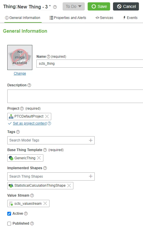

Step 3: Create Thing
Next, you will create a Thing and tie the previously-created Value Stream to it.
You will assign the Statistical Calculation Thing Shape to get a variety of built-in analytics Services to manipulate the data. You will also create a series of Properties to facilitate the new Services.

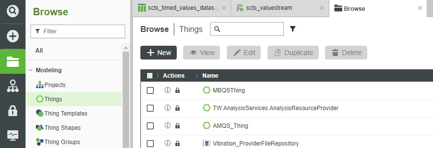

  1. On the ThingWorx Composer Browse tab, click MODELING > Things, + New.
  2. In the Name field, enter scts_thing.
  4. In the Base Thing Template field, search for and select GenericThing.
  5. In the Implemented Shapes field, search for and select StatisticalCalculationThingShape.
  6. In the Value Stream field, search for and select scts_valuestream.
  7. At the top, click Save.

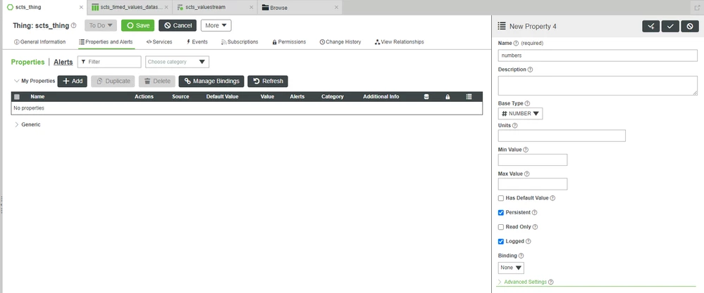

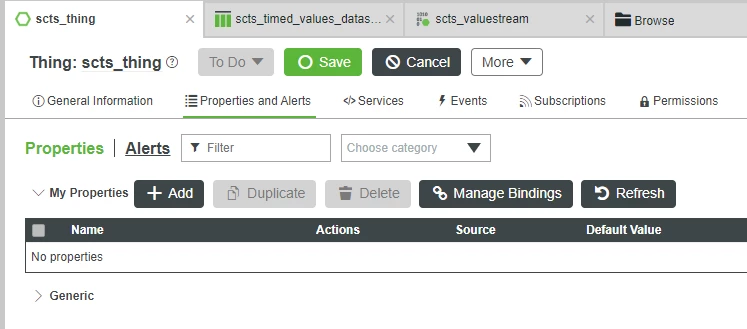

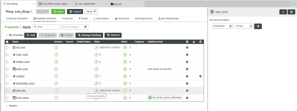

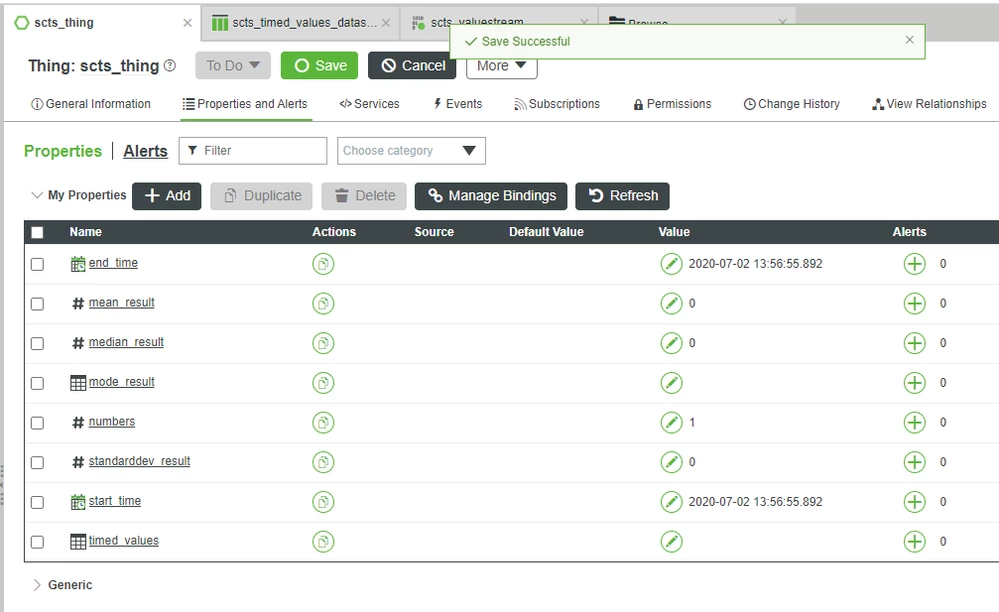

Add Properties
Next, you will add a series of Properties to scts_thing.
Perform the following steps repeatedly until all Properties have been added.

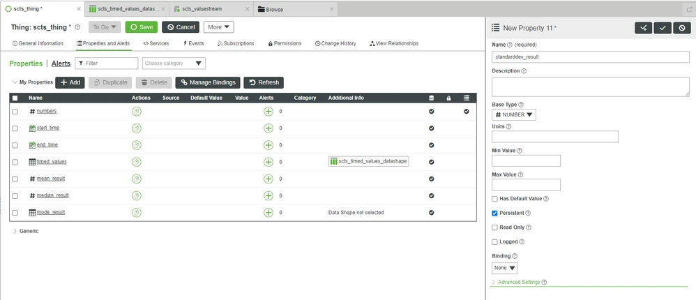

    1. At the top, click Properties and Alerts.
    2. Click + Add.
    3. On the right slide-out, in the Name field, enter numbers.
    4. Change the Base Type to NUMBER.
    5. Click Persistent.
    6. Click Logged.
    7. At the top-right, click the "check with a +" icon for Done and Add.

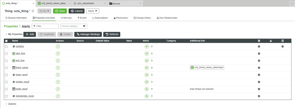

    8. Repeat steps 3-7 until all of the properties in the table below have been added.
      • NOTE: For the final standarddev_result Property, do NOT click Done and Add; you'll just click the check for Done instead.
        Property Name Base TypeData Shape Persistent  Logged
        start_timeDATETIMEN/ACheckedNOT checked
        end_timeDATETIMEN/ACheckedNOT checked
        timed_valuesINFOTABLEscts_timed_values_datashapeCheckedNOT checked
        mean_resultNUMBERN/ACheckedNOT checked
        median_resultNUMBERN/ACheckedNOT checked
        mode_resultINFOTABLEnone, i.e. leave it blankCheckedNOT checked
        standarddev_resultNUMBERN/ACheckedNOT checked
    9. At the top-right, click the "check" icon for DONE.
    10. At the top, click Save.

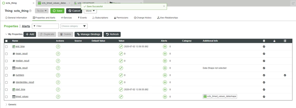

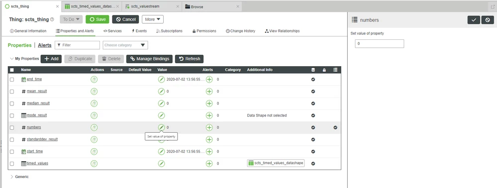

Set numbers
  1. Under the Value column and on the numbers property row, click the "pencil" icon for Set value of property.
  2. On the right slide-out, enter 1.
  3. At the top-right, click the "check" icon for Done.
  4. At the top, click Save.
  5. Repeat steps 1-4 above, changing the value each time according to the table below:
    Value Change Count Entered Value
    2nd5
    3rd9
    4th5
    5th9
    6th1
    7th9

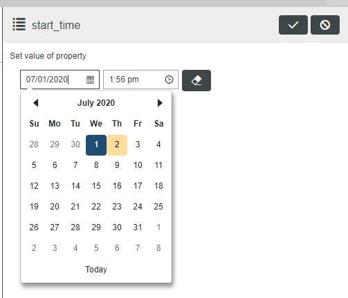

You also need to set the start_time and end_time. These are dates used to define the time-period in which the Statistical Calculation Thing Shape will search for values.
For instance, you could set the calculations to run at midnight, and then use the past 24-hours as your time-period.
For this example, set dates to be 24 hours prior to the time at which you set the above values of the numbers property, through 24 hours in the future.
Set start_time
  1. Under the Value column and on the start_time Property row, click the "pencil" icon for Set value of property.
  2. On the right slide-out, search for and select the previous day.

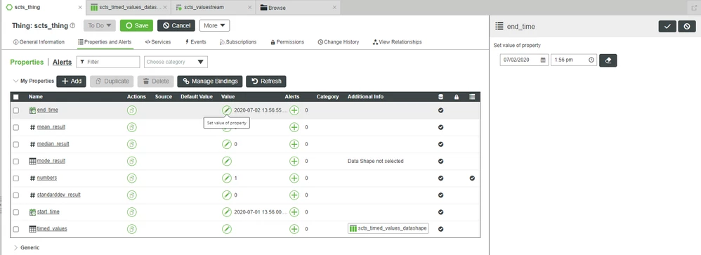

Set end_time
  1. Under the Value column and on the end_time property row, click the "pencil" icon for Set value of property.
  2. On the right slide-out, search for and select the following day.
