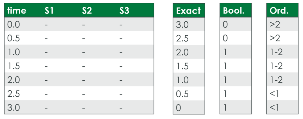

There are several ways to conceive the TTF, for example:
  • Exact time value when failure might occur
    • This is probably going to be the most challenging to predict
    • However one should consider if it is really necessary. Indeed do we need to know that a failure might occur in 12 min as opposed to 14 min ? Very often knowing that the time to failures is less than X min, is what is important, not the exact time.
      So the following options are often more appropriate.
  • Threshold
    • For some application knowing that a critical threshold is reached is all that is needed.
    • In this case a Boolean goal, for example lessThan30min or healthy with yes/no values, can be used
    • This is usually much easier than the exact value above.
  • Range
    • For other applications we may need to have a bit more insight and try to predict some ranges, for example: lessThan30min, 30to60min, 60to90min and moreThan90min
    • In this case we will define an ordinal goal
    • The caveat here is that currently ThingWorx Analytics Builder does not support ordinal goal, though ThingWorx Analytics Server does support it. So it only means that the model creation needs to be done through the API.
      This is the option we will take with the NASA dataset.
The picture below shows the 3 different types of TTF listed above

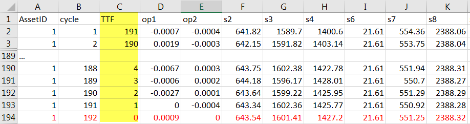

    • TTF feature
      Since we want to predict the time to failure, we do need a column in the dataset that represent this values for the data we have.
      In a real case scenario we obviously cannot measure the time to failure, but we usually have sensor data up to the point of failure, which we can use to derived the TTF values.
      This is what happens in the NASA dataset, the last cycle corresponds to the time when the failure occurred. We can therefore derive a new feature TTF in this dataset. This will start at 0 for the last cycle when failure occurred, and will be incremented by 1 up to the very first measurement, as shown below:

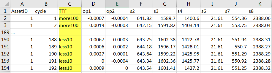

Once this TTF column is defined, we may need to transform it further depending on the path we choose for TTF prediction, as described in the TTF business need chapter.
In the case of the NASA dataset we are choosing a range TTF with values of more100, 50to100, 10to50 and less10 to represent the number of remaining cycles till the predicted failure.
This is the information we need to predict in order to plan a suitable maintenance action.
Our transformed TTF column look as below:

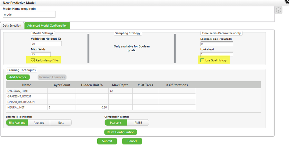

Important considerations:
  • When dealing with Time to failure prediction, it is usually needed to unset the Use Goal History in the Advanced parameters of the model creation wizard.
    If using API, the equivalent is to set the virtualSensor parameter to true.
  • Tests with Redundancy Filter enabled should be done as this has shown to give better results.
  • In a first attempt it is a good idea to keep lookback Size to 0. This indicates to ThingWorx Analytics to find the best lookback size between 2, 4, 8 and 16.
    If you need a different value or know that a different value is better suited, you can change this value accordingly. However bear in mind the following:

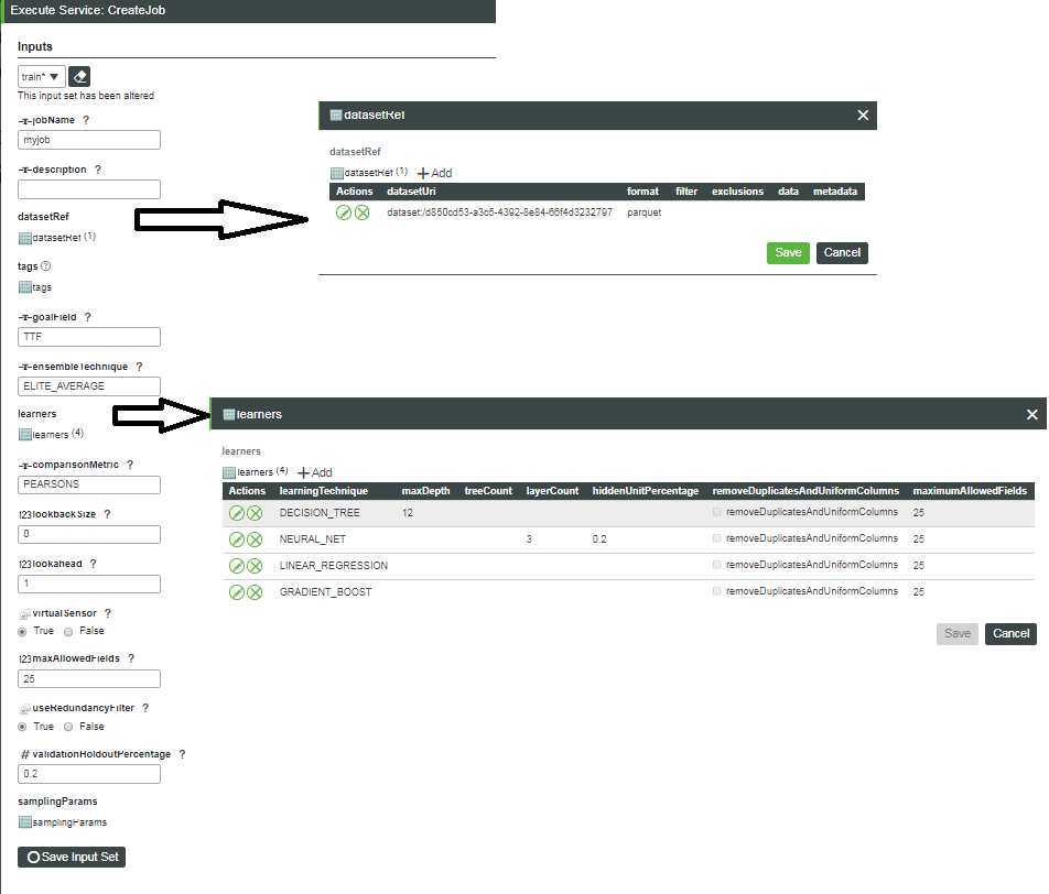

In the case of the NASA dataset, since we are using an ordinal goal, we need to execute it through API.
This can be done through mashup and services (see How to work with ordinal and categorical data in ThingWorx Analytics ? for an example) for a more productive way.
As a test the TrainingThing.CreateJob service can be called from the Composer directly, as shown below:

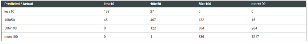

Once the model is created we can check some performance statistics in ThingWorx Analytics Builder or, in the case of ordinal goal, via the ValidationThing.RetrieveResults service. The parameter most relevant in the case of ordinal goal will be the confusion matrix.
Here is the confusion matrix I get

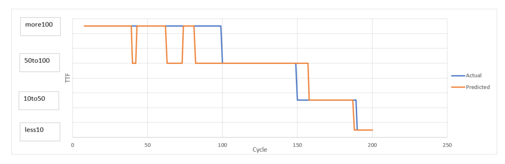

Another validation is to compute some PVA (Predicted Vs Actual) results for some validation data.
ThingWorx Analytics does validation automatically when using ThingWorx Analytics Builder and present some useful performance metrics and graph. In the case of ordinal goal, we can still get this automatic validation run (hence the above confusion matrix), but no PVA graph or data is available. This can be done manually if some data are kept aside and not passed to the training microservice. Once the model is completed, we can then score (using PredictionThing.RealTimeScore or BatchScore for ordinal goal, or Builder UI for other goal) this validation dataset and compare the prediction result with the actual value.
here is one example:
Depending on the business case this model can be deemed acceptable or may need rework, such as change the range values, change learners’ parameters, modify dataset …

Could you please help me to understand, how to create the graph shown below  (predicted vs actual for ordinal goals). I could not find suitable service to draw it. I see RetrieveResult from PredictionThing gives predicted values in infotable, but could not find any service for actual values in info table to compare with.image
Regards
Tushar
cmorfin19-TanzaniteAuthor
Jan 7, 2019 9:49 AM UTC
Hi @tushar
Thank you for your comment.
The PVA can be retrieved using the RetrievePVAs service of the ValidationThing. However this does not support categorical or ordinal goal, so if you are using a goal of this type there is no direct way.
I created the mentioned graph in a very manual way (there might be ways to automatized this but I did not investigate this as I just needed a quick graph for illustration purpose)
- I scored a validation set (for which I therefore knew the values for the goal)
- then compare the predicted value (result of the scoring job) with the actual value from the original validation set.
- the graph was simply created in Excel with the 2 series as input.
