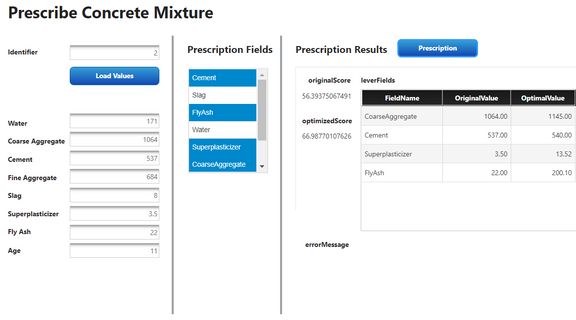

I have created a mashup which allows you to easily use and test the Prescriptions functionality in Thingworx Analytics (TWA). This is where you choose 1 or more fields for optimization, and TWA tells you how to adjust those fields to get an optimal outcome.
The functionality is based on a public sample dataset for concrete mixtures, full details are included in the attached documentation.

Hi, I think the Lever fields are important but the Id fields are probably not (you could test the results with excluding the Id fields, i.e. removing parameter identifierFields: idFields from the call to RealtimeScore).
The Lever fields are populated due to an infotable called leverSelection which is passed in as an input from the mashup when the service is called. These are the fields which the user has selected in the list using multi-select. So for example if you highlight fields Age and FineAggregate, then these become the levers and Thingworx Analytics (TWA) will optimise these values to maximise (as per the call to RealtimeScore) the goal field which is CompressiveStrength. TWA will return the optimal settings for Age and FineAggregate (in this example), which are displayed on the mashup. If I remember correctly, theoretically the values shown for Age and FineAggregate aren't necessarily the optimal values but in practise usually they should be.

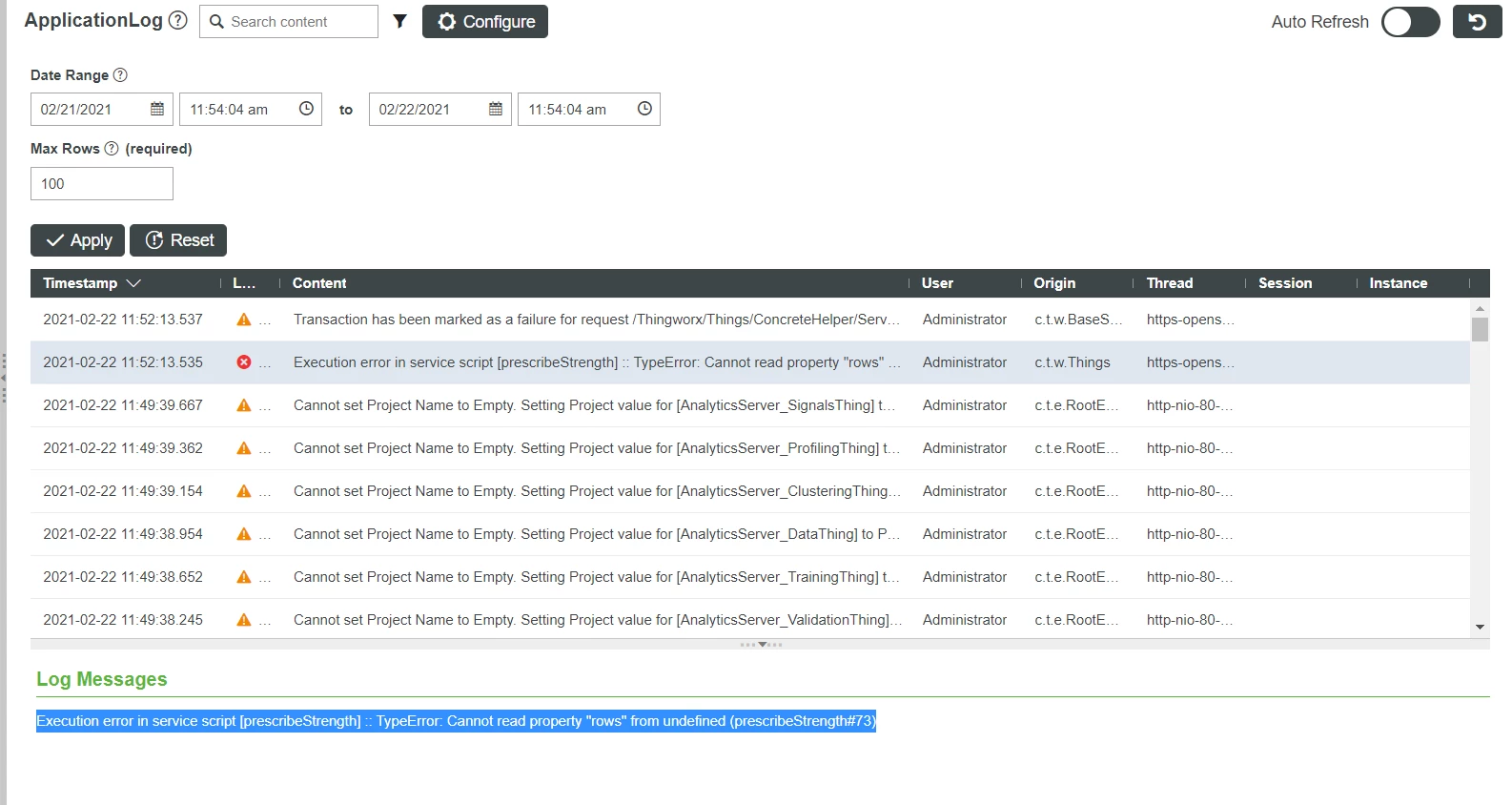

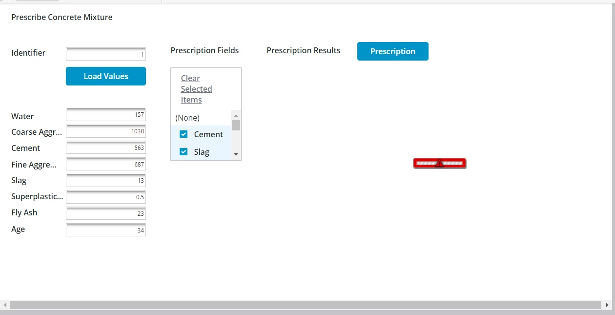

Feb 22, 2021 4:07 AM UTC
Hi tsaifee-2,
This is an excellent example for reference. I tried to port it into ThingWorx 9.1 but found errors. I believe I may need to revise the scripts in somewhere. Attached please find the syndromes.
Can you please help to check? Thanks!
Feb 22, 2021 4:23 AM UTC
Just make sure, you have "ServerName-AnalyticsServer_PrescriptiveThing" connected in your system or you don't have any other things created under "PrescriptiveMicroserver" template.
Regards
Shyam
Feb 22, 2021 8:02 AM UTC
Hi Shyam,
I simply followed the manual attached to the project and did not create any extra thing.
The project works well in ThingWorx 8.5.7 but does not in ThingWorx 9.0+. I am wondering whether anything has been changed in ThingWorx 9.1. Thanks.
